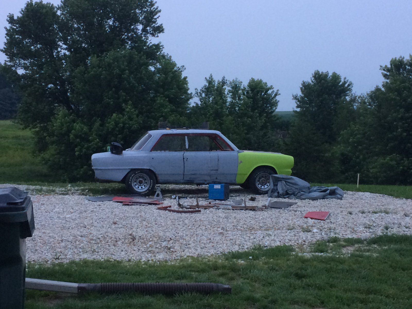

    So I've been working on the inside a bit more. Slow rolling with work and all. Both doors shut and latch now. Gotta cut some access holes tonight to get the latches working. I'm at peace with the windows being drag style. Got a big box of harbor freight stuff waiting for me at home! More pictures to come!

    So, I now have both of the rear windows in, and both of the latches working. Next up is to do the metal work on the passenger door, and then rework the drivers door. Moving along. So... my radiator has pin holes all over the place. I do believe that aluminum radiators are frowned upon here. This is the factory brass one, it may be a Blackstone i'm not sure. I want reliability with this one. I can and have soldered some of the pin holes up, but i'm worried about future leaks. There is a rad shop in town that is really good. Should i have them hot tank it? or should i just get an alum one and paint it black? Obvious Note: Stock or aftermarket has no bearing on my decision. I'm looking for the cheapest option besides stop leak. Also, beating the old engine WOT on gravel makes the old six run way hot even full of fluid. I.m sure the car wasn't built for this, but what are the options? How to decide?
  20. Lots of stuff is frowned upon here it just depends on which click is doing the frowning today. :( ;)
    Aluminum will fly in a car like yours well enough, painted is OK just don't get crazy with the paint and ruin your cooling. Also cheap alternative is a rad for an early mustang they run about 125 or so. Get a 3 or 4 core incase you decide to go V8 at a later date if you go that route. it should fit quite nicely in your car.
    I have run patched radiators a bunch in my life. If you can patch it yourself then you are golden as long as you are not starting with Swiss Cheese. I guess it is a judgment call on your part.
