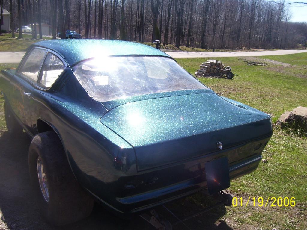

    been useing one for years and love it no more fish eys or moisture
      512.8 KB
      1,790
