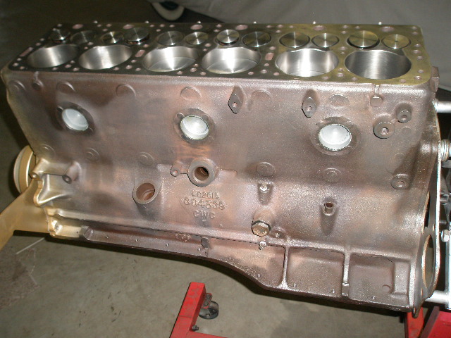

    guys, thanks for your patients about the pictures. I did get some today of a mild 308 Hornet rebuild we are doing right now along with some of the flywheels & clutches. I will be getting more for modifications when we start the next 308 or 262 but it may be a few weeks. Sorry about the delay on these.
    first two pictures show the left and right side of the 308 block. the rib located 2" above the oil pan rail is only used on 308 blocks. the 232 & 262 do not used this. if your Hudson engine has this reinforcement rib on both sides its a 308 block.
    the third pictures shows the crankshaft bolts used in all 1948 through 1954 Hudson big six engines. if you are building a performance engine using one of these early crankshafts remove the bolts, have a machine shop drill and tap these six holes to the next size bigger and use ARP flexplate bolts here instead of the stock bolts. Hudson's with this bolt and nut arrangement on the crankshaft have the habit of snapping the bolts & throwing the flywheel off and it takes most of the rear of the engine & trans with it in big sharp pieces.

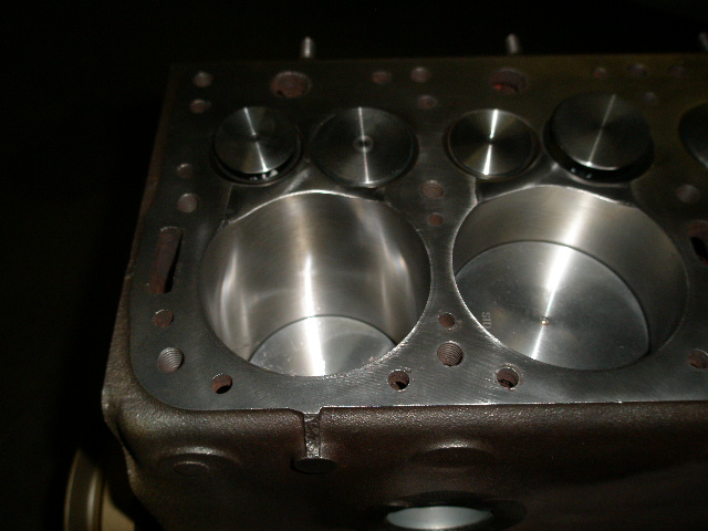

    the forth picture shows a 1954 308 block with a mild polish on the relief area. usually you would place a old head gasket on top of the block, scribe the outline for the valve chamber and relief area in the block and grind the entire area out at an angled depth of 3/16" at the cylinder then tapering up to .090" at the deck area behind the valves near the port side of the block. I will get good pictures of the 328 relief area in my engine once I get it appart and detail it out better. This mild polishing does help out but its no where as good as a full relief grind.

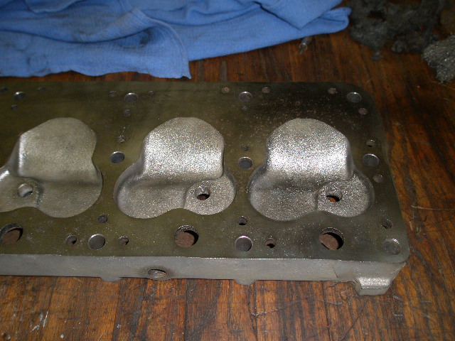

    the tenth picture is the chamber side of a 308 cast iron head showing the valve pocket, transfer slot and cylinder wedge. the 308 head offers the least flow resistance on a 308 engine but a lower compression ratio than using a 262 or 232 cylinder head. the major difference between all of them is the depth of the transfer slot (area above the relief in the block) and how far the cylinder wedge penetrates towards the center of the cylinder.
    Compression makes power on a flathead just like on a OHV engine BUT there is a major trade off in loss of air flow to support high RPM. In a Hudson flathead its kind of a mute point because the 308 is all done by 4800 RPM due to the 4.5" stroke. My point is that a 308 head works the best for air flow and does not impeed airflow at its max RPM of 4800 but you can make a little more power with a deeper relief cut in the block and a 262 cylinder head. using a 232 head on a 308 creates a detonation machine, not worth the compression gain and loss of airflow.

    Yes the High Nickel Hudson blocks all the way through 1956 was one tough old block to do any machining on. New tools can take it without much problem but die grinder tools have a severely limited life span.
    On the four holes shown in photos 6 & 7 these are not subjected to oil pressure as the cam bearings do block these holes. I filled mine up with the black Mopar ATF-RTV then installed the cam bearings. Just trying to keep the outside of the block clean as they were weeping a little oil after a hi-boost run.
