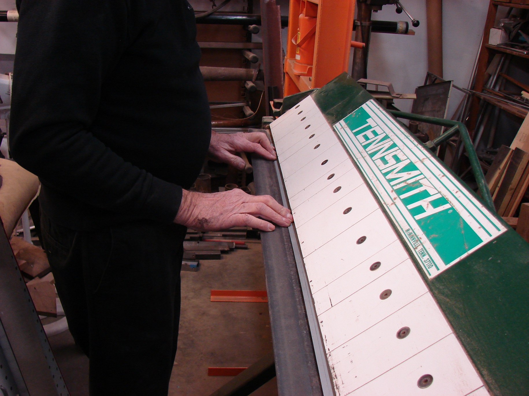

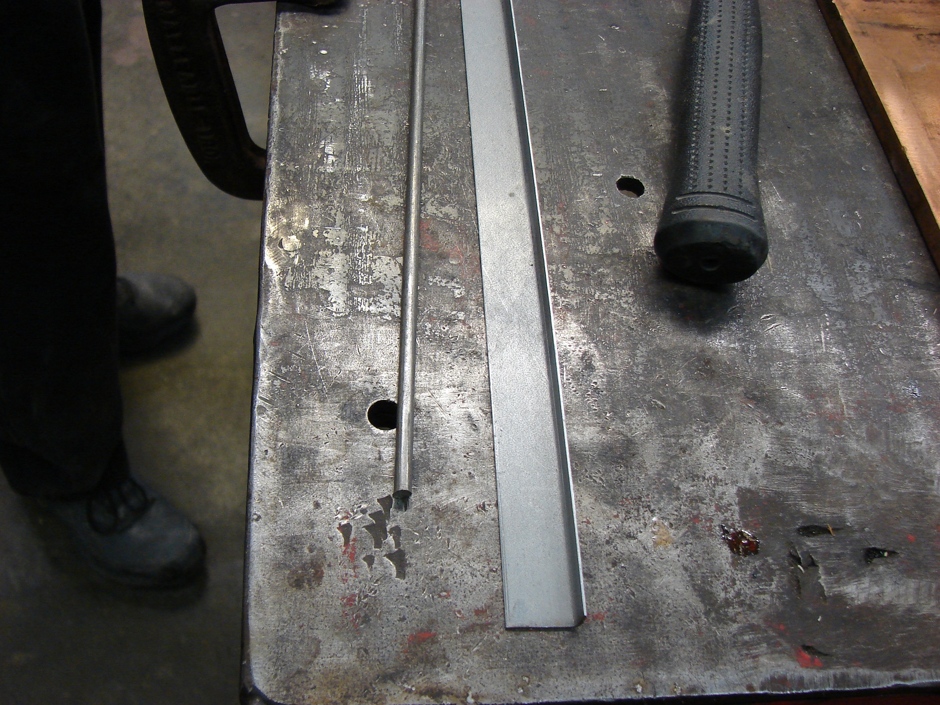

    Then we put it in the brake and bent a 90 degree bend 1/4" wide in the piece.

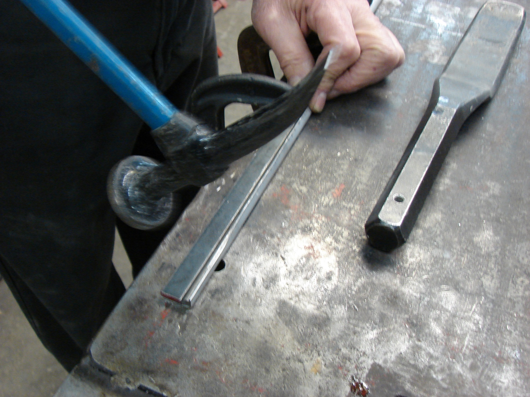

    We then put a 3/16" piece of round bar stock in the bend and used "C" clamps and a piece of flat bar to hold it in place.
    Drip Rails 014.JPG A body hammer was used to bend the lip over the bar.

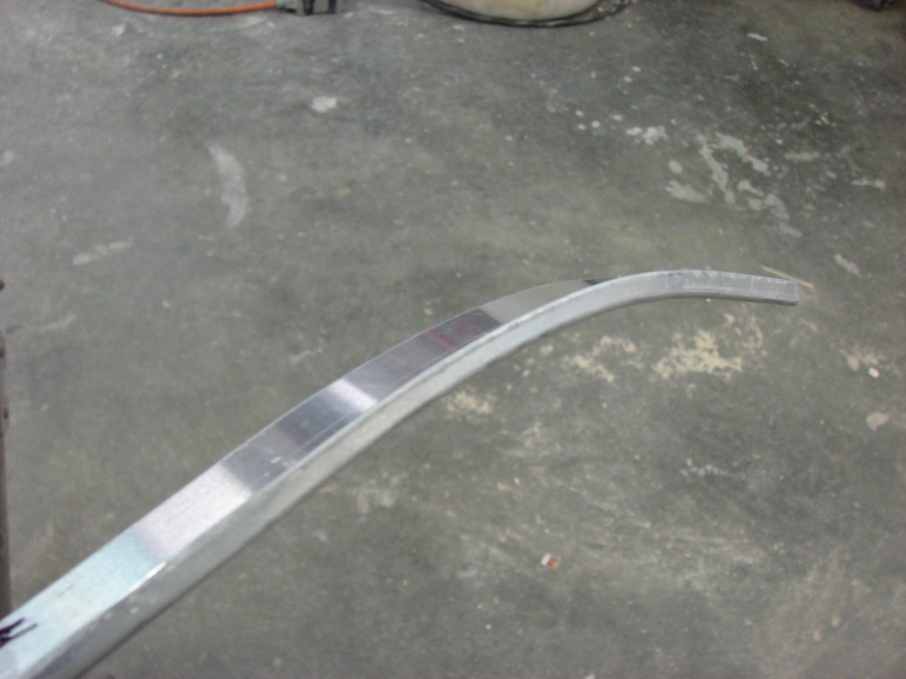

    This is what the result is.

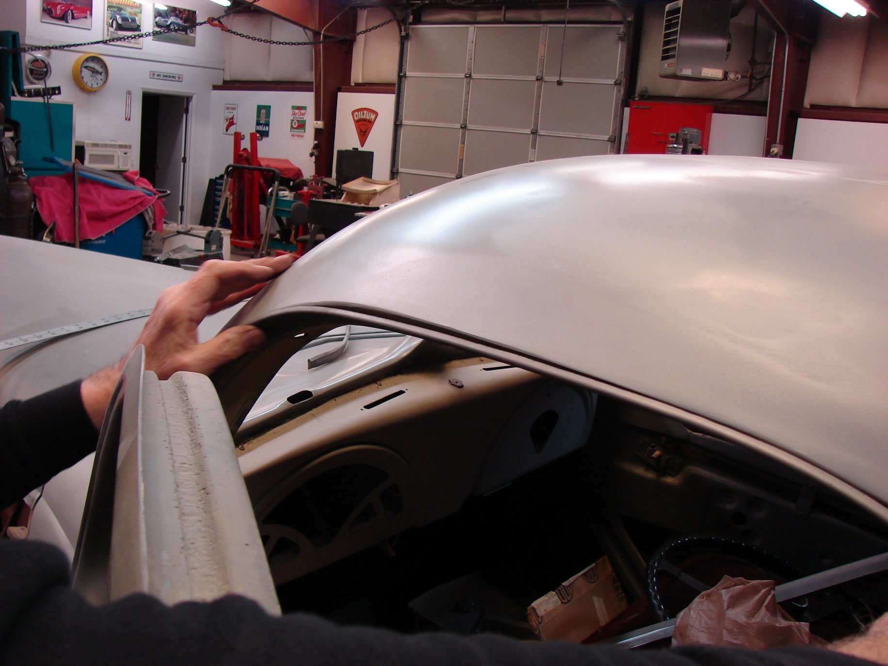

    The next thing is to bend it into the shape you need. I thought this would be harder to do than it really was, but it bent into shape easily. We used the top of the door to get the right shape.

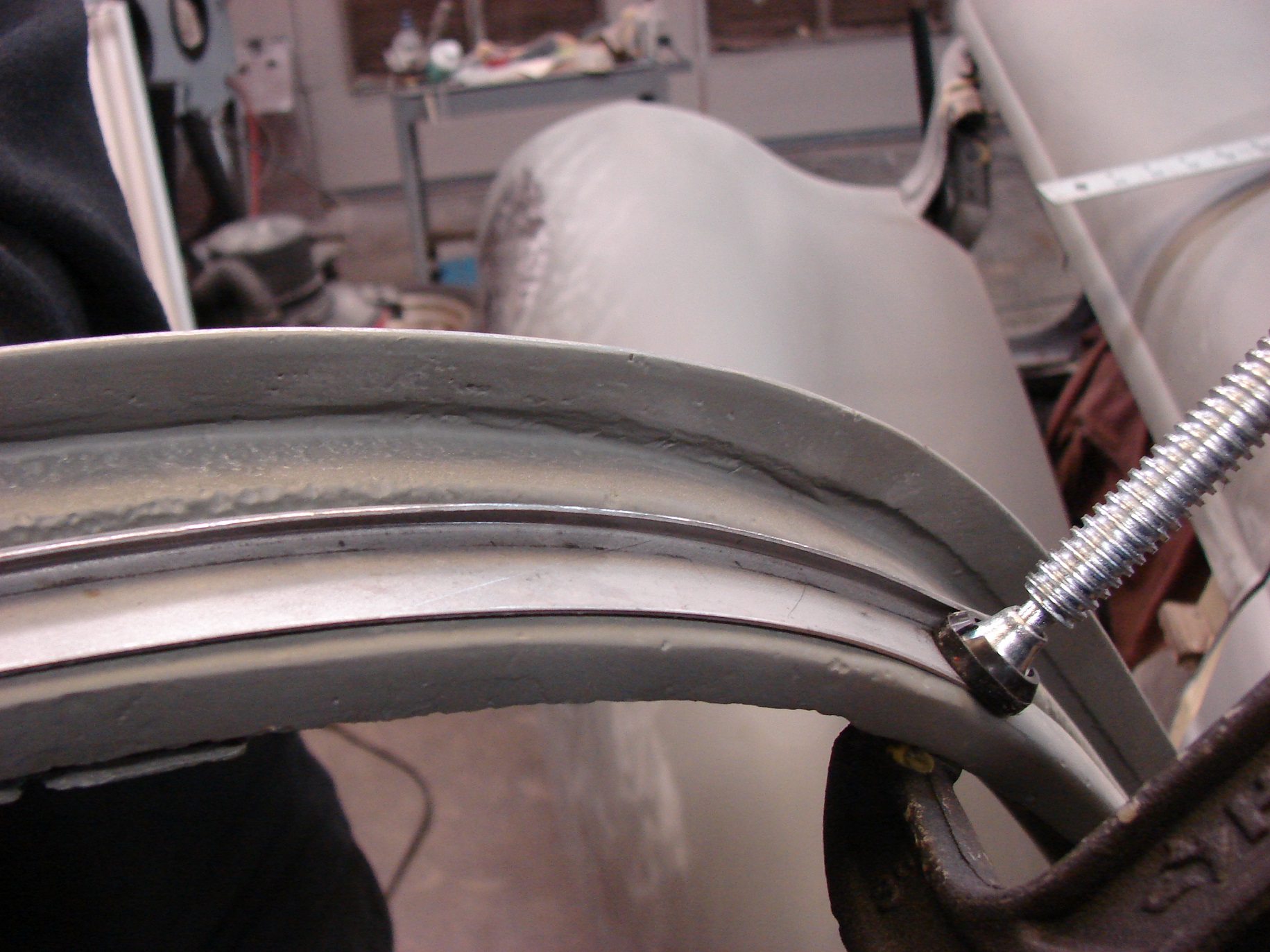

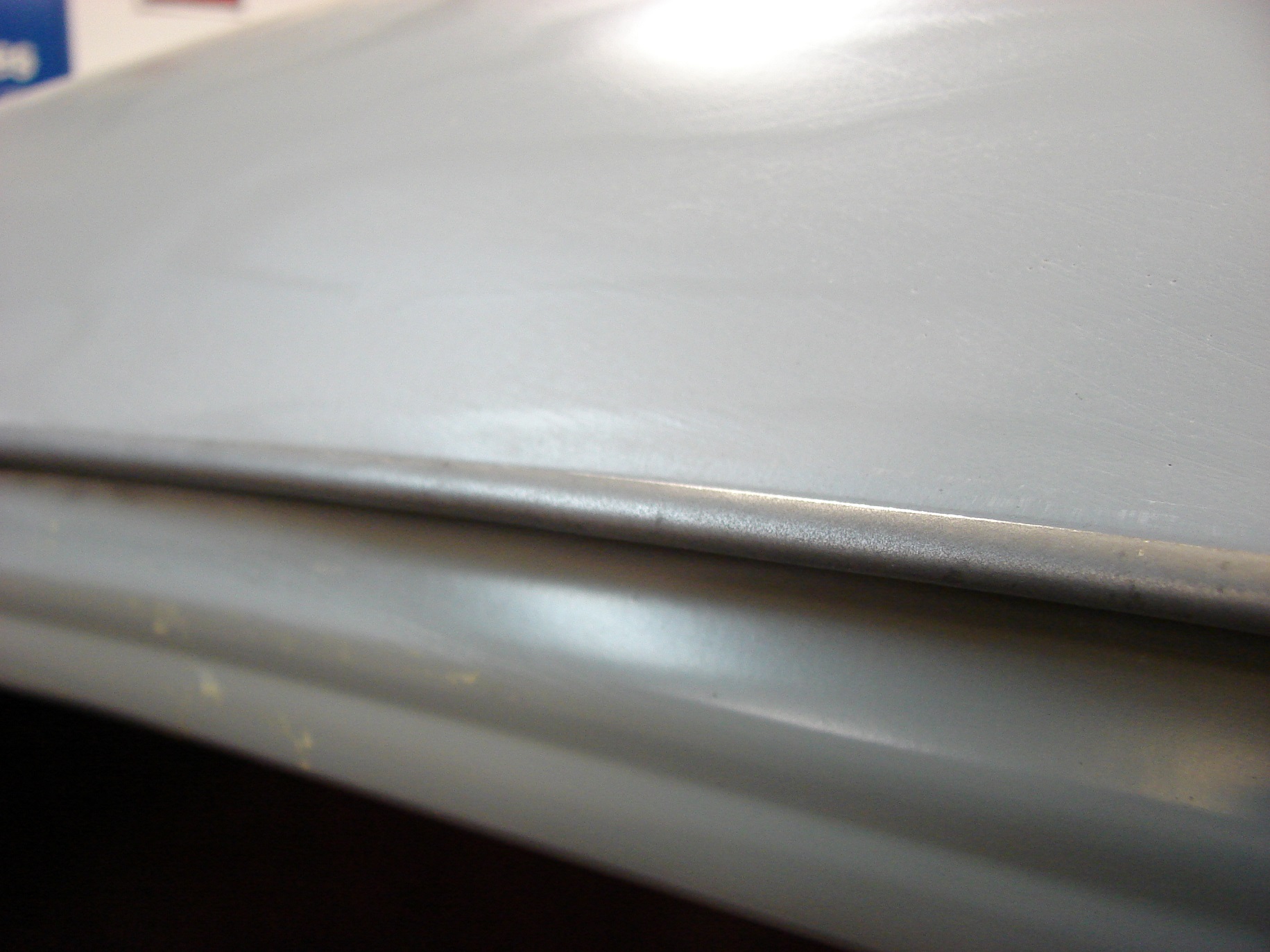

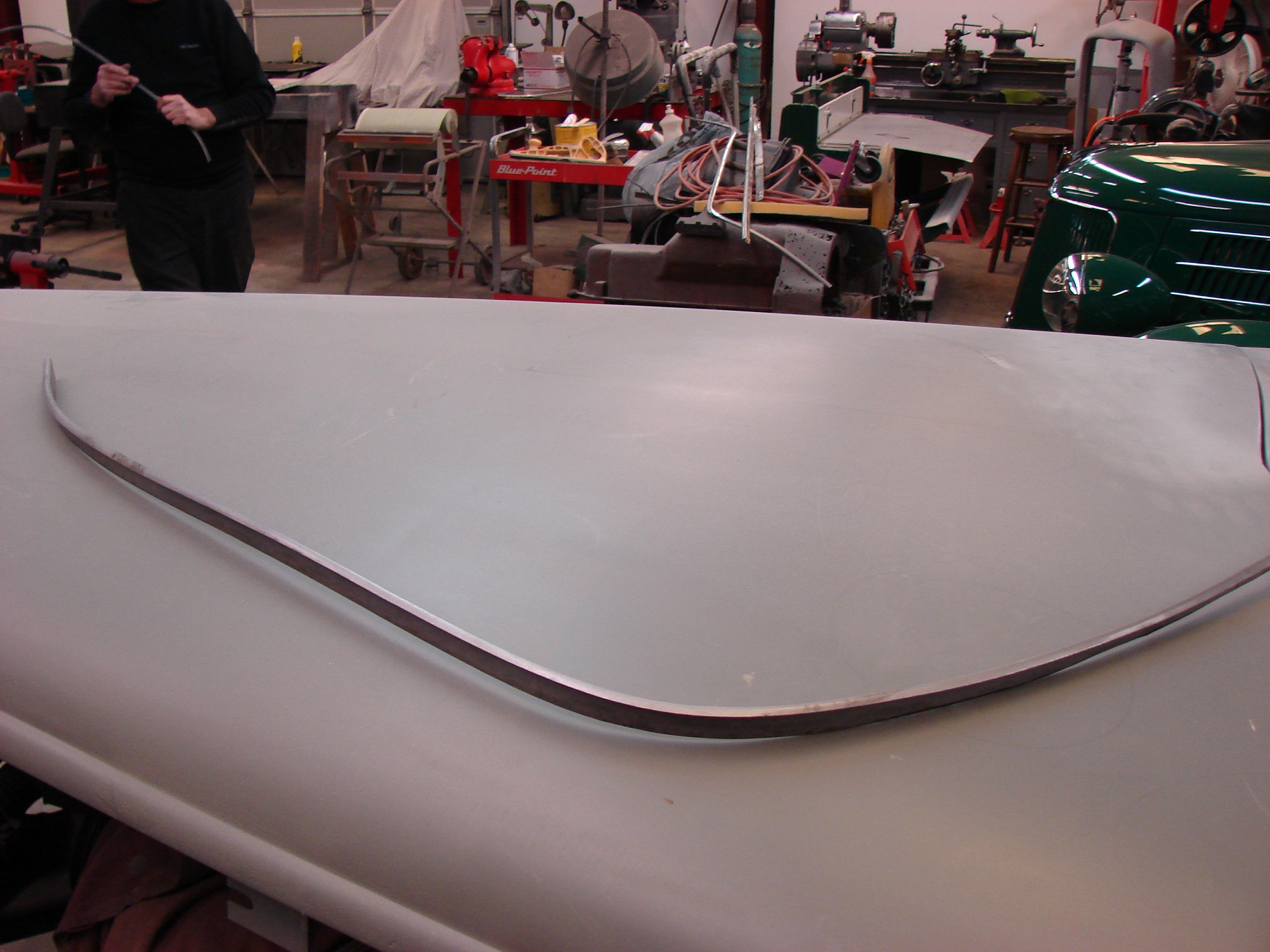

    It was fitted and bent by hand until it fit perfectly and this is what it looked like on the car.
    This is the piece off of the car.

  18. ...how is that atttached to the car?...rivets?
    cool57 likes this.
  19. sailingadventure
    Joined: Feb 11, 2007
    Posts: 283
    sailingadventure
    The drip rails will be plug welded to the body. In the picture, they are just wedged in for the picture.

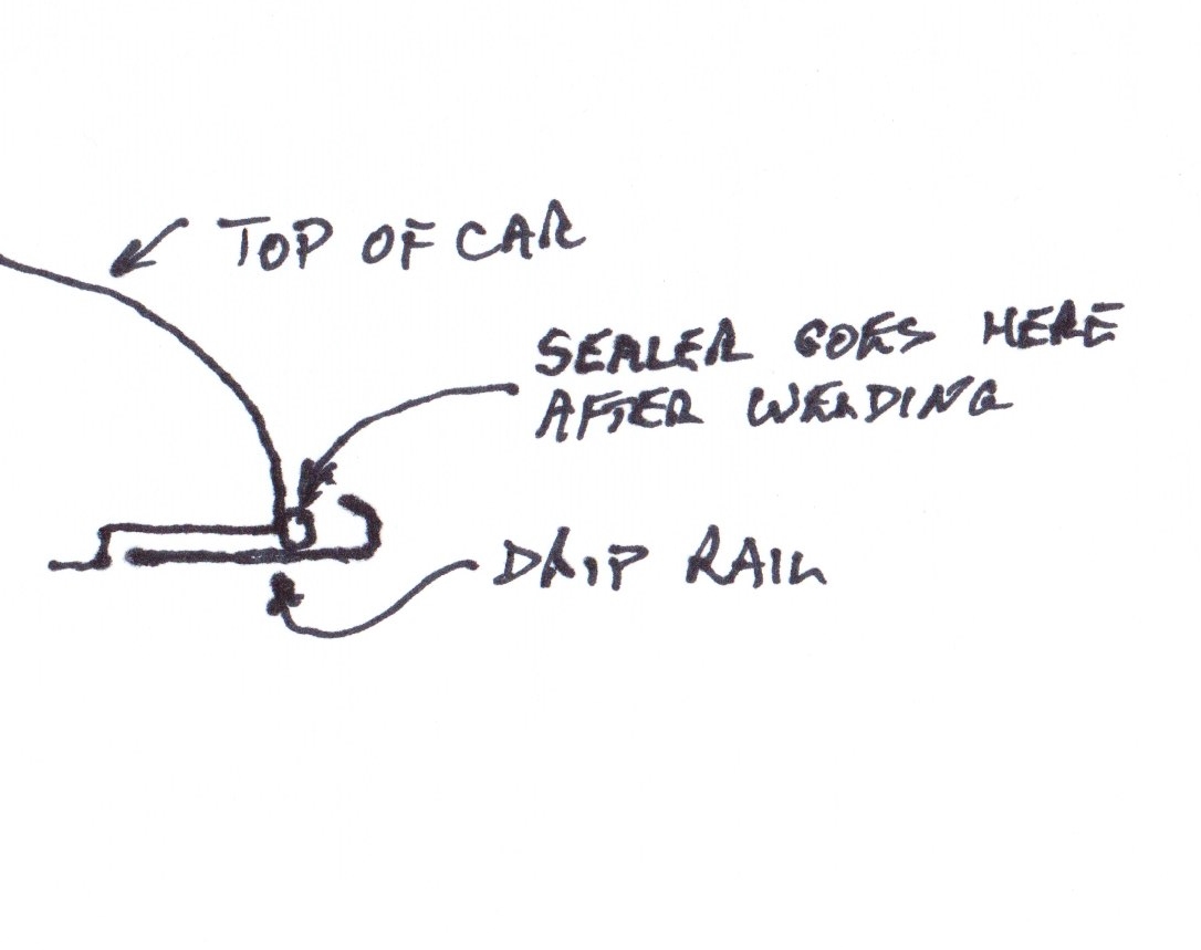

  21. Is that an open drip rail and away from the roof skin - like a gutter ?
    Or is it tight to the roof skin like a rain lip?
  22. sailingadventure
    Posts: 283
    sailingadventure
    It`s a gutter about 1/4" from the roof. It`s just hard to get a good picture of it.
  23. It's a nice clean look and a very nice piece. I'm just not understanding how the details of its form and attachment will actually function. ( form follows function)
    What's the plan for getting some paint in there and sealing the seam between it and the door jamb. Hoping for some cool tricks here. Thanks

    We`ll use weld through primer and Black Jack epoxy sealer where the drip rail is attached to the body. Drawing 001.jpg
