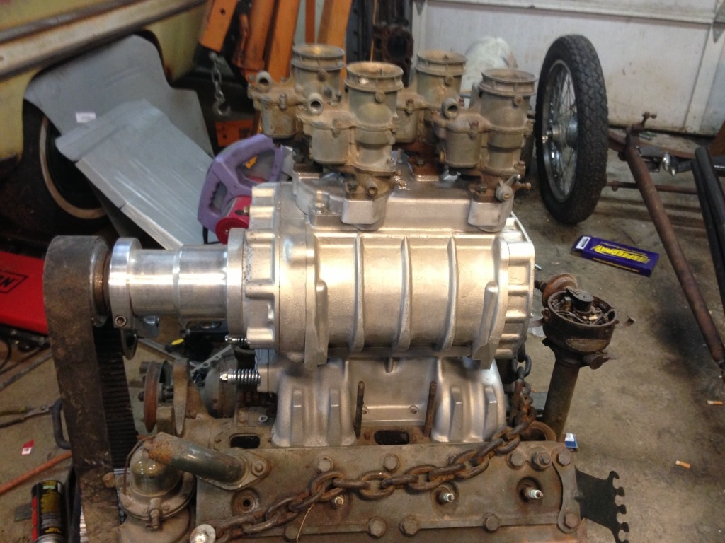

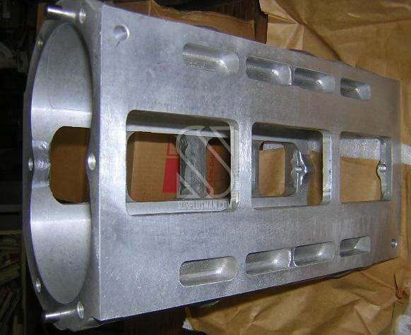

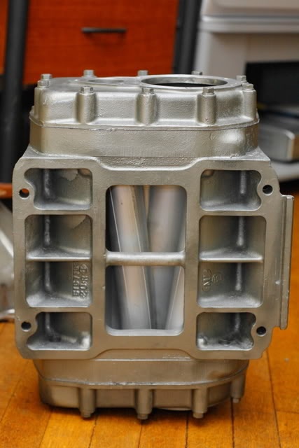

  1. The first 2 pics are of pruned gmc case.
    How is it mounted ?
    Obvious how the non pruned case mounts.

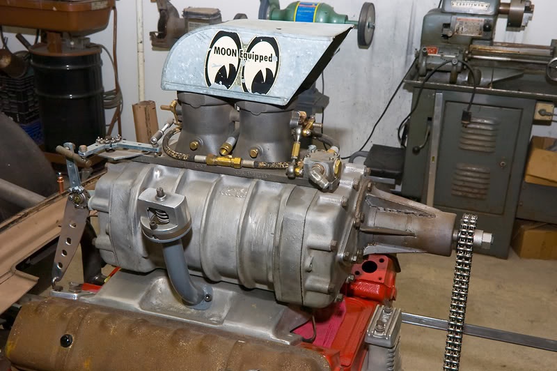

  3. 19Eddy30
    Joined: Mar 27, 2011
    Posts: 2,320
    19Eddy30
    from VA
    Hhmmm I have ran a lot of Blowers / Supercharger , I do not see how the 2nd post would work!!!
    The second pic looks that bolts go from bottom up , (intake first ) to bottom of case,
    The fist pic does not look to be that way, is the intak correct for that blower case ? Or is it just sitting there , not mounted !!
    Unless the blower bolt to intake 1st then intake with blower mounts to Block /engine , Backwards BUT maybe??
    It looks that rooters would over lap bolt holes on intake,
    31Vicky with a hemi likes this.

    Base of the blower case is drilled and tapped. Use studs and mouth it to a flange with the corresponding bolt pattern as show by squirrel. No bolts are inside of the blower or intake of don't correctly

    the only one I've looked at in person was a 3-71 that was pruned and mounted upside down on a flathead. I didn't pay attention to how it was bolted to the intake. I did see the GM casting number on the top of the blower (they are usually on the bottom), also the holes for the oil line to the back was positioned so you could tell it was upside down.
    The second photo, you can see what looks like the GM casting number on top, between the first and second ribs.

    Some were some weren't. Can't find the article in my pile of mags but the Pete's and Ohio George cases were indeed drilled and countersunk internally to use allen screws down into intake (6 nylocs?). Rotors had to be removed but no real reason to separate anyways. Not just weight but also a lot easier to remove valve covers on an SBC with a 6-71 too.

    I do believe Tom Beatty did the pruned cases back in the 50's (maybe as early as the late 40's) on the flatties & then the olds that he ran on the lakes. & also believe - but don't know for sure - that they were bolted in from the bottom through the manifold. Might've been studs instead.

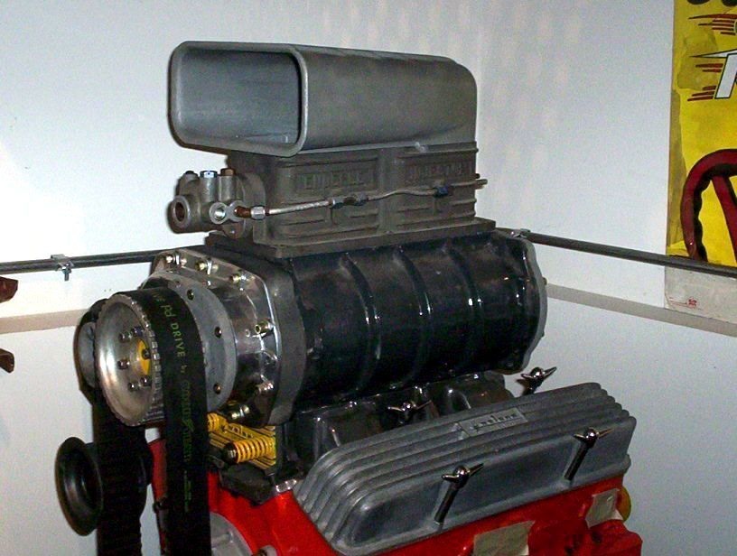

  18. I was thinking along those lines --- , mounting the case from the inside with rotors out.
    But then I thought that it was a bunch of trouble to go thru. So maybe there's another way.
    Once the thought train was rolling along-- I couldn't help to wonder that if the pruned blowers do in fact get mounted, why are the V6-71 blower cases soooo hard to mount? At least every post about a v series blower has a comment about mounting difficulty. Or crazy plates and sealing difficulties. image.jpg
    Seams that a V series is almost a pruned case. Yet with a big bunch more of mounting area. Compared to what's left after the removal of all this.

  23. Bottom picture with the Enderle is mine (don't remember posting that anywhere did I?) Anyway yes you need to disassemble the blower to get to the bolts inside. As someone stated earlier which are countersunk. You cannot see the bolts when you look up from the bottom of the manifold. I don't think I have any pictures of it taken apart. Maybe Rob with the Gasser Passer has some, as his was bought in pieces. The drive with the yellow idler used to be my spare, and he has an aluminum manifold. Mine is all mag. I will be mocking my eng/trans into chassis this weekend if I find any other info I'll post it here.

  29. In both instances the bolts go into the case from the bottom, either bolts are used or studs in the blower and nuts.
    In the option that Paul posted the manifold is attached to the blower then mounted to the engine. the blower manifold may have threaded holes in it to facilitate the mounting of the blower then plugs screwed in after the fact. I am not thinking this up on my own I have helped assemble one that way for an old timer's blow caddy.
    Jim's example is pretty straight forward. set the blower and screw it together.
