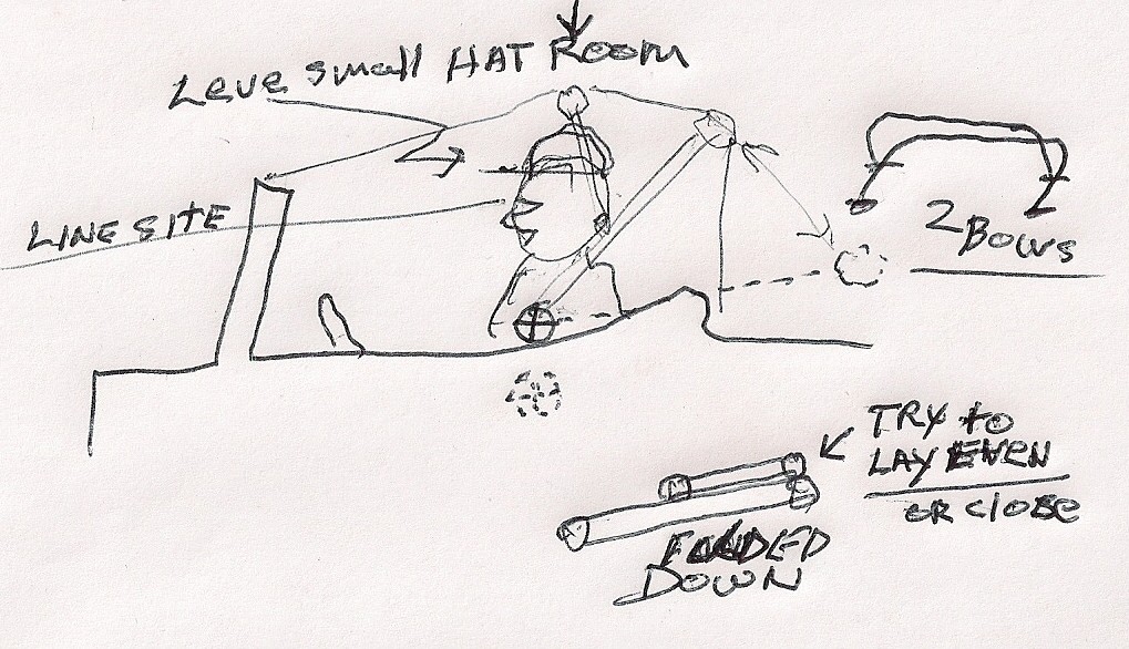

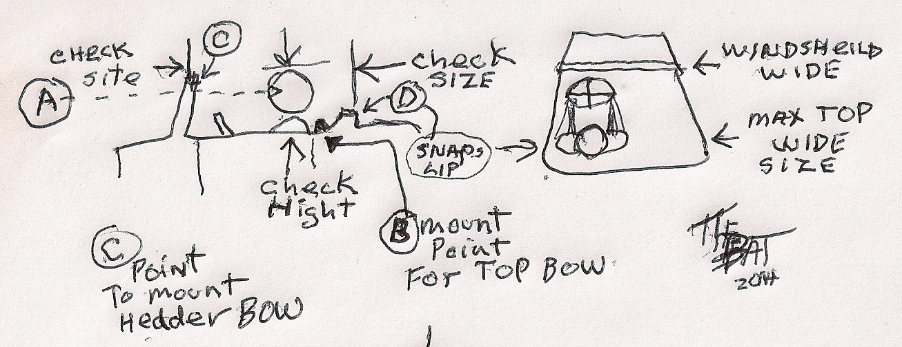

    Plan out what your going to do. Start by making up a side view drawing of your car with you setting in it,add some sizes for top of your head and were windsheild is and back of cockpit. I like doing it best in full size on a big cardboard or something like that,you can even get a buddy to trace you out after the cardborad is cut to fit just behind windsheild and all along top edge of cockpit showing back lip, But if you good at scale do it that way if you like.
    (A)Most importen to check is line of site for driver when setting in the car,can you see the road though the windsheild ,not looking over it [ most of you know this already but] =if not there are a few ways to fix this; #1 add a taller windsheild or lower your seat if posible enough to see through it .
    If nethere of those canbe done,you can resort to making a custom windsheild header bow that incorperates a glass windsheild top section that stays with the header bow all the time,even when top is folded down=a bit odd but a lot of old cars did have two part windsheilds with one above the other, stock that way as built. You can get clever and make it fold also from headerbow.
    First design prob to deel with after your layout is made and working out about were and what angle your bows will be at. Will be holding the top header bow in place #a and holding the backbow inplace to the body #b.

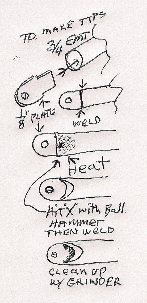

    I'm doing it myself like all the rest,I picked up two 3/4in. EMT tubes,thats what you see as 2 bows,the windshield header is wood,two 3/4in.x 3in. screwed together an shaped,I made up two metal lock to top of post deals=locks with a little wing bolt at each side.

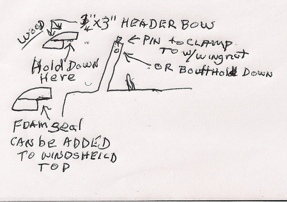

    Danger Danger Will Robertson,header bow must lock very solid to windsheild post,best if wingbolt has a small indent to screw into for safety=this design dose not have all the side brackets like a stock set.

    Two top mount points need to be figured out ,,too even get strated on laying out your custom folding top,#1 is how to hook to your windsheild and #2 is how to hook top bows to your body.
    Here are some ideas I'll pass along; To help you design something that fits best for your hotrod.
    #1 header bow can be held with custom clamps or scocket and wingbolt{like I'm doing,also I've seem straps that run down the outside of widsheild frame to a bolt/bracket. All of them use a header bow that fits the top of windsheild a bit like a upside down "U" or "L" and can have some foam seal inside that.
    #2There is a number of ways to hook the bows to the hotrod body. Ford "A" used kind of out in the open tab that just sticks up out of the side of cockpit a little behind the door openning,it works well. Older bodys like Ford "T" just had a bolt that stick out,out side of body/they can be seen on a lot of T-buckets that have tops;but most of those do not fold at all.
    To hide the mount point for your bow when the top is not on your rod could be good for some. A few ideas along that line are; To have 2 femal seatbelts mounted flush with mouth at top of cockpit rail,and small hole in inside of upholstery to push buttom to unlock top bow .{top bow has mail side of seat belt as part of bow. Another way maybe to have only a 1/4in. or so hole showing in top lip of body that would receve a pin as part of bow mount,would be nice to use a brass gromet or a like, to finished off the hole and keep scratchs from happening..

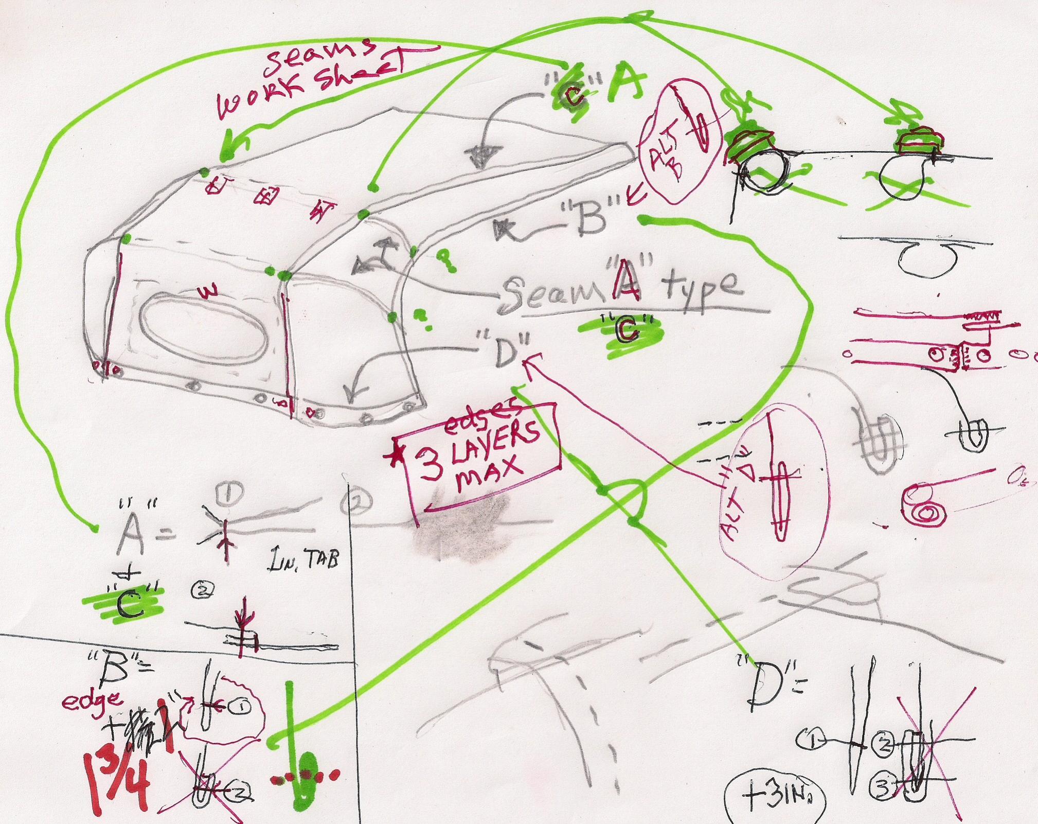

    The first photo in post #3 is show card pattern work up{old pizza box works too],from there its make seam ideas an some testing on scrap to find out what can an can't be done with tools we have.
    Preplanning is the key to not wasting fabic an fig. out, to know how much boarder to add to your patten for the seam you plan on using.
    So here is my working out of seams to use. I played around trying to sew a few in def. ways=found out with this Sunbrela fabic, my little house sewingmachine can only really do 3 layers with any fairly good seams,so had to give up my idea of any 4 layer seams any place.{If you have a HD walking foot sewmachine no prob,but not on my $20 yard sale Sears Kenmore]. My work sheet may give ideas to anyone trying this too,even though it's not pretty,I marked ALT types that I ended up with. I'll add it;
    One handy thing to pass along is;I think its good to face the showing lap side of any seam to the back of car an or down=more aero and water will have less chance of getting/driving into the seam going down the road,so that is a way I deside how to place a seam by air n water flow over its spot it will be..

    When I reread my note,I deside a drawing would make it a little more understandible.about water flow and aero at a seam.

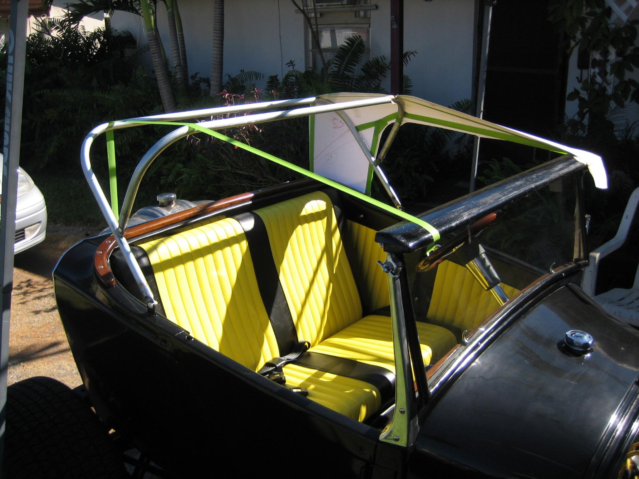

    IMG_3130.jpg Adding the top to the bows after the rear lip snapes are on,I pulled the top forword as much as I could an added two staples just to hold it as I adjusted the bow into the right place{making the bolt lock them in place. That gave me away to pull harder on top,getting it on to woodheader bow so I could put staples in on under side of header about every 2in.s or less and tucking the corners of fabric like making your bed/then cut an trim to look nice.
    To besure that the 2 back bows stay in there place,I put 2 Stainless steel screws in each bow down through the top{these are with SS finishing washers and under that is nylon washers to keep the finishing washer from cutting the fabric an hold it well to bow. I may add more screws later along the bows.
    Remeber before trying to fold top to let off the bow bolts some so they fold EZ.

    IMG_3136.jpg Here is what it looks like all folded down :D ,but I don't have my straps made yet to hold the bundel together at speed.:D:cool:
    There ya go time for a beer!:D:cool:
