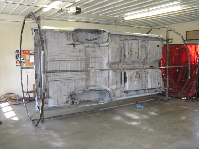

    This is one of the handiest things I have built. It's a combination dolly/rotisserie. It has jack screws in the legs that let you remove a body with little or no help from anyone else. It also has hoops that you add to it to rotate the body. This thing is great. I've had a '64 Catalina on it, as well as the 41 Plymouth.
    I made a couple of modifications you'll want to incorporate, if you decide to build this. PM me for information.
    You can buy the plans to built this at http://redwingsteelworksplans.com/ for a very reasonable $12.95!

    lets see a good pic of the base

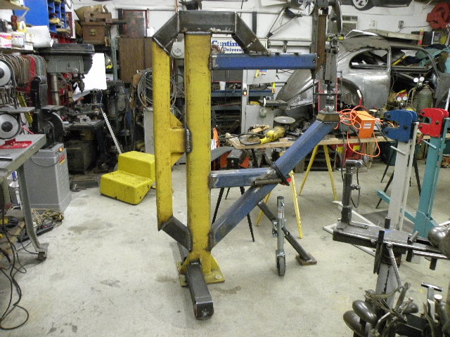

    This is a power hammer ( small yoder style) we built recently.

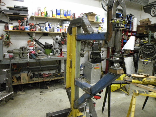

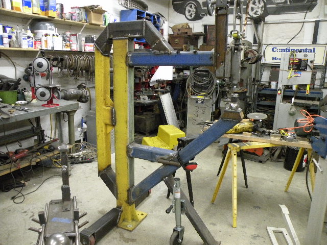

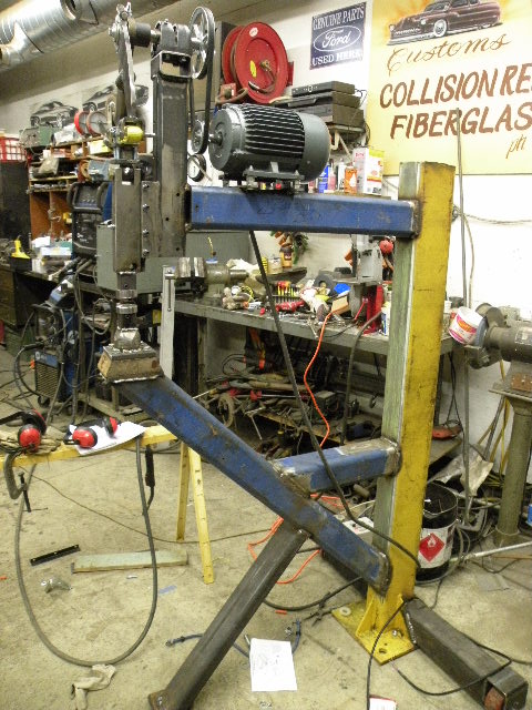

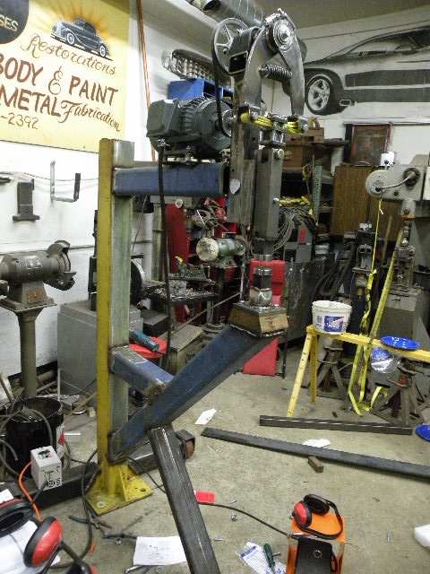

    I added some stiffeners to the back. Next I have a few more things to do the paint. This thing is a pounding fool.
    Bjinatj ask away I will answer to the best of my ability. The basic design is Richard Klinsmits. Richard & I built the base running machine in my shop in 3 1/2 days. Now I am adding a few more stiffeners plus I will be adding a little weight to the drive head to add a little more ump plus, then I can use 3 in dies now I am running 2 in. We set it up so I could use my planishing dies from my T6 pullmax. It has a 1 1/2 hp vfd foot control variable speed, no clutch.

    It appears that you are using a large spring between the two jaws coming off the drive shaft from the motor. I am guessing the spring has tension from the band pulling them together as it goes through the top dies shaft? Are you following me? Am I seeing that right?

    Bjinatj yes you are correct on the spring & belting pulling together. I will be installing a little stiffer spring soon. The one in there now works fine but I want to add some more weight to the head for a little more hit power plus increase my die size. This thing works well now I just like tweaking my equipment for max performance.
