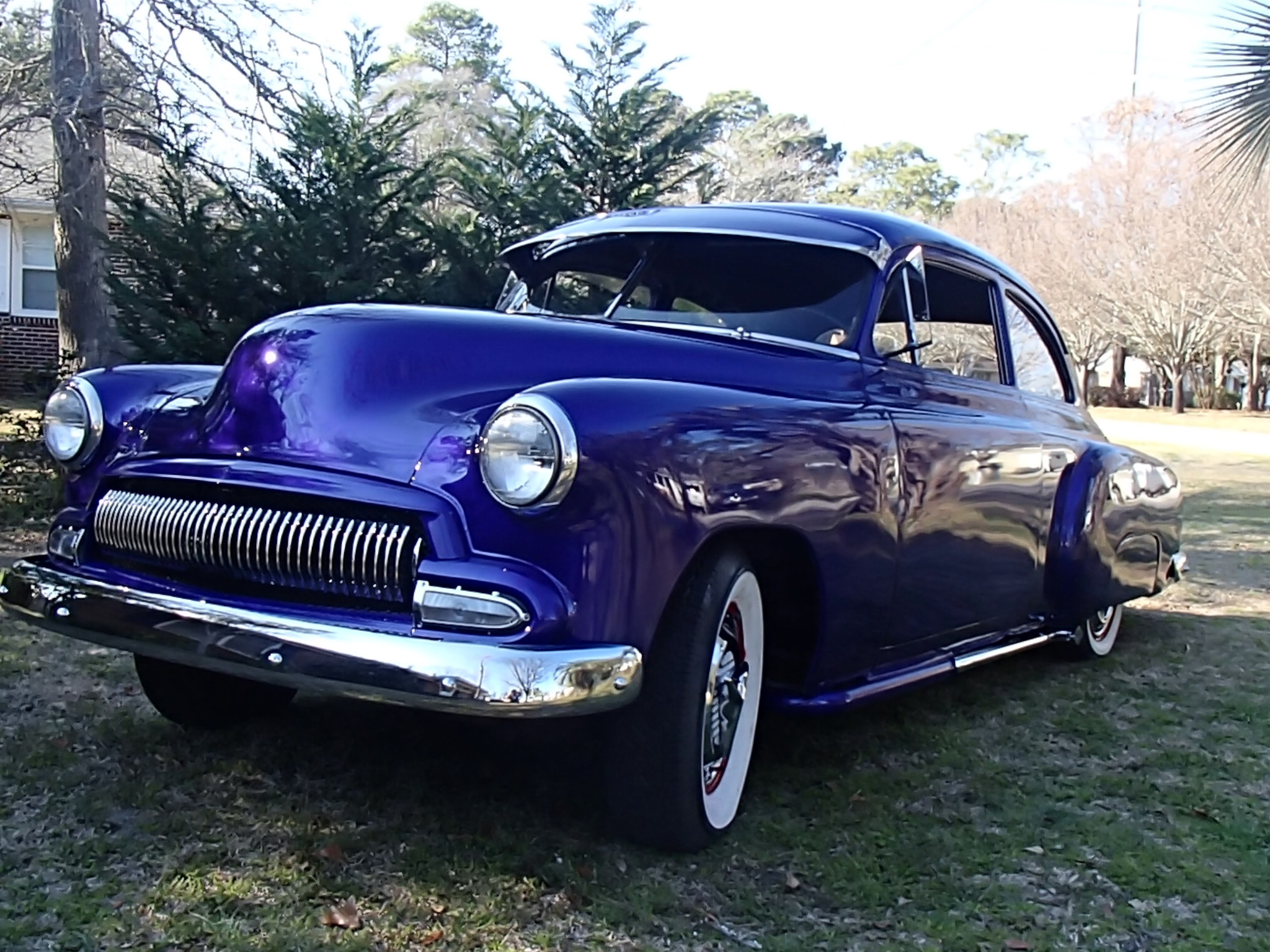

    motoandy
    from MB, SC
    My avatar grill is made from kitchen draw pulls......

    Nice grille motoandy!

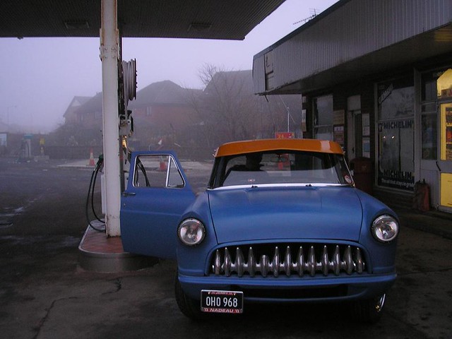

  28. I've used a bumper and over riders for mine (my avatar) from a 1960's Morris 1000, I'll see if I can find clearer picture
