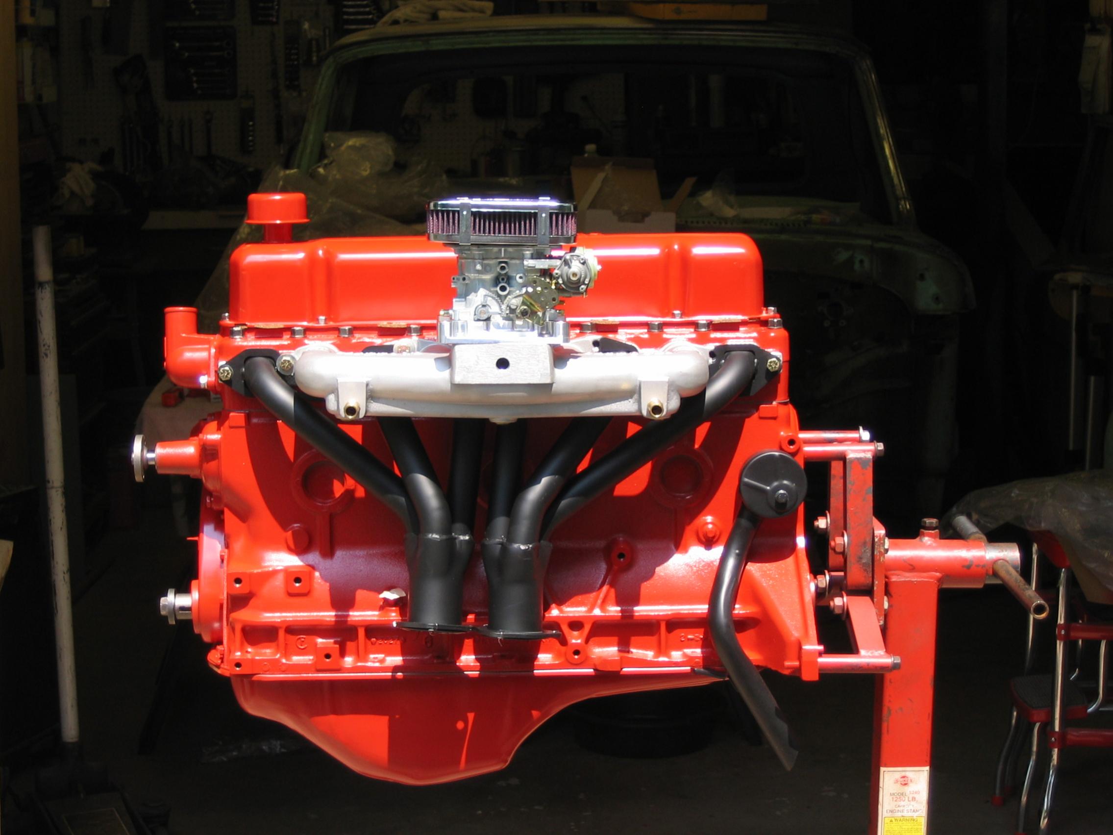

    Heres a 223 with a Clifford setup - includes headers, intake, Weber 2 barrell, modified cam, larger valves...BUT its still on the stand and I can't give you performance numbers yet.

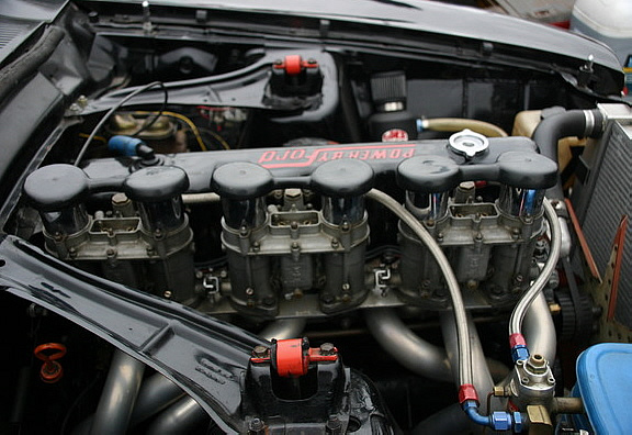

  26. seb fontana
    Joined: Sep 1, 2005
    Posts: 4,426
    seb fontana
    from ct
    Tell us about that head...
