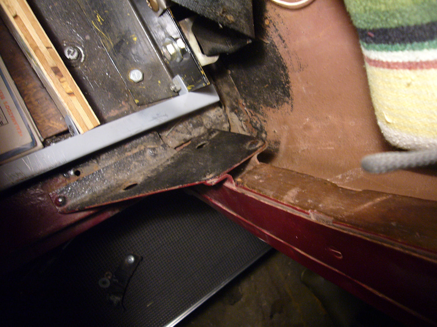

    I am trying to repair the lower cab back and corners on a 30/31 Closed Cab.Trouble is...M.I.A...! I have been given the rear subrail crossmember and some tudor 'B' pillars (grafts for the bottom 8" or so) I have witnessed off of the dovetails for lenght. The problem is I have no idea of what the door post to subrail joint looks like???

    There is a triangular plate riveted at the back corner of the door jamb. Won't be able to get a picture until tonight.

    Thanks 31A! I knew there was a gusset...will be great to see to replicate.
    I really need to see the post connection to the subrail.

    Here you go! This is the driver's side door jamb, inside and outside. The shouldn't be too difficult to fab.
