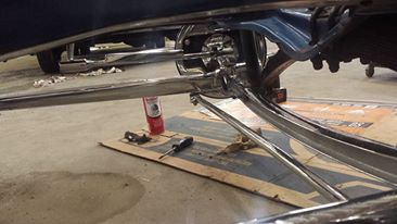

    The car had some issues that needed to be addressed, the motor was about 5" too far forward, the x member was badly cut up, the cab was angle channeled and the box wasnt aligned with the cab, steering needed some help, the front spring was wrong, motor was now stuck and it had a hyrdo.

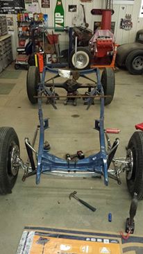

    So, my buddy Chad got he car home and dug into it, Ive been mentoring him on the car! LOL
    my buddy had a good 324 for sale that came with a speed gems adaptor to Gm so i told him to put a 3 speed behind it.
    He trimmed out the bad x member and used just he back sections over, he slid the motor back and remounted it.
    The cab had been wedge channeled so i told him to lower the back and mounted cab with out a wedge, so he reversed teh rear main and took a few leaves out, much better.
    so next step will be to mount he cab.
