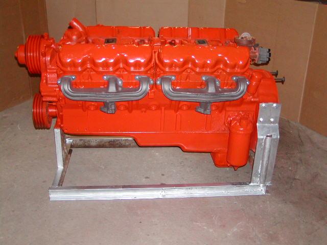

    Anybody out there got some pic's of engines we are talking about, I know Povertyflats had a big GMC six for sale about year back and that thing looked real neat has big engines go.

    Now wouldnt this sucker look something in the right engine bay!!!
    I beleive it is the GMC engine that Povertyflats once owned.
    I am open to correction if I am wrong.
    Id like to see if anybody else a better pic of this or any other!
    What diff ratio do you suggest this would need in a painted ratrod.

    That is a 702 CID GMC twin six, famous for passing everything but a gas station ,in truck use 2-3 MPG. Rear ratio 2-1 but ya still need a couple of gears to get it moving. Red line on them things was about 3600.
    As a aside a Hall-Scott weighs more like 2500 ready to run. Buddy of mine has one sitting in his back yard,still in the remains of a fire truck, good runner though. Also a fuel sucker at 2 MPG.
