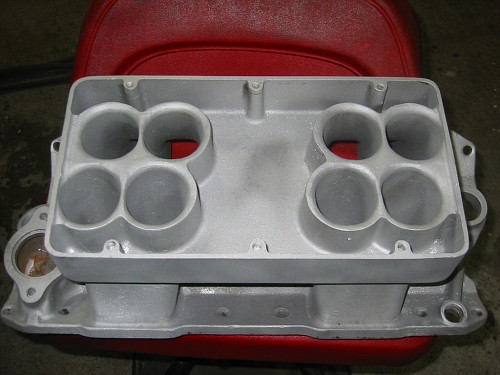

    Carroll Caudle and Ridgeway ran modified production,I never knew of them running the gas classes. One of them came up with the idea of pouring the Edelbrock tr1 half full of epoxy because it had too much area for a little motor

    Yea, they were MP cars, but folks were talking about the early tunnelrams and they both ran them. Caudle did run Gas with his Vega (I've seen pictures of MP in this car too), but I realize that's later than what's allowed here.
    The early Edelbrocks were pretty notorious for gas puddling in the plenum and back firing. I think the epoxy helped with that too.

    Grumpy did a lot of internal work, a real lot

    I don't see a problem here. :D

    Never seen that secret! I seen some pics built in the top half by extended runners of a carb plate, don't know which came first.

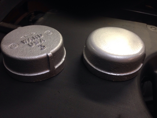

    Looks like you built a "traditional" tube bumper to me. :rolleyes: But add some class and grind off the lettering on the caps.

    Actually I don't like the caps they are not right the shape is not correct so I'm looking for some old ones but they are hard to find if I can't find some I will definitely do that

    You might be able to grind on those caps and give them that more rounded edge look. I was as the hardware store this weekend looking at their caps and they look the same as what you have on there.

    Use a short section of the pipe, thread on a cap and turn off the ridge and a larger corner radius on a lathe for more of a custom made look

    The lathe is good. No sense spending hours with a grinder.

    I might just try that my lathe is big enough to chuck the cap in but I'm not sure there is enough material to change the radius like I want for as much as these things cost you would think there would be a lot of material but there isn't

    Well here is the best magic I can do on these crappy new caps before cutting through had to weld it up twice and start over lol these caps are about as crooked as you get but I guess it's not too bad now to copy it on the other one

    Did t\you try looking at fence post tops for shape?

    Yes I did and they were way off the more I look at it the more I am ok with it

    Nice work. Look 100% better.

    It was just a thought. They still look good. To old brain fade don't remember what they looked like then. Where they more rounded?

    A pipe with screw on caps just looks right.

    Thanks guys I think it just right
