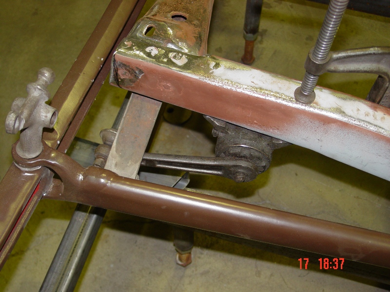

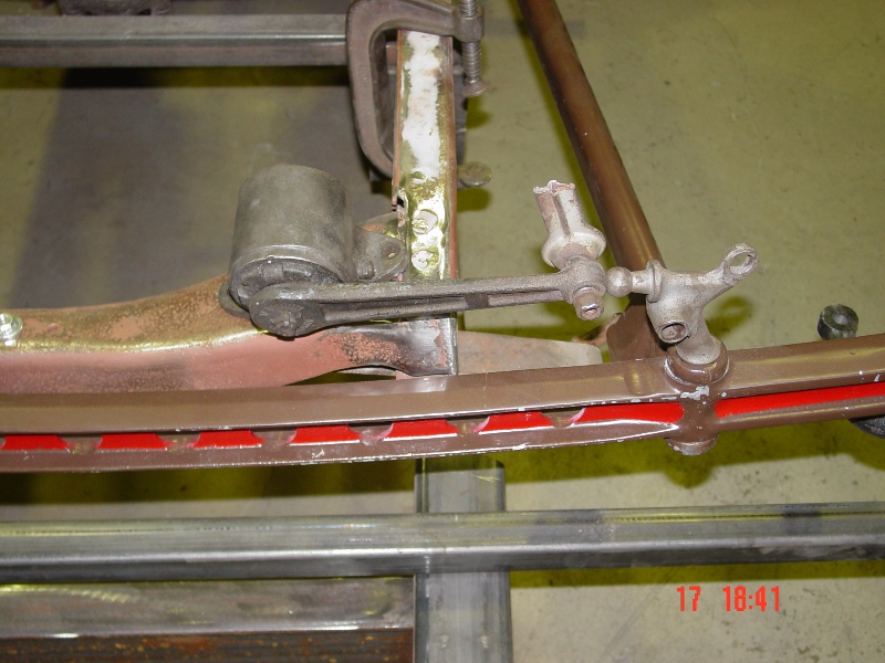

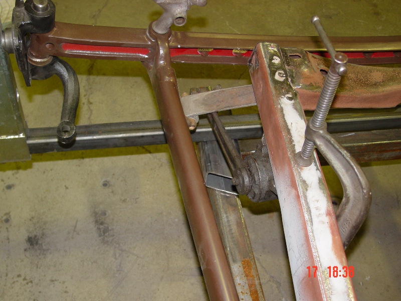

    Will a friction shock work ok if mounted upside down? Or are there different rates bump/rebound and have to be mounted rightside up?
    I have bare frame rails and those shocks are big. I included a couple pics of the shock under the rail, i am playing with the location so don't get all excited about the nearness of the spring etcetc - i am eyeballing.
    The 3rd pic is the shock on top of the framerail and the 4th pic is where i was in favor of putting it as the shock would work better.
    What do you guys think?
    Thanks, oj

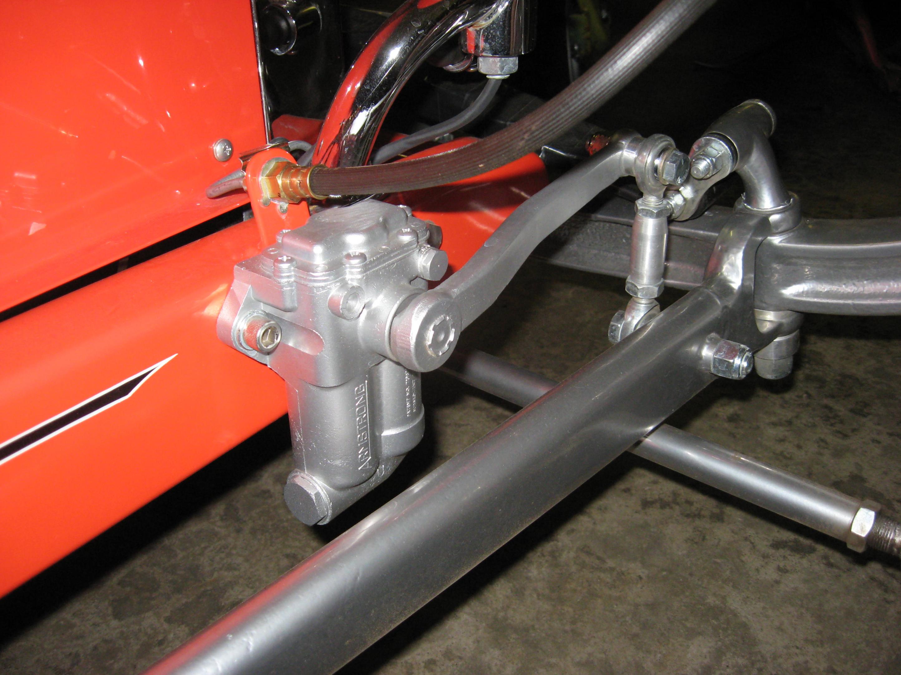

    OJ, These shocks are 60's era MG/Sprite rears, I have been using them for years, just something to consider, if you cannot make those work.

    Marty, My Buddie! Those are the ticket! I am ashamed to admit i have some similiar to them, Armstrong shocks?, and had planned to use them on the rear. Mine look larger than yours, but i will mess with them. I stuck one up there and it looks like a natural.
    Thanks, oj

    Those are the small Armstrongs, Girling built some that are similar, used on British cars as well.
