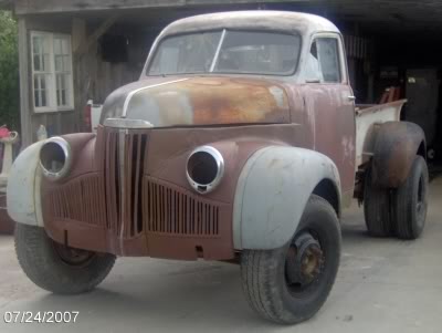

    Is it possible to swap the frame on a 1951 studebaker truck
    i whant to use a chevy 1984 3500 frame

    Is it possible? Most such things are possible.
    Will it turn out the way you want? You need to think about what do you want to do with the truck when it is finished before you can address that question.
    I'm betting front track width will be too wide for a lowered truck without either body or suspension modifications. Without knowing what kind of bed you intend its difficult to comment on the rear.

    ok this is what i whant to do with it but with a 1951 studebaker

    I assume from the picture that you intend to use this truck as a car hauler. The one pictured isn't real tall as trucks go, but neither does it appear to be lowered, at least not much.
    I still think you need to look at how the wheels will fit in the front wheel wells. That will mean some measuring and comparing and thinking carefully how high to mount the cab on the frame to keep wheels inside the wheel wells while also covered and maximize your ability to turn because something that long is hard to park.

    can somebody give me how wide is the track of a original stude

    Looks like you won't have the only one on a full size dually chassis. Found this one in a Google image search.
    If you have the big truck fenders, track width should be about right.

    If I'm reading that right, it says front tread width is 60-1/2", the rear's about the same.
    I can tell you that I had my '46 Stude on a '69 F350 dually chassis, & with the 1-1/2 ton fenders on it the front tires were just about right. I'd post a pic, but Photobuckets having a fit at the moment. I believe the 2R series are a touch wider than the M series were.

    ok so is it a direct bolt on if i use the 1951 R16 front fenders only on my 1951 R5 truck ?
    the R5 front tread is 60 13/16 and the R16A is 63 1/2

    I can't say for certain on the R series, but on the M series the fenders are a direct swap. Here's a pic of my M on the F350 chassis.

    but i just notice that on the orange truck it does look to have the R16A front fenders ?
    i will try to find out what is the exact frame on that truck its maybe original ?
    because the tread on a GM 73-87 is 65.8:confused:

    wow i just find some info on that truck it a original 1 1/2 ton
    and the bed is narow 12 inch
    so this truck doesnt have a newer frame :(
