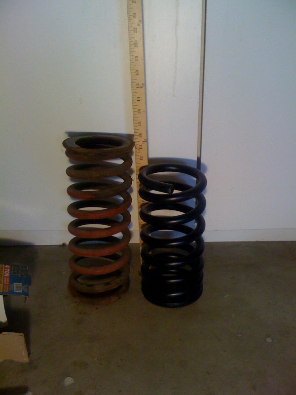

    RESULTS ON MY 1950 FORD CRESTLINER:
    1) Highly recommend the aerostar springs on every shoebox, sits nicer and handles way better!
    2) Ride is much improved and it does not bottom out on bumps.
    3) Dropped 1.5 inches in front, old coils were sagging a bit, see photo
    4) Use old coil springs as garden decorations, looks great and you can have "spring flowers" all summer long.
    HOW TO REPLACE FRONT SPRINGS:
    1) Remove anti-sway bar, if nuts/bolts give you trouble in any step, use combo of liquid wrench and a torch.
    2) Remove the top nut from the shock, (the shock will turn so you need to use a crescent on the top screw to keep from turning).
    3) Put a jackstand under the body and use the floor jack to raise the lower a-arm just outside of the shock till a-arm is level, (this allows the plate under the shock to be level).
    4) If you can get the lower nut to come off the shock without turning the shock then great, otherwise do steps 5,6 then use a vice grip on the shock when removed from vehicle.
    5) Use a little hydraulic jack (from your vehicle) to put pressure on the bottom of the shock screw, (this reduces the pressure against the shock plate).
    6) Remove the bolts from the shock plate then let the little jack down and the shock comes out, (loosen both nuts together, not one completely then the other)
    7) Remove the floor jack from the under the coil spring part of the a-arm and place it under the center of the inner a-arm shaft and put pressure tight to the frame.
    8) Loosen the four bolts together (which hold the shaft to the frame), don't fully remove one then the other, they're under pressure so rotate between bolts.
    9) Let the jack down and work the shaft out, might take some work, but don't ruin the bolt thread in the process.
    10) Let the jack down slowly to the floor and the spring will come out without being under much pressure, no need for a spring compressor.
    11) Clean all parts.
    12) Jack up the inner a-arm shaft slightly to put the new spring in place, (it will fall back out without pressure), remember to place jack so that it wont hit the frame before the inner jack is in place.
    13) Put the bottom of the spring in the depression of the a-arm plate with the same orientation as the original spring.
    14) With the spring in place put a little more pressure on the a-arm and make sure the spring seats properly on top side, if not, re-seat it and make sure the new rubber piece stays in place.
    15) Jack the spring up more and use a hammer/crowbar to align the a-arm and the rotation of the inner shaft.
    16) Make sure the bolts slide in easy and not force it too much.
    17) Screw the shaft bolts in place at 50 ft/lbs torque.
    18) Put the new shock in and screw the top lightly to keep in place (the bushing alone will do).
    19) Reverse steps 2-5, and when the green bible refers to inch/lbs of torque for the shocks, simply divide by twelve to get foot pounds (48in = 4ft) - in reality, just hand tighten without too much force).
    20) When done with both sides put the ant-sway bar back on and enjoy.
