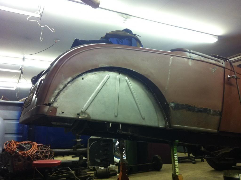

    As for the body, I started by redoing the sub frame where it has been cut out around the frame step. The body was really flimsy, I remade the bottom of the A and B pillars.
    On top of that it needed wheel well, quarter panel, and the bottom of the passengers side cowl post.
    The wheel wells I actually just finished a few days ago. There is so much welding on those its crazy. I'll admit I do not know how to do good sheet metal work but aside from the awful quarter panel patches I think it came out ok. I still need to grind down the welds on the wheel wells but I keep putting it off because that is going to suck!
