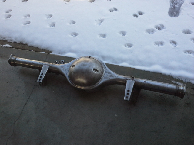

    I have a 9 inch housing in my 57 Ford pickup that has a smoothe back with the barely raised flat strip in the middle and dimples on each side. The dimples are not round but elongated horizontally. Every picture I can find and every description that I have found show and refer to round dimples. Is this just a manufacturing difference or is it from a different car or truck?

    You have a one year only 57 pickup rearend. Notice there aren't any weld seams on the axle tubes, at the ends or the center. The tubes are extra thick (1/4"). I have been using them in drag cars for 35 years, because of the strength. BTW nice Olds!

    This is one I put "wide 5" snouts on, the pics show absence of seams.

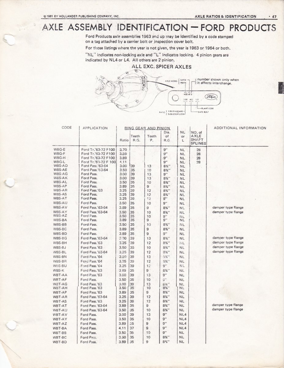

    Pass. housings to the end of '64 are listed in the Hollander exchange manual as "8 3/4", and, as far as I know, need minor grinding to clear the later ring gear. Truck housings do not. I have a '57 housing that required minor grinding. I wont post the entire Hollander section on ford rears, its too long, but the first page will illustrate what I am talking about.

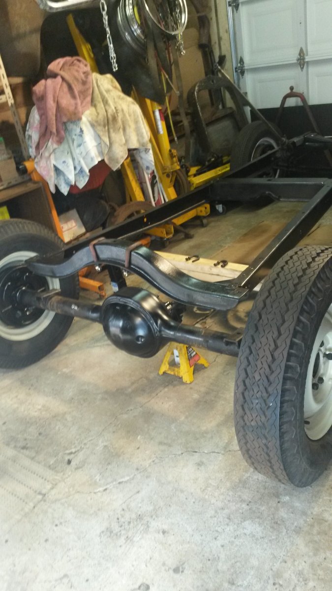

    Hey Guys I need some help on identifying a Ford rear end housing I have. Everything I have read says it's a 8" housing (has two round dimples, flat on top and no protrusion for the ring gear) but it has a 9" third member (can't use a socket on two of the lower studs, has a rib in the middle of the third member) in it. So what do I have? Any help would be very much appreciated.
  28. FrozenMerc
    Joined: Sep 4, 2009
    Posts: 3,103
    FrozenMerc
    You have an axle that is painted white and laying out in the snow.....
    Pictures help over-the-interwebs identification alot.
  29. Robert1555
    Joined: Jul 25, 2011
    Posts: 41
    Robert1555
    FrozenMerc here are a couple of pics. What do you think I have?
