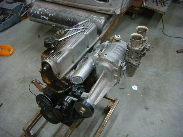

  21. metalshapes
    Joined: Nov 18, 2002

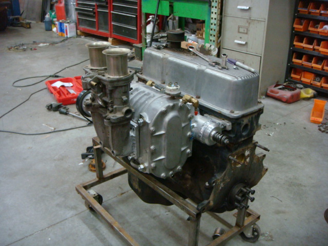

    Posts: 11,138
    metalshapes
    Don't know the CR.
    Sorry...
    I bought the engine with the Ak Miller turbo setup on it, and I only took the oilpan off to see what it looked like ( condition of the bearings, etc)
    It all looked OK so I left the head on, since it has a copper headgasket that is probably glued on and I didn't want to break the seal.
    I didn't hear it rattling at 15PSI with the turbo, so the CR must have been chosen with boost in mind.
    The boost with the roots blower is much less than that, but I'm thinking of a way to make up for that...
    Right now I'm just trying to get the 45 Dellorto carb dialed in.
    I posted more Info about this on the Dogfight Forum.
    http://www.dogfightmag.com/forum/sh...!-Who-has-the-fastest-cherry-picker..../page2
    And that is where I'll post updates about it too.

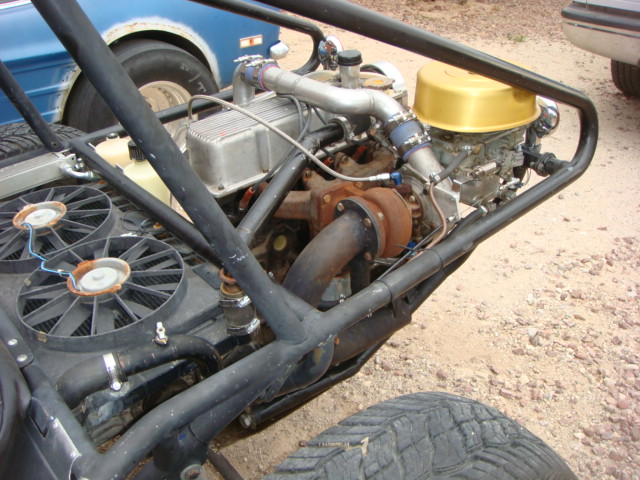

    Better put some forged pistons in it for a turbo, or a supercharger, and get the compression ratio around 8.0:1. The stock cast pistons won't live long (been there, done that!). You will probably have to open up the combustion chamber some to lower the compression, and or fly cut the top of the piston some, also look at the compressed head gasket thickness. You will need to crunch some numbers to get the compression ratio right. For forged pistons check with CP-Carrillo Piston Sales/Tech
