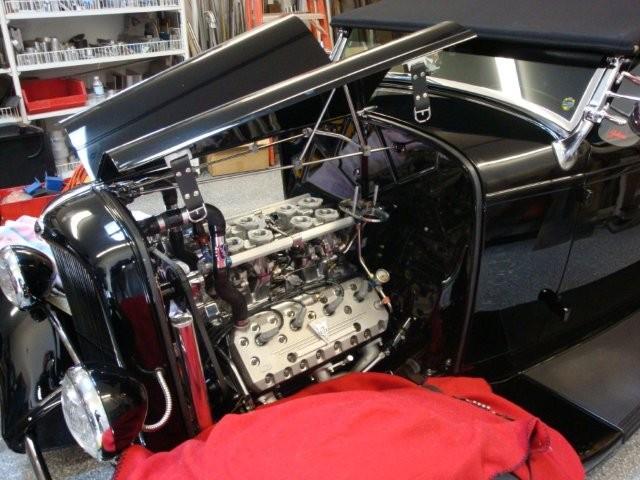

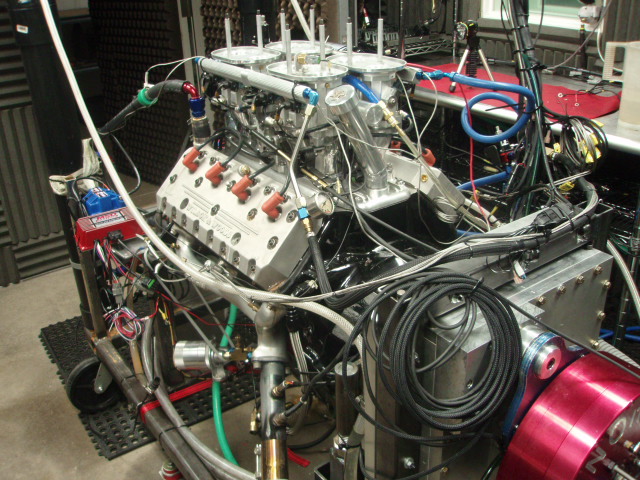

    Enclosed photos of my injected French flathead. It's 304 cu. " with individual throttle bodies. The throttle bores have been reduced for better mapping and flow. Fuel and spark are computer controlled. 3 years in development but the time was worth while. 304 ft. lbs @ 2750. 204HP at 4000. Runs smooth and handles the AZ heat. 9000 miles of pleasure. Ran from Lake Havasu Az ( 120 degrees)last july to BC no heating issues at all. I am building a new twin plug version with some new ideas. The car is a Henry with a Columbia 2 speed.
    Thought I would share this with you guys.
    Dick

    Thank you for your comments. For the people who think it violates tradition,
    no problem. I'm not a good follower. To answer some questions the heads are Wilson and Woods. The ecu is EFI tech. To sleeve down the throttle bores I machined reducers to 1 1/4" and made matching throttle plates. The plates are critical. These held water. To sleeve down the runners, I used surgical tubing with a spring inside. Poured Devcon around the tubing and filled cavity.
    If there is enough interest, I have a lot of photos.
    I'll check out to see what the Ford barn is.
    Dick

    The bodies were 1 5/8". Don't forget, this is just an air valve, not a venturi. I wanted to see more plate movement for mapping. I also played with runner lenght until the engine was happy. You can road tune, but to get the most out of this, you need a dyno. This is not a race motor, it's a road car.
    By the way, I have the help of an EFI school instructor and the kid ( he's 50 now) that ran my dyno at KERKER. Could I have done this without them, probably not. Things have changed though in the past year and it is getting easier. Still works better with a dyno.
    Dick
