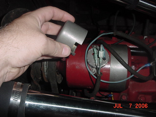

    I was wrong. I have NO posts on my generator. However, when I had the dust cover off, I would swear there were 3 brushes in there.
    There are only TWO wires coming out of my generator. This ole fella was set up at a swap meet and was pretty knowledeable on flatty stuff. I bought almost everthing he had. He had taken time to clean everything and paint it.....still had GREAT buys on stuff .....the more I bought, the better the prices were. I think he was just glad a young (good looking) young man was into flatty stuff. Anyway, my point is, I think he was sincere when he said he converted it to 12v- I have no reason to doubt him. Wonder how he did this?
    I'm getting ready for a trip to King's Island right now- leaving in the morning. While ALL the other good little HAMBr's are going to be looking at 6k+ hot rods at the Columbus Good Guys, I'll be watching a Nickleodeon parade tomorrow (I hope they don't hate me, I know jealously runs high:rolleyes: ).
    I could tear this thing down, but I still wouldn't know anything......
    So, can I run the 64 Ford regulator with this.....ya think?
    I'll have you all in my thoughts when I'm watching Sponge Bob go passed and you all have to stare at 500 red 32 roadsters....neener, neener, neener.....:cool:

    That round "dust cover" is actually a 6V generator cut out. Yours has been modified. Originally there were points inside that housing that was supposed to disconnect the generator from the battery when the gen was not charging. (engine shut off) They were prone to stick letting the battery drain down through the generator after you shut the engine off. I know some people use diodes out of modern alternators to replace the points. That allows the juice to flow one way into the battery only. I have no idea how yours is modified. You need to trace the wires to see where they go.
    Sorry I have no clue how to modify a 3 bush generator for 12V and a 12V reg. My guess is that it is not easy because there are a lot of guys looking for that special fan mount pulley to use on their 2 brush 12V converted generator. Hopefully Bruce will come up with the answer.
