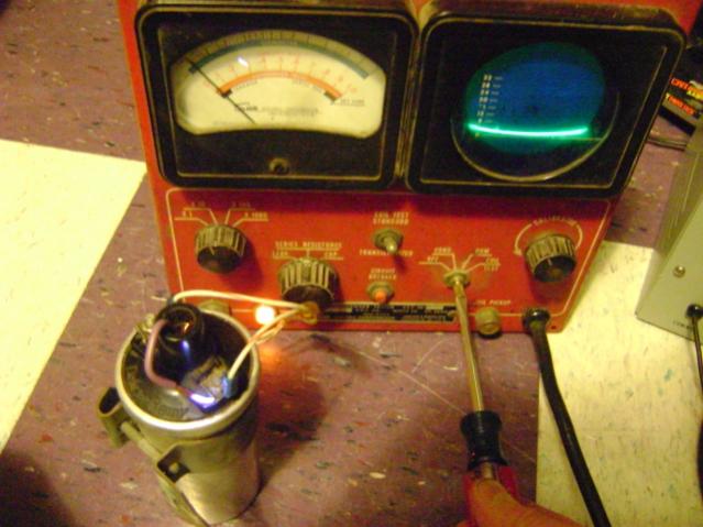

  1. Too damn sick to go out to shop today, stayed in the basement and worked on some old Sun Electric equipment. Figured it might make an interesting tech article if someone was curious about how to fix some old electronic gear dating back to classical antiquity...
    Its an old “Coil Condenser Tester” from Sun Electric built in 1966. The only reason I know the date is because Sun seemed to unambiguously stamp a build date on the back side of the case of everything they built. I picked it up at a swap meet a few years ago for a few bucks not knowing what it was or if it worked but figured it was cool enough to find that out later. Sun made a ton of cool gear like this and I figured with a condenser tester with cathode ray tube (CRT) and analog meter would be cool enough just for parts for other projects if it was a total failure.

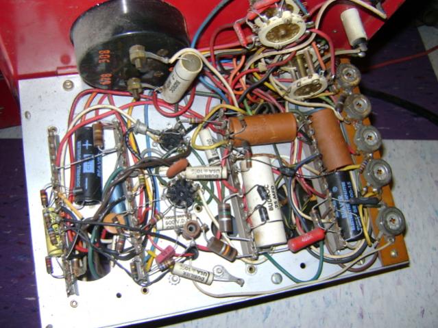

  2. Like most electronic gear from post WW2 and up until about 1970, this thing uses point-to-point wiring and vacuum tubes for amplification. Although the first viable transistor was invented in 1947, they weren't used much in audio or test equipment like this until the 60s, and then they slowly edged out vacuum tubes by the 1970s. Solid state rectifiers have been around since before WW2, but typically only for small current rectification. The condenser tester I'm working on uses both a few triodes (vacuum tubes) for amplification and some transistors, and all solid state rectification.
    Vacuum tubes use high voltage at the plates, typically between 250 and 450 volts. CRTs use even higher voltage around 800 volts (so be careful if you are going to dig into gear with tubes or CRTs). Typically the power for these components is supplied through a vacuum tube or solid state rectifier to a high voltage electrolytic capacitor. Back in this era, high voltage electrolytic capacitor were expensive and were somewhat unstable. Over time, they loose their ability to handle high voltage and short out.
  3. Most of the other parts besides the electrolytic capacitors is pretty stable. The carbon comp resistors, the transformers, the inductors, the windings in the meters, the CRTs, the tubes and even the wire in gear from this era is built to last and will have no problem lasting a while. The electrolytic capacitors are the only problem. Fortunately, we can fix them.
    Electrolytic capacitors are made by building up a layer of aluminum oxide on the plates as an insulator in the capacitor after they are assembled. The thicker the layer the higher the voltage capacity. Over time of disuse the oxide layer breaks down and the voltage capacity is diminished. We can fix them by just bringing up the voltage up slowly, using a variable transformer. Just plug in the equipment and bring the voltage up from 40 volts or so up to the 115 volts that typically comes out of the wall.

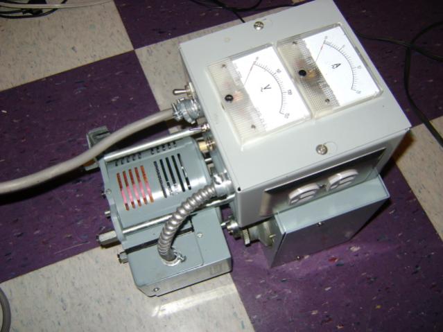

  4. Bringing up the supply voltage slowly is a procedure that can save lots of old equipment, especially your old black face fender amp that just blows fuses. There are a few things that can go wrong though.
    At 70 volts, the supply transformer was getting warm enough to melt the wax out of it, and it popped the circuit breaker in front. Something more than old capacitors was wrong with this thing. The capacitors in this type of gear are easy to spot. Typically, they are in a brown cardboard tube covered in wax. These two are marked 8 micro farad at 450 volts. I desoldered the capacitors and tried it again with the same results. The capacitors tested ok, if not a little low as expected. I disconnected a few things the high voltage supply fed and got the same results. Only thing left was the diodes, and one was, in fact, junk.

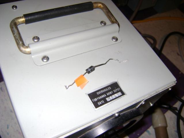

  5. I didn't have an 800 volt diode in my stash, but 2 400 volt diodes will do the same thing so I put it all back together with them and some new capacitors. Capacitors are cheap these days, 20 cents will buy something 3 times bigger than what was in there. The 22 micro farad replacements wont affect performance because they are just filters, and if they could have used these when they built it in the first place they would have.
    Turns out it is also a coil tester as well as an ohm meter. I'm not sure what the CRT is supposed to display, but it works. I'll play with it more after I fix my distributor machine...

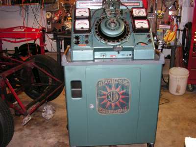

    One of the kids dropped these off last summer. They were in pretty rough shape. They came out pretty good Ive got everything working except the dwell meter on the dist. machine.
