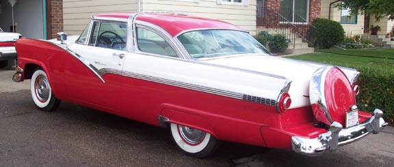

    This is a Crown Vic. Same car just more chrome on the top. Desirability is a matter of personal taste, however the Crowns do comand a little higher price.

    The Crowns also have the same windshield as the '56 cars. It is as if they were chopped, so they are much lower than a stock '55.

    55 vic is a high roof car with no halo band (teara) crown vics in 55 are low roof with teara (crown).

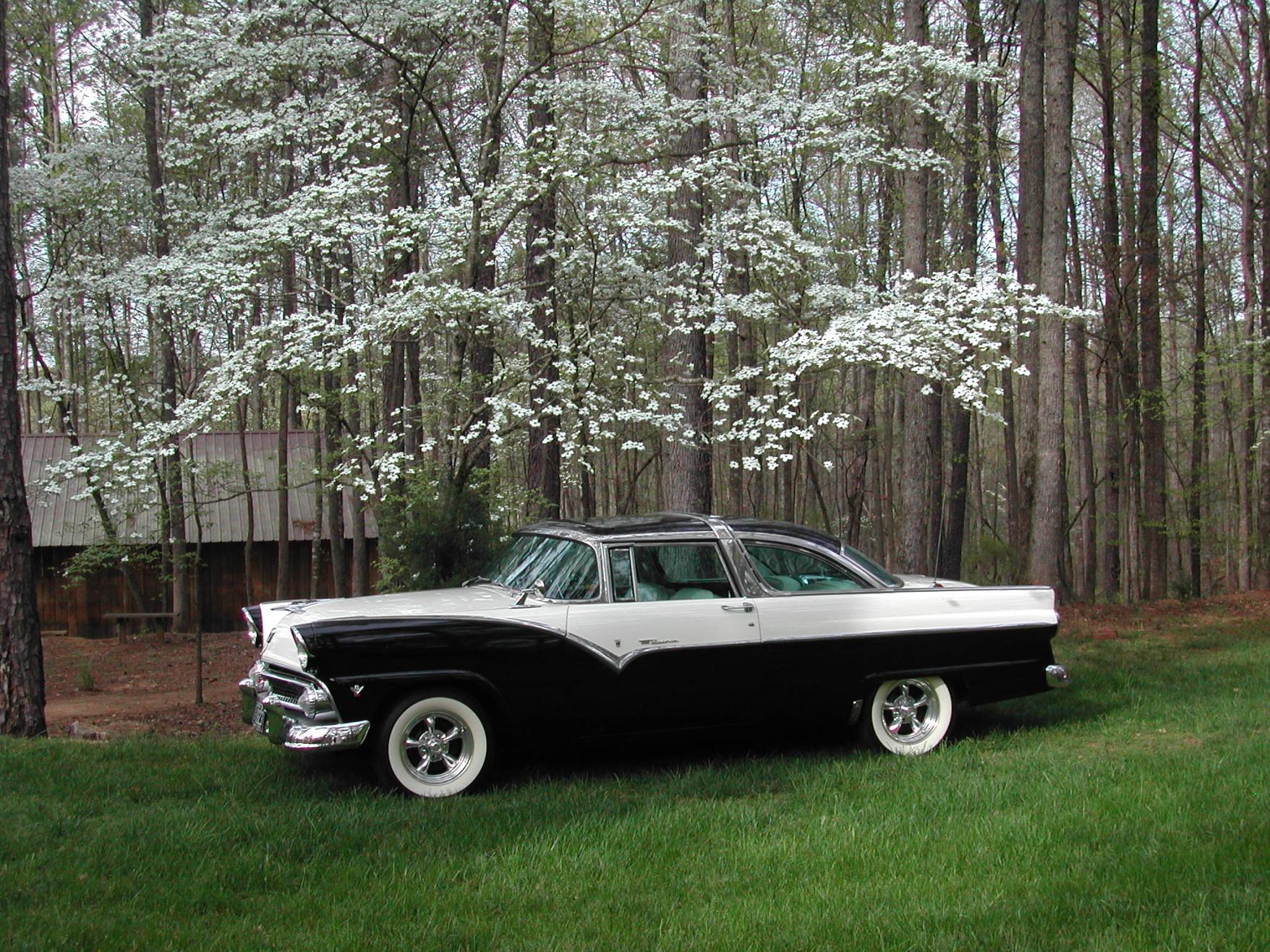

  19. The Fairlane Vic is a hard top and the Crown Vic is not. The side trim on the Crown Vic Wrapped over the top like a targa band on a Porsche. Some Crown Vics but not all had a Plexi sun roof in front of the trim piece. The sun roof was an option.

  30. The Plexiglas front roof section was an option on both the VICTORIA and CROWN VICTORIA.
    Shown is a 56 CROWN VICTORIA, A 56 CROWN VICTORIA SKYLINER (w/ Plexiglas front roof) and an interior roof shot of a 55 CROWN.
    While the CROWN is technically a sedan (B-Pilar), it retains the HDTP door and frame-less door glass.
