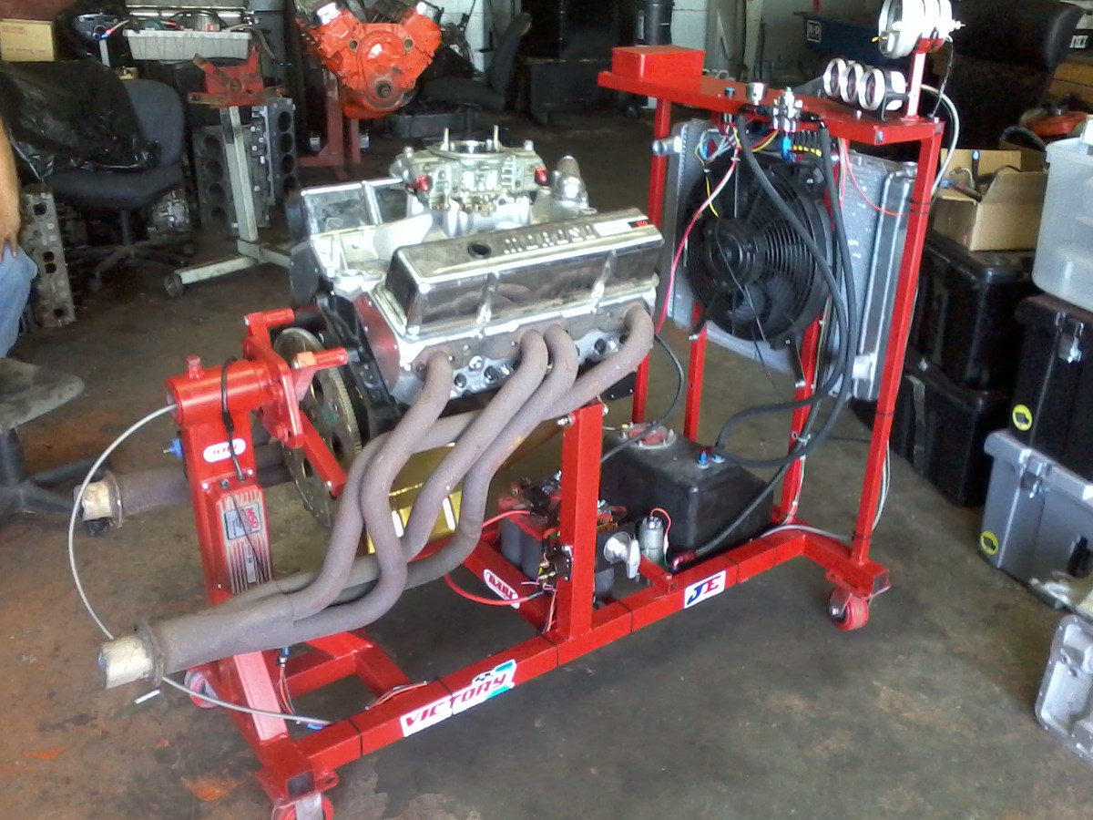

    build your own,just finished mine.built it for a friend who builds engines for a living,thats my new motor on the stand first one to get the honors.couple of hours during the week and WA-LA...

    Damn, now you are going to make me want to build one of those. Great job, looks professionally built. Smart idea using the adjustable engine stand bracket on the bellhousing area so you can run various brands of engines. :D

    you just got to make sure you use an engine stand with wide lugs on the back to clear the flywheel.my engine guy builds mostly race car motors,explains msd box.big coil,electic fuel/water pump.he said this would save some time having to break in a motor at his shop out of the car that way when you pick it up its ready to go!!!
