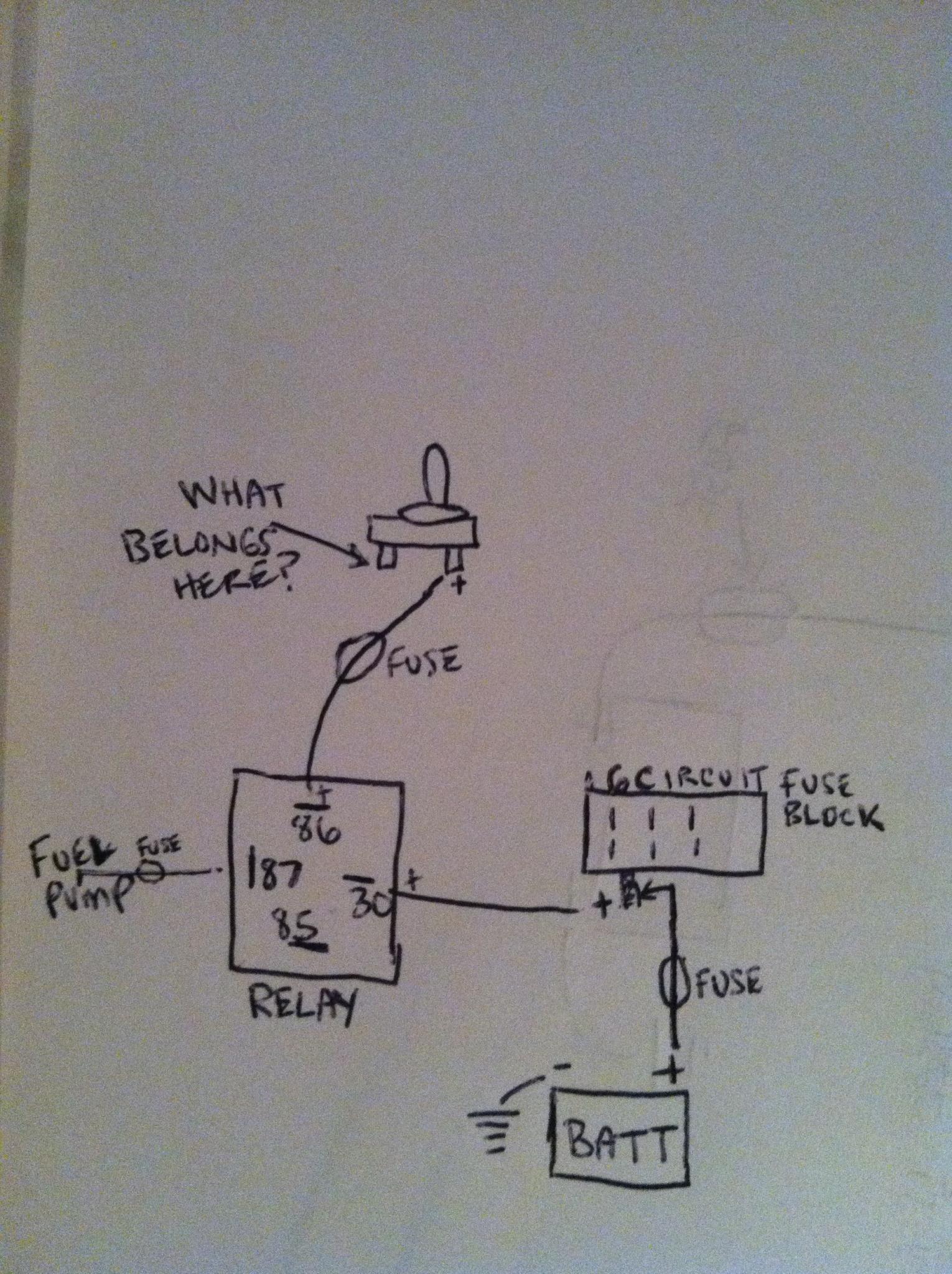

    I'm wiring my 1940 merc that's converted to 12v -ground using stock style replacement harness. I'm wiring up my 12v carter fuel pump and using a relay connected to a toggle switch on dash.
    Do you know where I can find a diagram? Or is the attached diagram that i made correct. I don't know If I run + from battery to fuse block then relay OR batt + to relay and fuse block to one of the terminals on toggle switch?

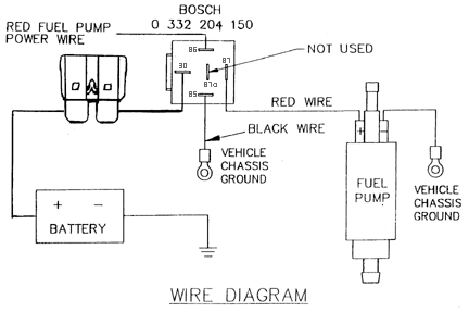

    This is how it should look I also would use a inertia switch from a Ford, wire it in either side of your switch. Just in case you get in a wreck the inertia switch shuts the fuel pump off. I prefer this than a oil pressure switch to shut off the pump it makes dry bowl start ups a lot easier. You do need to fuse the switch as well. It is a good rule to fuse all positive leads as close to the source as possible.

    But where is the fuse block and switch in the diagram?

    Your diagram will work fine, just be sure the switch fuse is only powered when the key is on ignition only. Amx180mph's diagram looks like one for adding a relay where the pump was only controlled by the switch before. If you add the fuse and switch to the wire at the top of his relay it's the same as yours.
    I have installed them with the Ford switch mentioned and/or an oil pressure switch, it just adds a little safety factor.

    See the HUGE 2 prong fuse, upper left. Wired between battery and relay.
    Switch is not shown, but it is where the top left says: Red fuel pump power wire.

    The fuse is the thing in the upper left corner of the drawing. Just above it is the wire that goes to the switch.

    I'm thinking it makes sense to wire + from battery directly to fuse block where other accessories can be added later.
    If this diagram is ok as described + to 8 circuit fuse block... there are two terminals on toggle switch. Where does the remaining terminal go?
    And would each accessory it's own relay?

    The switch would go inline between the fuel pump power wire and fuse block. As 24riverview suggested that it needs to go to a circuit that powers off with the key.

  11. Each load should have it's own fuse and relay. In your drawing, you have a couple of choices... You can jump pole 30 and 86 together and run the wire from from pole 85 to the toggle switch and a wire from the other side of the toggle switch to ground. This is how the factory switches devices like the fuel pump.
    More typical for DIYers would be to ground pole 85, and run another 12V+ lead to the other pole of the toggle switch. Either way will work.,

    I've never liked to use the ground side to control a relay because it's too easy to get an accidental ground in a circuit. If a switch fails it can ground or a wire can chafe and ground. That being said, many factory computer systems control the ground on a relay.

    Ok. Final draft here. Based on the responses I got from you ol' timers I have:
    1) removed the toggle from the diagram allowing my ignition switch to trigger the relay.
    2) sounds like an oil pressure switch is the best type of safety. Where in my diagram in this post should I put the pressure switch?
    3) do I really need to worry about the relay sticking in the on position, not allowing my ignition switch to shut off fuel pump.

  21. Not sure what the "gauge" post is on the Ignition switch...just make sure it's hot in run (I'm guessing it is). The rest of it looks fine.

    Check that gauge terminal, it's most likely hot in run position but not in start. If that's the case, move that wire to the ignition terminal. Yes, most carbureted engines will start if there is fuel in the bowl, but if not, you'll kill the battery long before fuel gets there.
