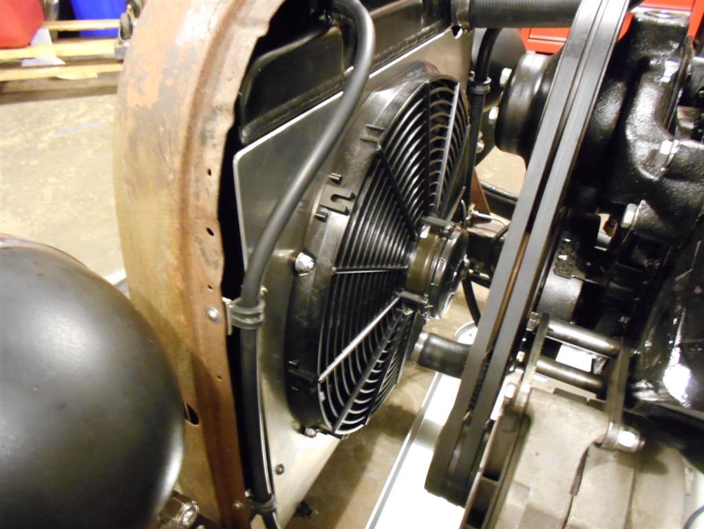

    That's weird. Before I bought a SPAL fan I extensively searched threads here on the HAMB (not sure why the OP started another fan thread BTW; there are several in the HAMB archives). This is the ONLY negative comment I've read of HUNDREDS of glowing posts regarding SPAL fans. I suspect someone in your area is repackaging cheap fans under the SPAL name.
