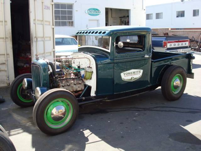

    I had the Yosemite Logging Company 32 truck painted there , off the frame, & on dollies, cab , bed both inside & out, 40 wheel & column 32 truck grill, 35 headlight buckets, came out pretty sweet , they cleared it twice so I could color sand , I didn't 'cus I wanted it to look old. I didn't touch the bed or roof etc as I wanted it to keep it's old character. Cost me $425 for everything !!! in the coolest dark green metallic (their color ) door logo is a decal !
  18. Like some said - do as much prep work as possible, take everything apart, do your own masking and buy your own paint.
    Yes - good paint will cost much more than what the ES paint does . . . but you get what you pay for. As painters, some of their guys are pretty good . . . as they've sprayed LOTS of cars in their time! Their guys probably paint more cars in a month than most of us will ever paint in our lifetime . . . so they can handle a gun. Thow some extras tip money their way - may help a bit as well.
