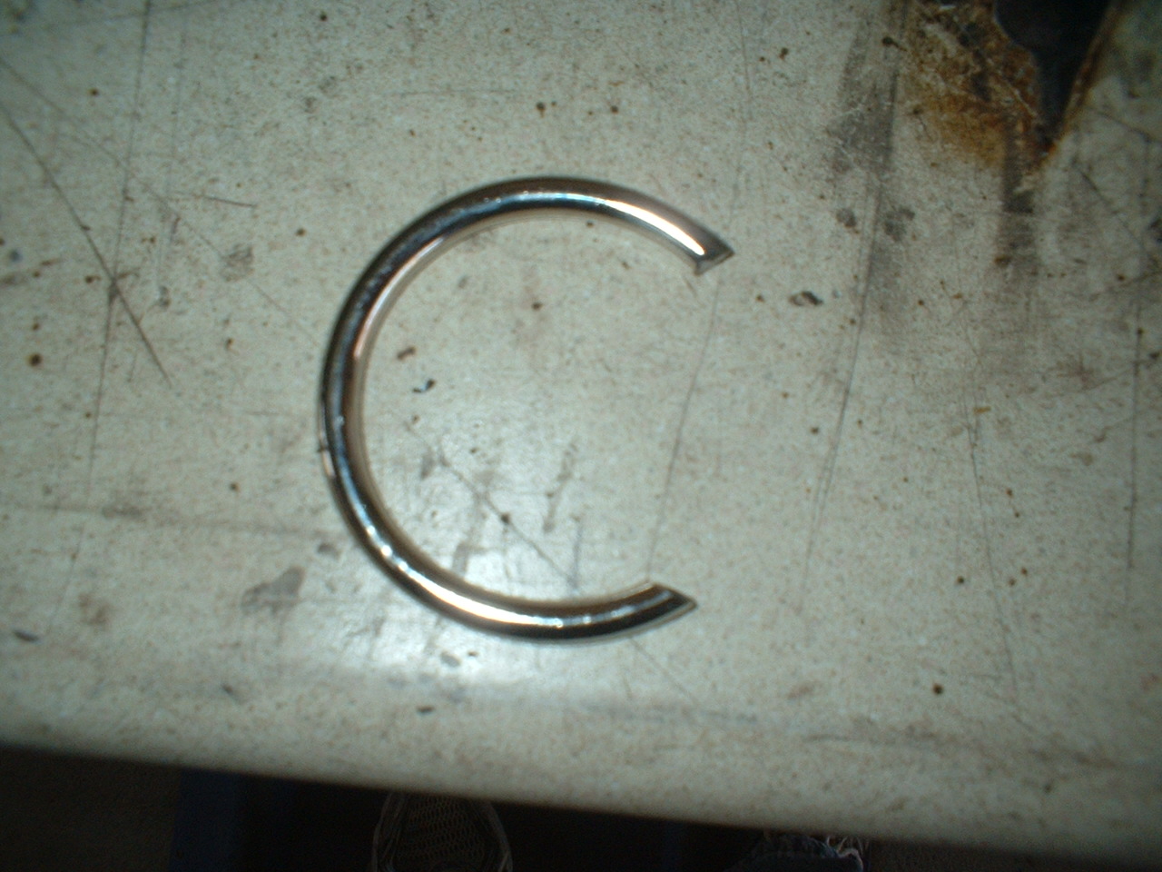

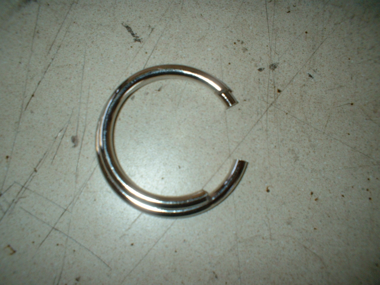

    Donor Notes: 1.The Crown Vic rear is a c-clip type, so you'll have to open up the pumpkin to take the c-clip off so you can get the axles out , so you can (finally) get the parts you really came for off.

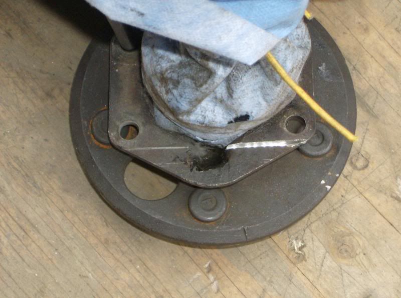

    5.5 With the axle in the vise, now is a good time to cut the bearing retainer plate. Just like you did with the axle tube flange, we need to cut off the bottom to match the flat top. Same procedure: straight and parallel
    to the top.
