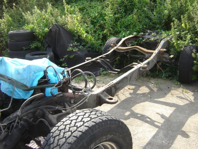

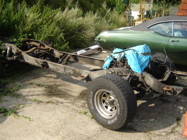

    did anybody tried a '86 suburban or a blazer chassis on a 1947- 1953 pickup??
    Does that fit..?

    That's cutting it a little short...

    i can buy this 86' suburban can anybody tell me does it fit when i want to use it for example for a 53' chevy pickup

    Yep, too small, man.
    Long bed, extended cab S-10 is the way to go! :D
