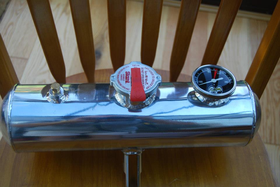

  12. Made from a Huey fuel pressure reservoir and DC3 airframe clevises. Sits on top of the spring hanger for the suicide axle catchcan.jpg
    hrm2k likes this.

  14. Blackjack that's a slick catch can right there.

    Blackjack's idea is great! looks good.

  20. Thanks guys - I like to do something different. It looked like this before polishing overflow before.jpg looked like this before polishing;

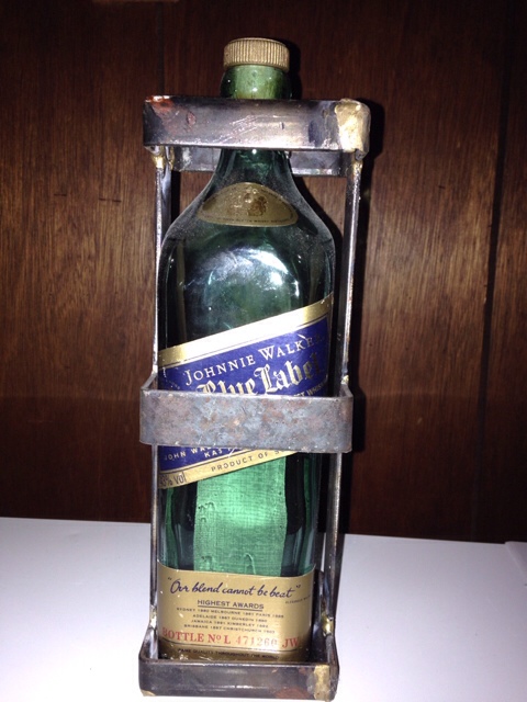

    Mine before I finished the brackets, added foam to protect the bottle. ImageUploadedByH.A.M.B.1409251195.608698.jpg

    Johnnie Blue Label.........Do you have any Grey Poupon?

    :) That is exactly why I chose it! A little bit of irony in my old truck.
