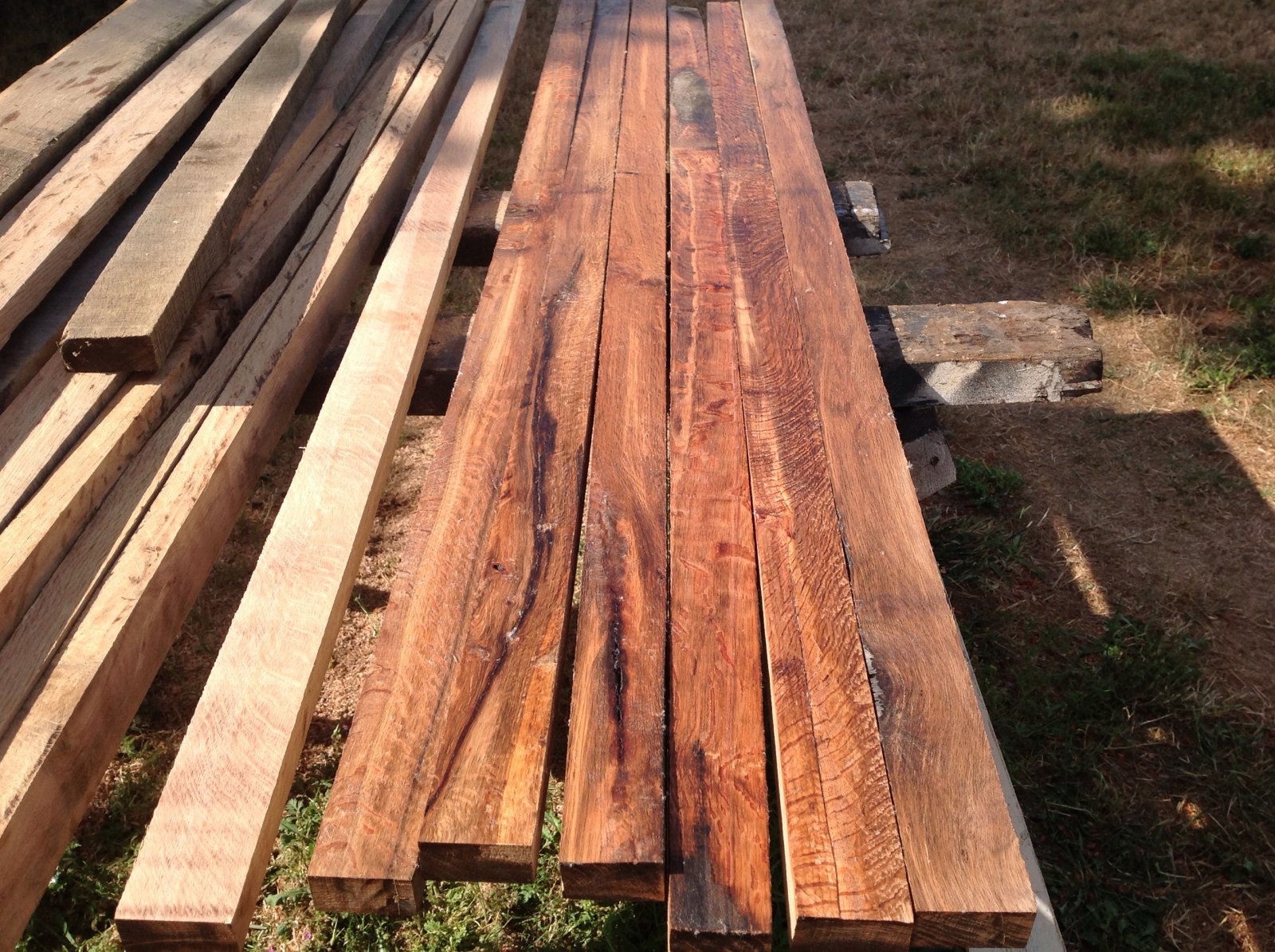

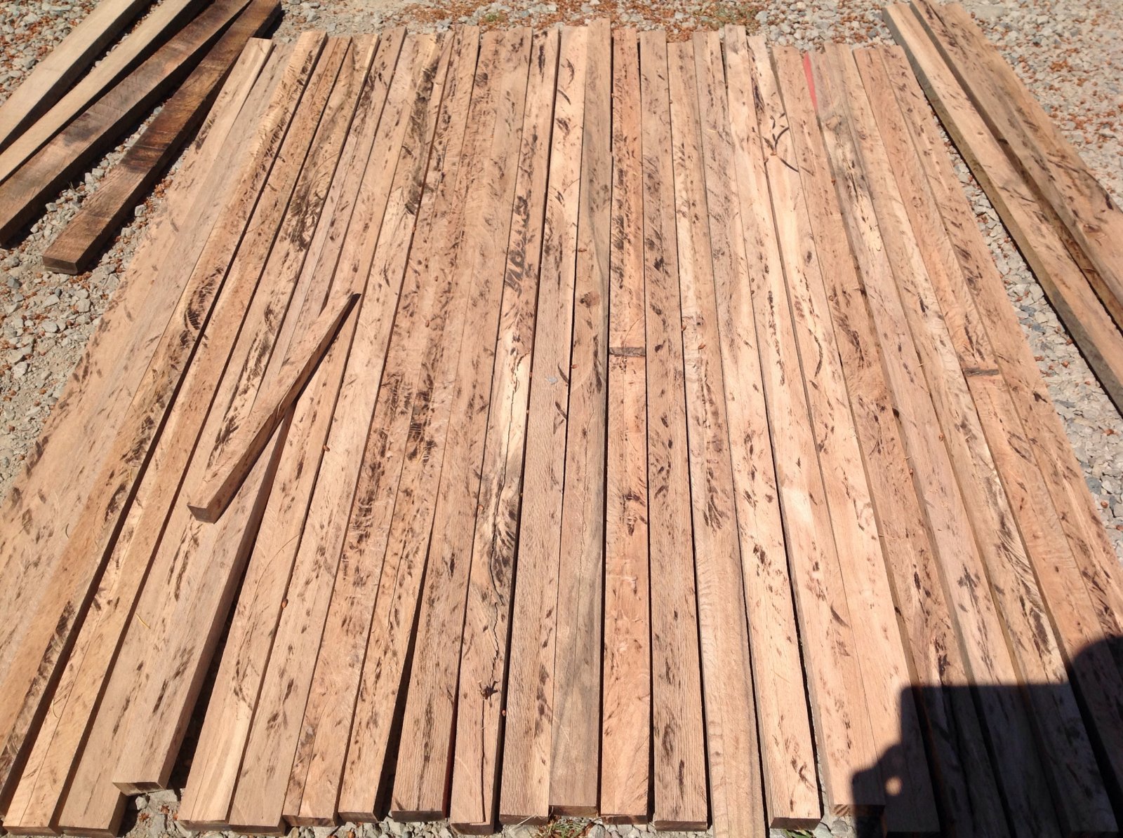

    I think I have enough wood to do the supports inside the cab and the entire floor of the box! The wood smells like walnut but who knows.

    Looks like walnut to me, pretty wood! :cool:

    It must be some kind of iron wood. Wood work tools are NOT happy cutting this stuff. And the smoke doesn't smell like walnut.

  5. ... ipe wood is walnutish and hard as hell on tools. Its great rugged stuff though. Brazilian walnut so to speak. Common enough to maybe make it to your wood stash.

    It came as dunnage between steel beams for a building. No idea of it origin. But holy crap is it hard!

    It sounds like it is similar to Apitong which is a wood from the rain forest that is very strong, used in the floor of semi trailers. It is also very hard on cutting tools because it grows so fast it draws sand into the wood as it grows. It is a very dirty wood that is similar in appearance as mahogany and if you get a sliver from it, it will get infected, so be careful, the Ipe may or may not cause similar problems.

    Must be the IPE stuff. Hard as hell, no sand, smells like walnut.
    Full day of blown electrical breakers and smoke from the saw blades. Got enough cut for the box floor and the inside the cab wood. Buddy is bringing his planner in on Monday and I can finish skimming it down.

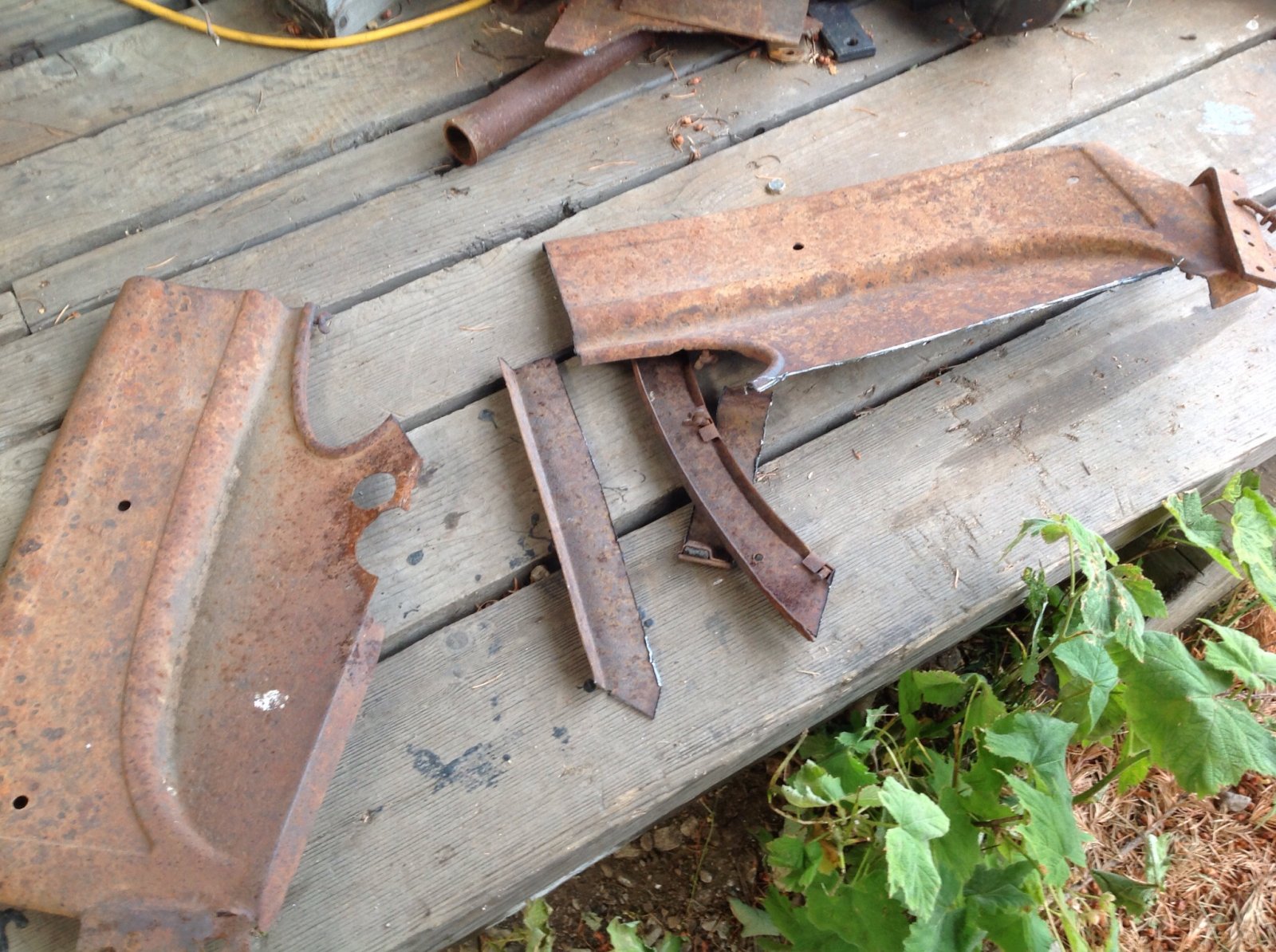

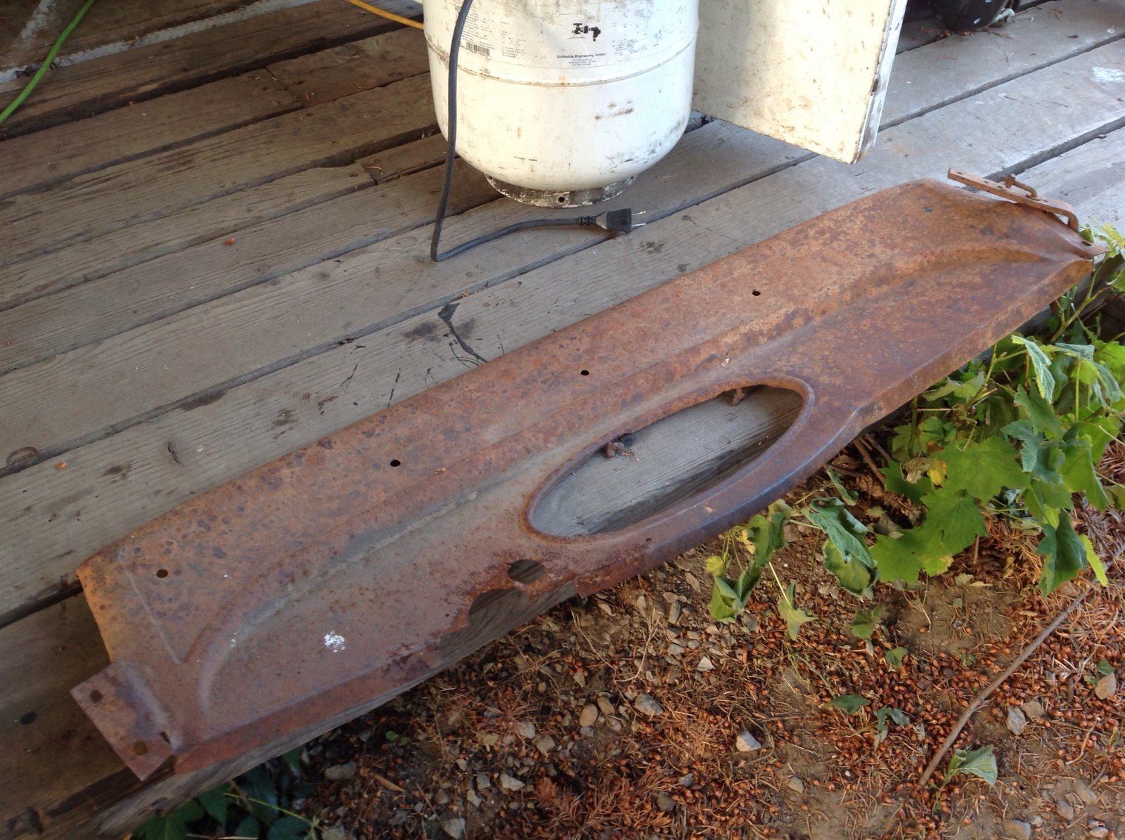

    Had enough of this wood crap for a bit and I need to get the dash in so I can fit the steering wheel and seat to the pedals.
    I don't have a 34 dash and couldn't find one I could afford. I do have a 30 something Chevy dash that I got on a trade years ago. But it wasn't quite wide enough. It was an inch and a half too narrow.
  14. dumprat
    Joined: Dec 27, 2006
    Posts: 3,485
    dumprat
    from b.c.
    But with all the bits and pieces a got when I bought the truck there was another old rusty dash which appears to be a different year but it has some of the same contours.
    DylanHill1931 and volvobrynk like this.
  15. dumprat
    Posts: 3,485
    dumprat
    from b.c.
    So I hacked it apart and tomorrow(hopefully) I can get the parts blasted and start tacking them into place. Gotta love cutting up Chevy parts to fix an old ford!

    It has been very hot here this week. Great for drinking beer and sitting by the pool, not great for building hot rods. But I have managed to get some work done. I spent several hours with a wood planner getting the box wood thinned down. It is getting there but it is super slow. I am giving up on the planner and going to run it through the milling machine. I put some linseed oil on a few pieces. It is gonna look wicked but holy is it hard! image.jpg

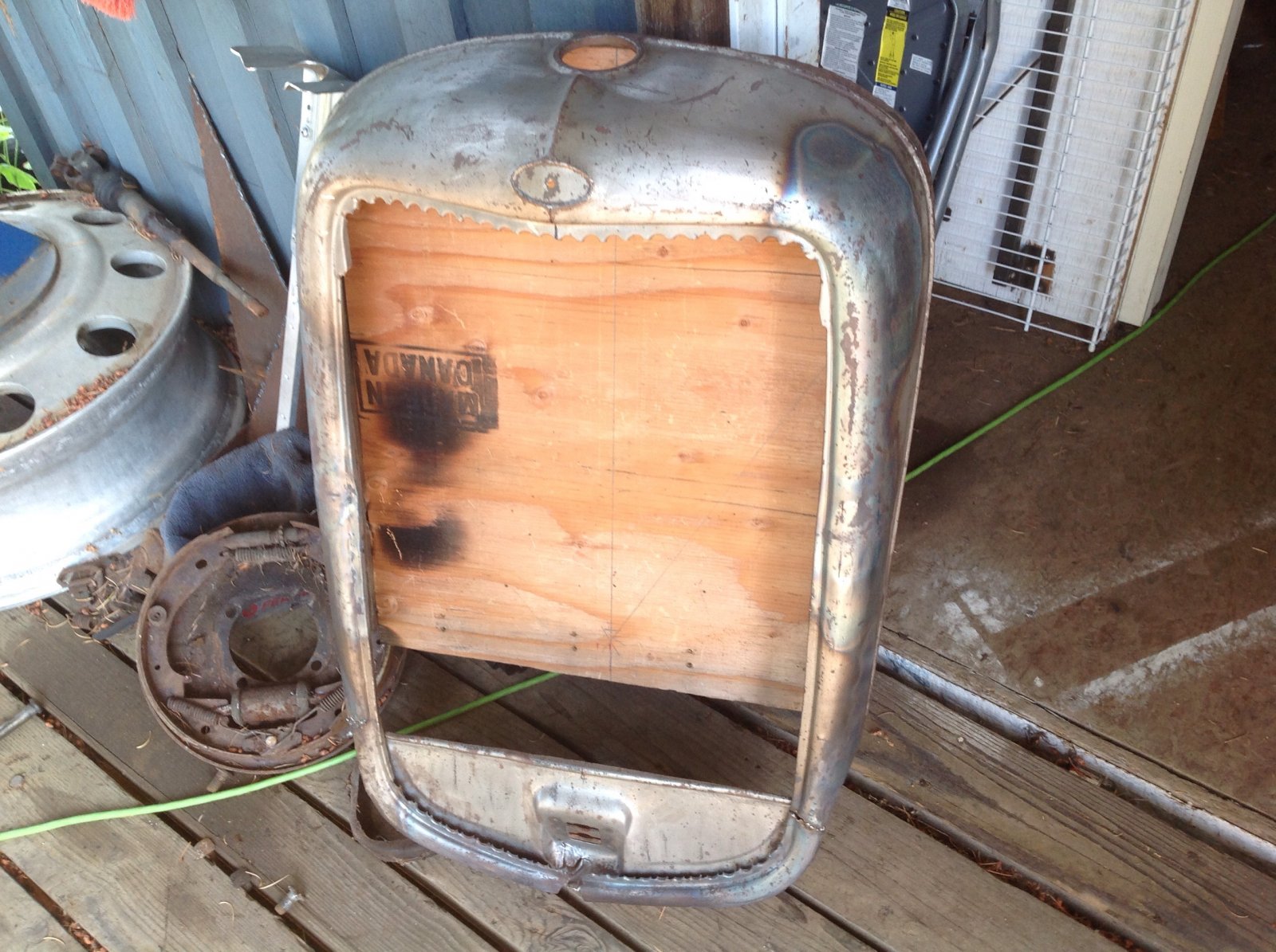

    I have also been trying to resurrect my tortured grill shell. I don't want a 32 and nobody re pops a 34. This one is a 33 but it is what I have. It was very twisted. The chin was broken off and the bars were badly bent and stretched. I cut the bars out and screwed the frame to a plywood buck to get it sort of square. The metal was not responding to the hammer and dolly, so I heated it red hot to anneal it which looks to have released some of the twists and dents too. I have a plan to replace the bars. Some of you may not like it very much, but you probably don't like the Plymouth motor either...
