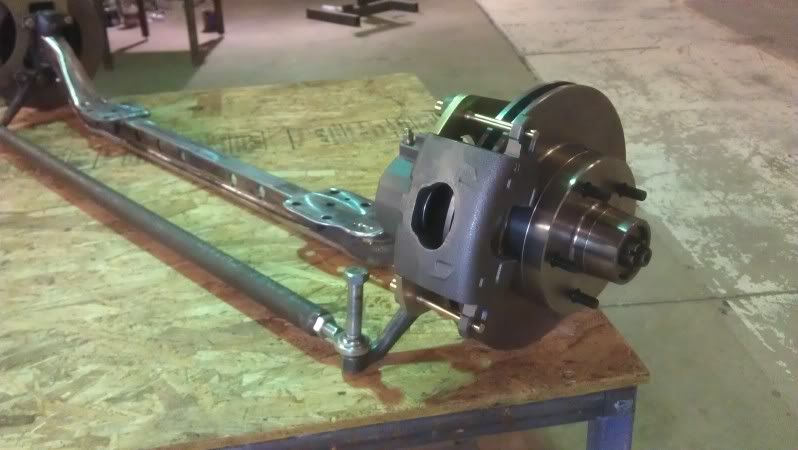

    This is our front axle. this is old skool. A 59 chevy truck axle, narrowed 7 inches, lightened and added a little caster by machining the spring perches.
    volvobrynk likes this.

    Added new king pin kits and a disk brake setup. Later on we will be doing a little lightening on the brake components.

    The steering rod may look a little large but it is 4130 Chrome Moly.
