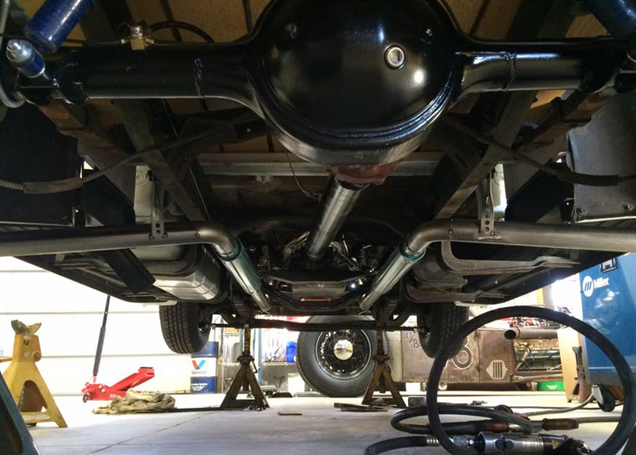

  10. Probably one of my biggest pet peeves is exhaust. I hate seeing exhaust. With that in mind Brian did his best to tuck the exhaust up under the truck and keep it hidden where it exited.
    Brian started with some mandrel bends and straight pipes.
  11. After everything was tacked together and fitted it was all pulled out, finish welded, coated, and reinstalled.
