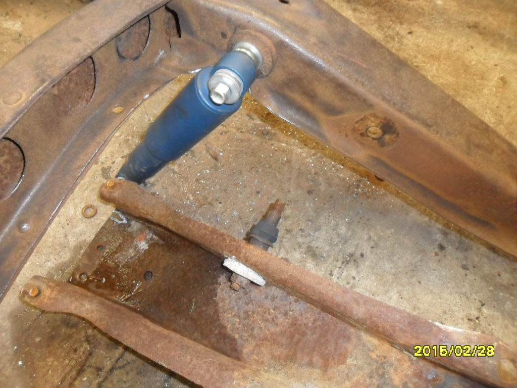

    something I noticed in the kit about the orientation of the shocks; the mount on the top is not in the same plane as the lower mount, the shock has to rotate slightly when it moves vertically. On the frame I had there was a shock mount already there, and under the shock mount was a tapered washer which prevented this twist. I salvaged those washers and used them under the shock studs in the kit to fix the alignment issue, I'll get pics tonight.
    The pic with the shock on it is the frame I'm using , it was on this frame before, the other 40 crossmember in front of it is another I have, but it had potmetal wedge/washers on both sides of the stud (these are disintegrating badly).
