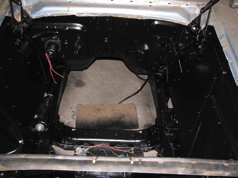

    I am building an FE powered 65 Falcon 2dr sedan currently. 390/c6 to start and then switch to a 406 i have available.
    Changed to a stock mustang II front end - all stock arms etc and an 8" rear from a 70's maverick... springs inboard 3" each side. Currently has greg weld 9.5" rims in back and 5" in front but I am probably going to run dog dish/steelies for wheels.
    hopefully will be all done this winter ready for spring.

  13. 65falcon
    Joined: Nov 4, 2009
    Posts: 35
    65falcon
    Some pics of mine - still a work in progress. The first pic is how it was when I got it. It is now about 3-4" lower in back and 4-5" lower in front. 275 tire in back and 135 in front. It has a new floor and subframe connectors as well now.
    I am doing it super budget....Calling it a "recession rod". I am into it now for about $2800 complete.
