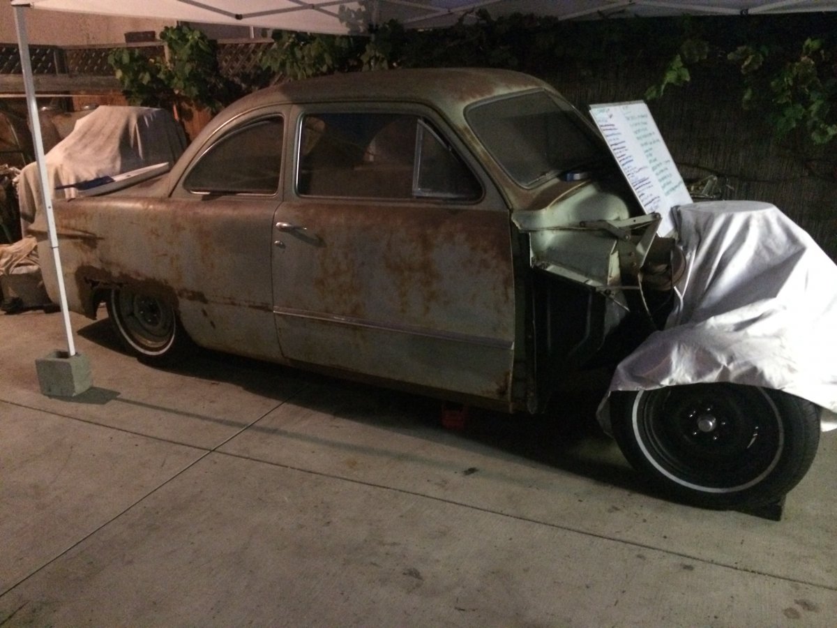

    So here goes my build of this fine 49 club coupe. I bought it from an older fellow down here is SoCal who accepted the fact that at age 75 he wouldn't be able to build it. He brought it down from Colorado but it originally came from the territory of Alaska and gave me copies of the original title, pretty cool.. Only request he had is not to chop it, so no chop here. This box is all original, never repainted, personally I dig cars wearing their original threads sort of speak so no paint here either. Some hate the work patina so i'll say naturally weather exterior, all real rot will be fixed, and to boot it will be ford powered (the drive train was gone).

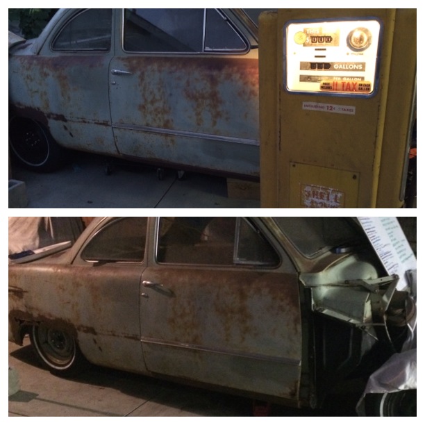

    So picked up and then at my place. Also this 63 fairlane donated its drivetrain to the box (SBF, C4 and 8 inch rear) Photo Jul 22, 2 53 36 PM.jpg Photo Jul 22, 6 46 10 PM.jpg Photo Jun 25, 3 43 23 PM.jpg

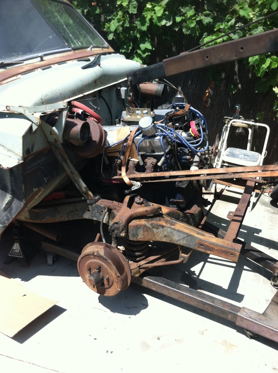

    Photo Jul 25, 3 07 51 PM.jpg First up, pull the front end apart and get the frame ready for a front sump pan. Also here is the donor drivetrain from the Fairlane. I kinda set the engine in to mark where the frame would be cut for the pan. Photo Aug 17, 12 32 48 PM.jpg Photo Jul 26, 11 16 20 AM.jpg Photo Aug 17, 12 32 56 PM.jpg

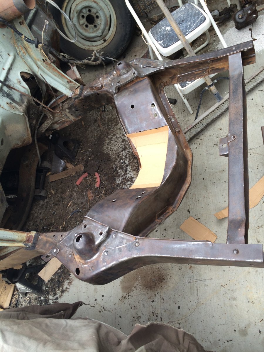

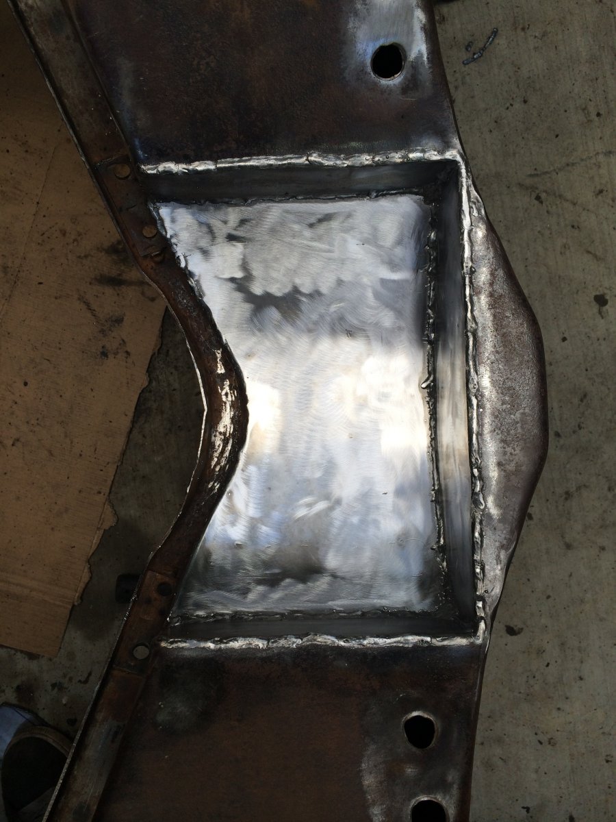

    So I marked the frame and used my handy plasma cuter and cut the section out. Then I made a cardboard template and boxed in the section of the frame. No turning back now! Before welding I cleaned the whole front section of the frame mostly with wire wheels and wire brushes, the agony! Photo Aug 04, 4 52 08 PM.jpg Photo Aug 04, 4 55 11 PM.jpg Photo Aug 04, 4 55 21 PM.jpg Photo Aug 04, 4 55 40 PM.jpg

    Took the template, cut the pieces with the PC, tacked into place, welded up, cleaned up (not perfectly on purpose) and POR 15'd the front of he frame. Photo Aug 05, 5 39 21 PM.jpg Photo Aug 05, 5 39 27 PM.jpg Photo Aug 05, 5 39 30 PM.jpg Photo Aug 05, 5 39 45 PM.jpg Photo Aug 05, 6 52 25 PM.jpg Photo Aug 05, 6 52 32 PM.jpg Photo Aug 05, 6 52 41 PM.jpg Photo Aug 05, 6 52 48 PM.jpg

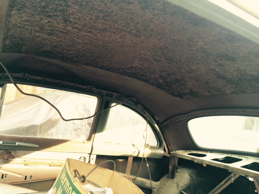

    Next was stripping the interior, removing all the glass and the starting rust repair on the floors and rockers. I dont have many fabricating tools like a brake or bead roller, most of the shaping is just beating the metal on a vise or bench tops. Photo Dec 07, 1 38 14 PM.jpg Photo Dec 07, 1 38 32 PM.jpg Photo Dec 07, 3 09 42 PM.jpg Photo Dec 07, 3 09 47 PM.jpg Photo Dec 07, 3 09 52 PM.jpg Photo Dec 07, 3 10 01 PM.jpg Photo Dec 07, 3 10 08 PM.jpg Photo Dec 07, 3 10 13 PM.jpg Photo Dec 26, 4 45 01 PM.jpg

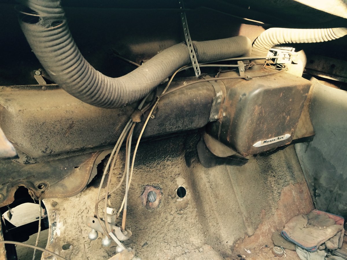

    Removing the factory tar insulation was the worst, next time I'll pay someone to that job! Heat gun, scrapper, SOS pads and WD40 to get that crud off. Photo Feb 04, 4 02 41 PM.jpg Photo Feb 04, 4 02 58 PM.jpg Photo Feb 04, 4 03 04 PM.jpg Photo Feb 04, 5 56 22 PM.jpg

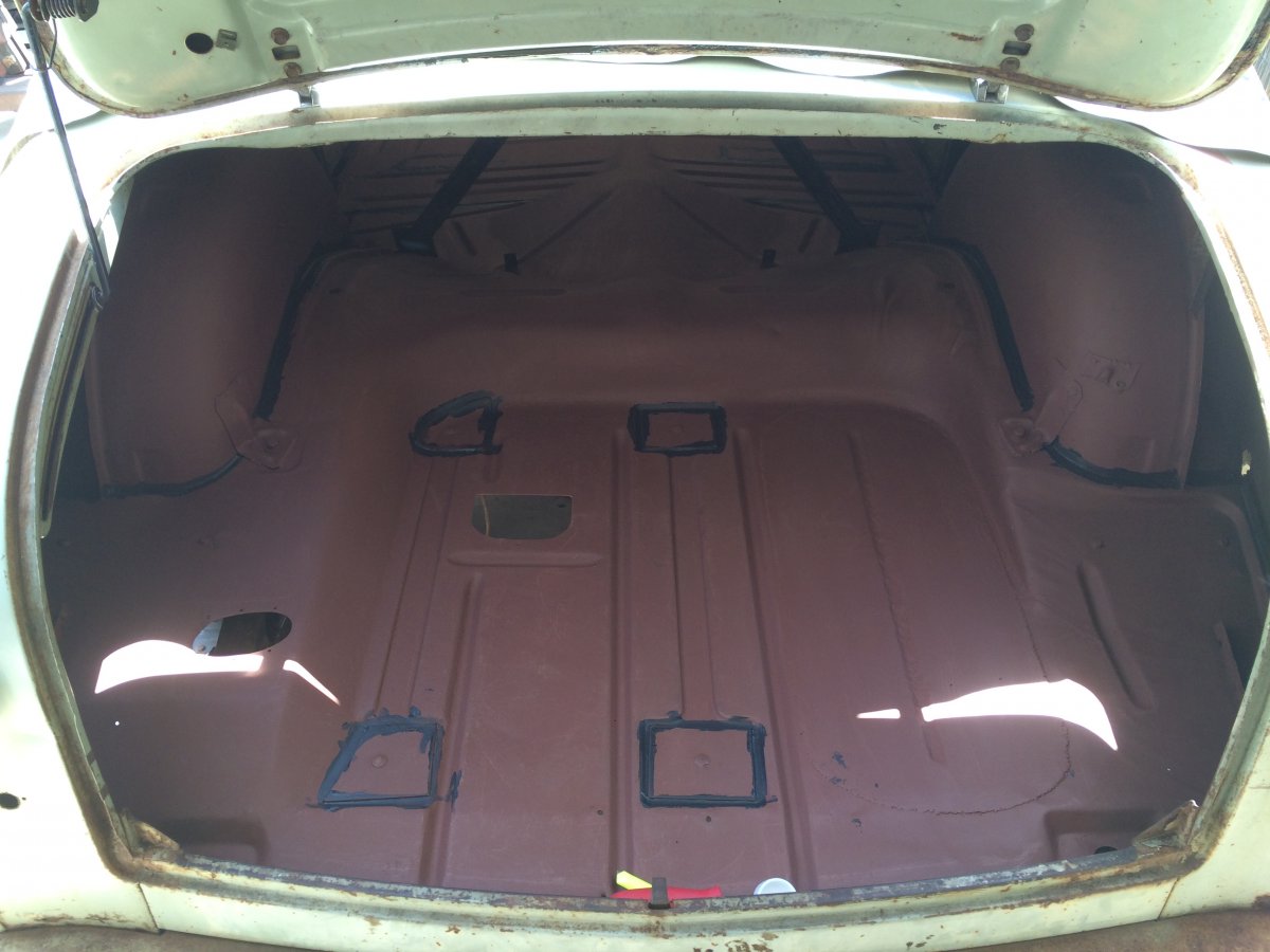

    Once its was all patched up and cleaned up I primed the floor. I also got rid of the spare tire hump, wasn't digging Photo Mar 10, 2 25 51 PM.jpg Photo Mar 10, 2 25 58 PM.jpg Photo Mar 10, 3 12 01 PM.jpg Photo Feb 03, 3 08 37 PM.jpg Photo Feb 03, 3 09 00 PM.jpg Photo Feb 03, 5 45 27 PM.jpg Photo Mar 06, 4 36 42 PM.jpg Photo Mar 10, 4 23 48 PM.jpg Photo Mar 17, 10 17 39 PM.jpg Photo Mar 11, 8 59 20 AM.jpg it..

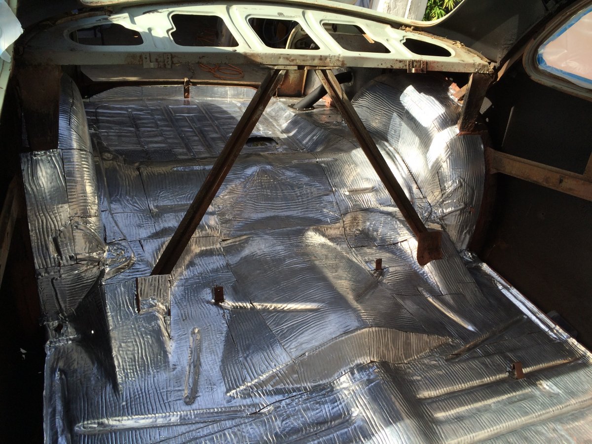

    Next up was the dynamat, another PITA!! Photo Apr 14, 5 41 24 PM.jpg Photo Apr 26, 4 45 00 PM.jpg Photo Apr 26, 4 45 08 PM.jpg Photo Apr 26, 4 45 20 PM.jpg Photo Apr 26, 4 45 37 PM.jpg Photo Apr 02, 1 40 20 PM.jpg Photo Apr 02, 6 50 10 PM.jpg
