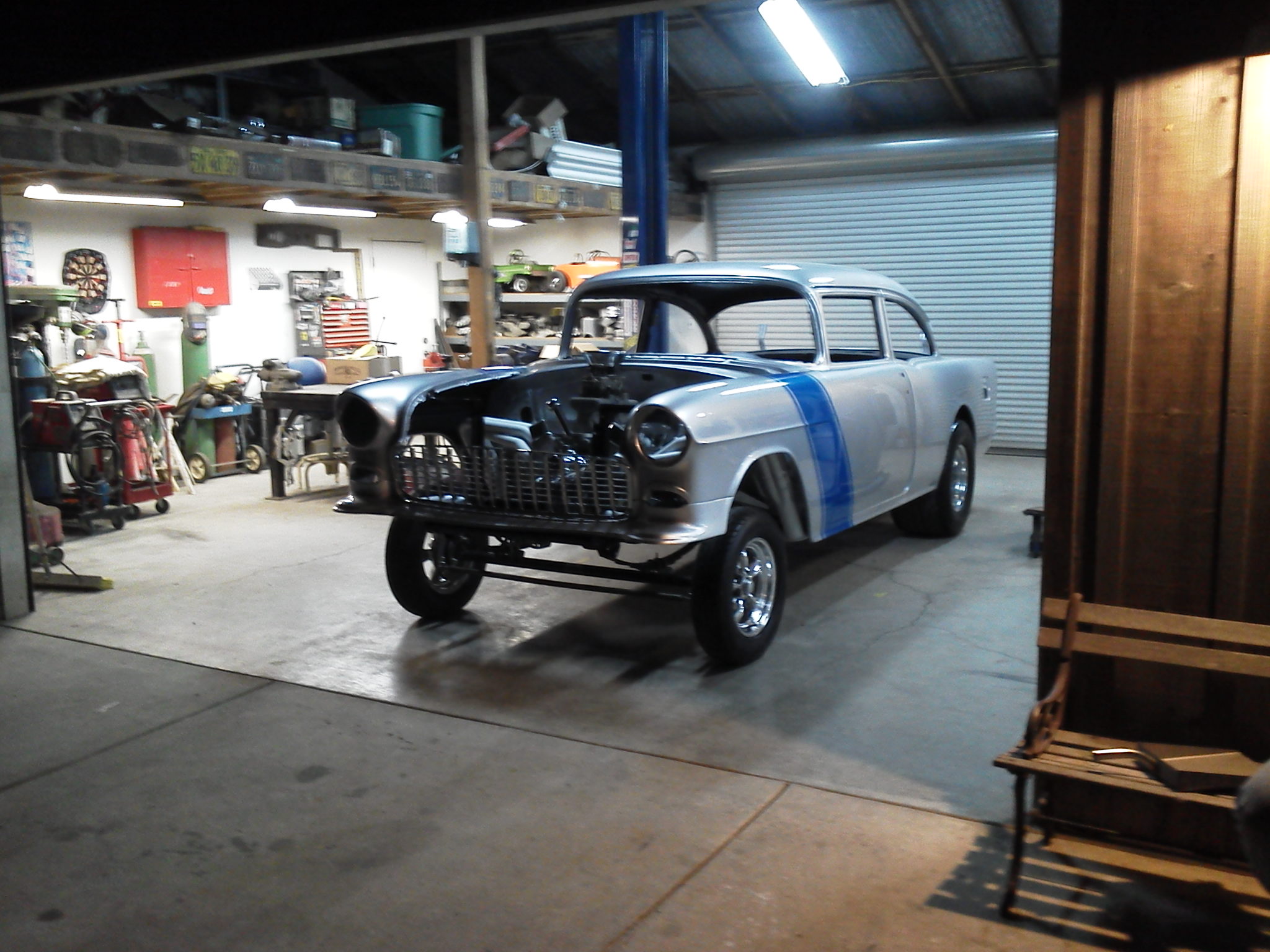

  27. Here's a couple pics to flush out that last bit of negativety IMG_20131010_210615.jpg
