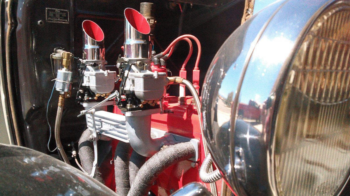

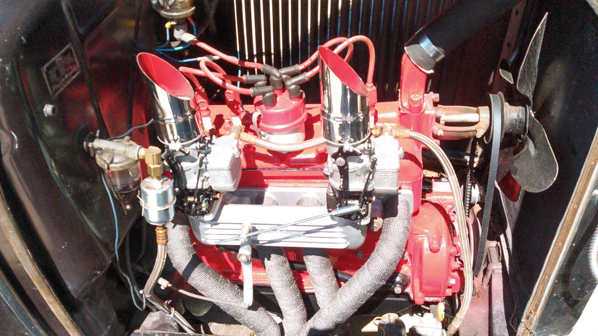

  22. Well... Got the carbs finished, Put a low pressure carter fuel pump and Malpassi Filter King (Filter/Fuel Pressure Regulator) on, re-routed the fuel lines. That MSD Link for the old Mallory parts does work. I did get the dizzy cap from them. The old setup was a Holley red pump and regulator. The only thing I changed on the carb rebuild was ditching the adjustable jets and installed the stock 0.48 size jets. It now starts and idles fine as it did before. But it still falls on it's face under load. It acts like it's running out of fuel. Just dies off at the top end of 2nd gear and nothing in 3rd. Takes a while to get it started after that. When in Neutral looking down the carbs, fuel is spitting out of the emmulsion tubes. I know this is bordering on Stromberg troubleshooting/advice. Should I jet these things down? If so, how far? AM I chasing my tail and looking at the wrong thing? Could my problem be timing related? Anyway here are A couple of pics of it all together now, taken before the fuel line rerouting and new cap (painted black) KIMG0222.jpg KIMG0217.jpg
    jangleguy likes this.

    you have done more work . looks good , but I'm distracted by the front cross member & water pump . no offense . what head is on it ? ............ steve

  26. Can't find any markings at all on the head. I am just going by a list scribbled by the previous owner's Uncle who put it together initially with mods/parts installed. On the crossmember and water pump, I'll get to those sooner or later. They are a bit of an eyesore now.
