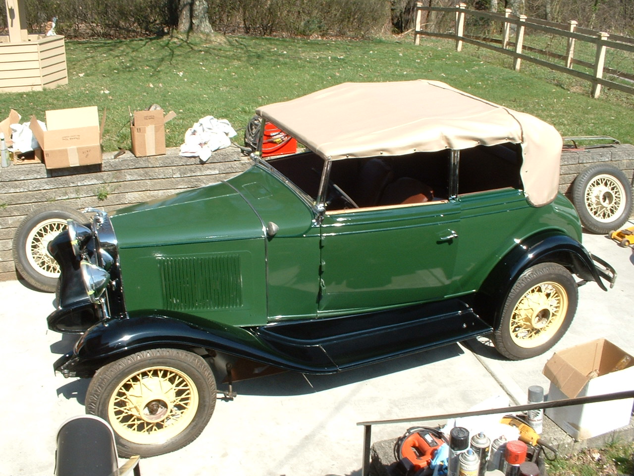

    I used the Restoration Paint, Enamel, on a 31 Chevy I have, decided to keep it stock. The colors are as close to the factory colors as they can get. They are easy to use, easy to mix and easy to lay down. Cleaning the gun was a different story but that was my fault on not knowing what was the best solvent.
