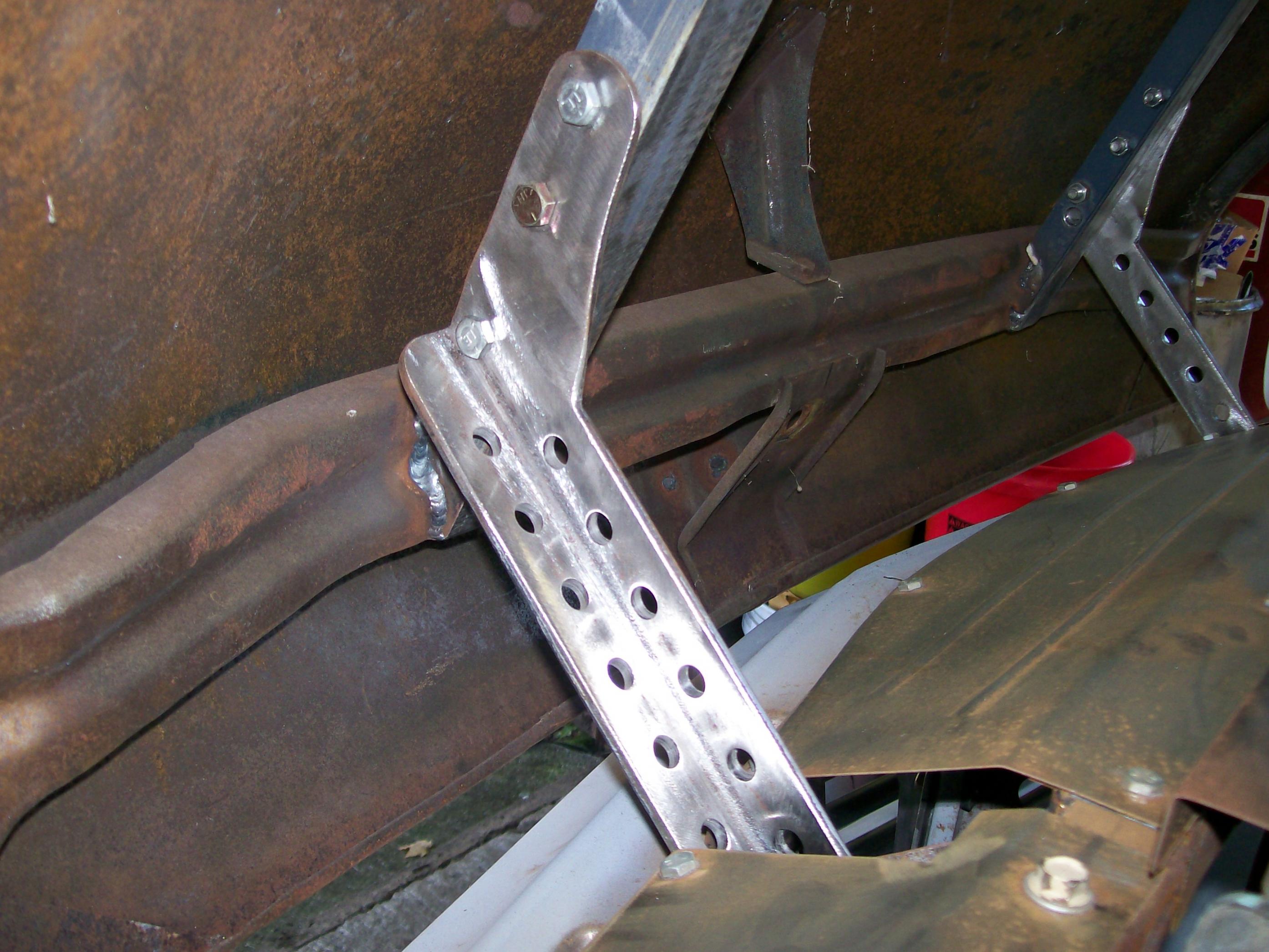

    i am in the process of redoing a 54 Ford crestline victoria into a custom rod and i have fabricated a reverse opening hood on a electric lift actuator, took some engineering to clear the grill suround while lifting but worked it out and it works great

  11. Do you have any larger pics? Or any of the hinge/ latch parts?
    How did you go about it back in the day?
