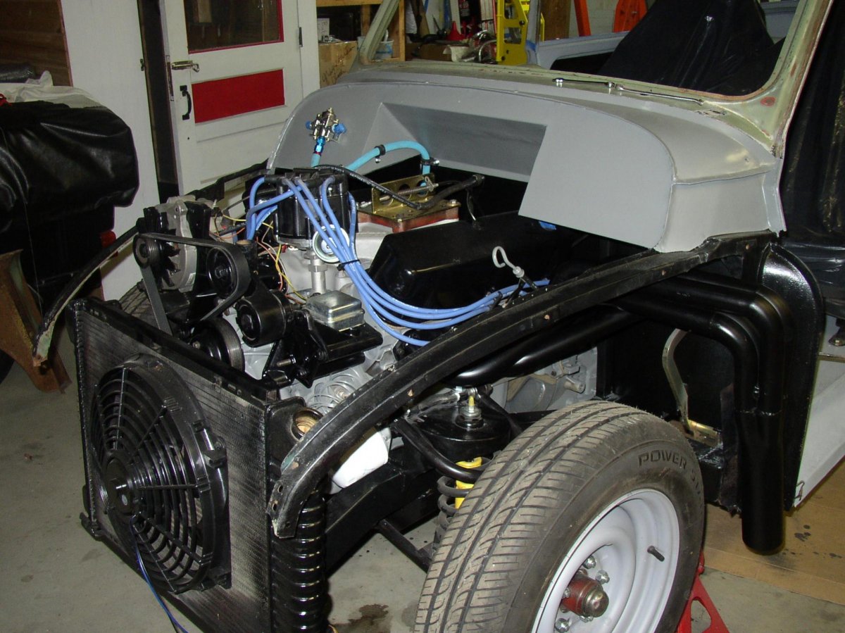

  25. Blue One
    Joined: Feb 6, 2010
    Posts: 11,462
    Blue One
    from Alberta
    All this talk of tiny little furrin and domestic engines has me thinking along the lines of actor Paul Gross in the movie Gunless. "What's wrong with these people" :D
    I prefer a good old American V8 to make the little Morris perform like a hot rod. Like the build I posted early on in the thread. :cool:
    chessterd5 likes this.
