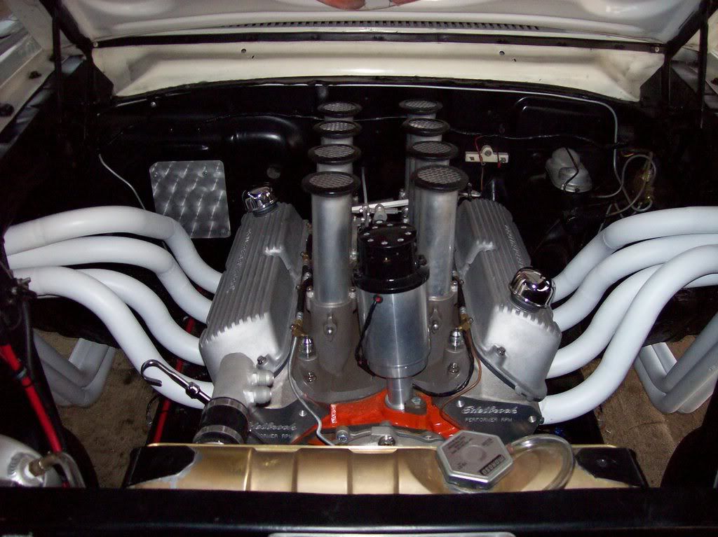

    Heres the engine I built for it..........327 bored 30 over (331 cubic inch) venolia 13.5 to 1 pistons,steel crank, h-beam rods, ported and polished fuelie heads,under cut racing valves, solid lifter camshaft, windage tray, the intake is a edelbrock cross ram that will have 660 center squirters bolted to it, ronco magneto

    The 65 comet I built dales talking about......
    [​IMG] [​IMG] [​IMG]
