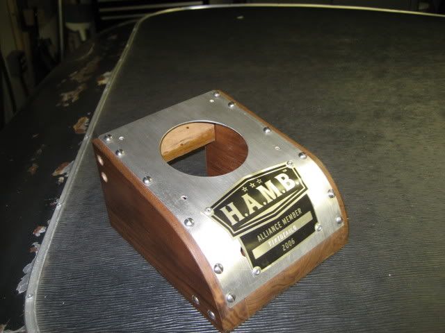

    Now to my update. Needed a stylish cup holder for morning coffee.
    1. Used a old aluminum plate that already had all the holes punched out. I used some steelwool to give it a linear sanded look , gave it a curve and traced the profile to some scap wood I had laying around.
    2. Cut it on the bandsaw and used this shape to cut a second piece of wood.
    3. Clamped the wood together and sanded the curved shape so both pieces would be identical.
    4. I cut two more pieces of 1x2 wood and made the front and back pieces to join the cuved side panels. I pre-drilled and countersunk my holes fo a more finise look and as not to split the hardwood.
    5.Next I layed the aluminum pre punched and shaped face panel on top of the wood open face "box" and predrilled some hole to attatch the aluminum to the wood. I would have used different spacing but some of the holes were already made so I made it work.
    6. When I bought my coupe it had a couple of boxes of OLD screws in the trunk, so I thought I'd save them for something one day. Round head slot screws would look perfect, so I used them.
    7. Lastly I has some extra holes that were on the curved part of the alum panel that I needed to cover up. Perfect spot for my old Hamb tag. Doesn't cover them all exacly but does a good job. gave the wood a quick coat of satin spray laquer and all done.
    This took about 30 minutes to make so I didn't get any pics during, but the end result is pretty self explanitory.

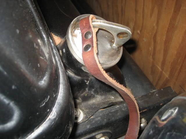

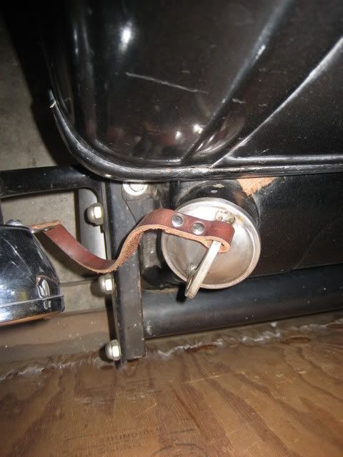

    Next on the list was my repop gas cap for my '32 tank. It is smooth around the edge and seemed to leak alot. I solved the leaking by adding a thicker cork gasket, but the added thickness of the new gasket made twisting the cap off difficult. I'd have to wrestle with it at the gas pump sometimes and this circus act got old after awhile.
    I cut up a small exhaust flange I had and welded it to the cap. Since I had sanded the spots where I was going to weld, I hit the whole cap with sand paper to give it that machined look.
    2. I used a leftover strap of leather I had from my hood straps and riveted it to the cap. The other end was riveted to a thin piece of sheetmetal with three holes drilled into it. Two were for the rivets and the third was so I could attatch it to my rear brake light. I pulled the screw out of the housing , slipped through the sheet metal tab and back into the housing.
    I shouldn't lose my cap now(not that I ever did) but more importantly I have something to torque on to get the cap on and off.

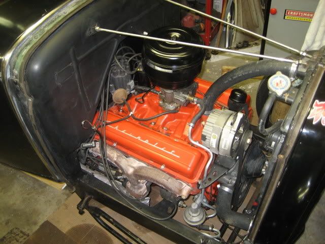

    Lastly I modified an old oil bath air cleaner with a modern paper filter to the belly button motor.
