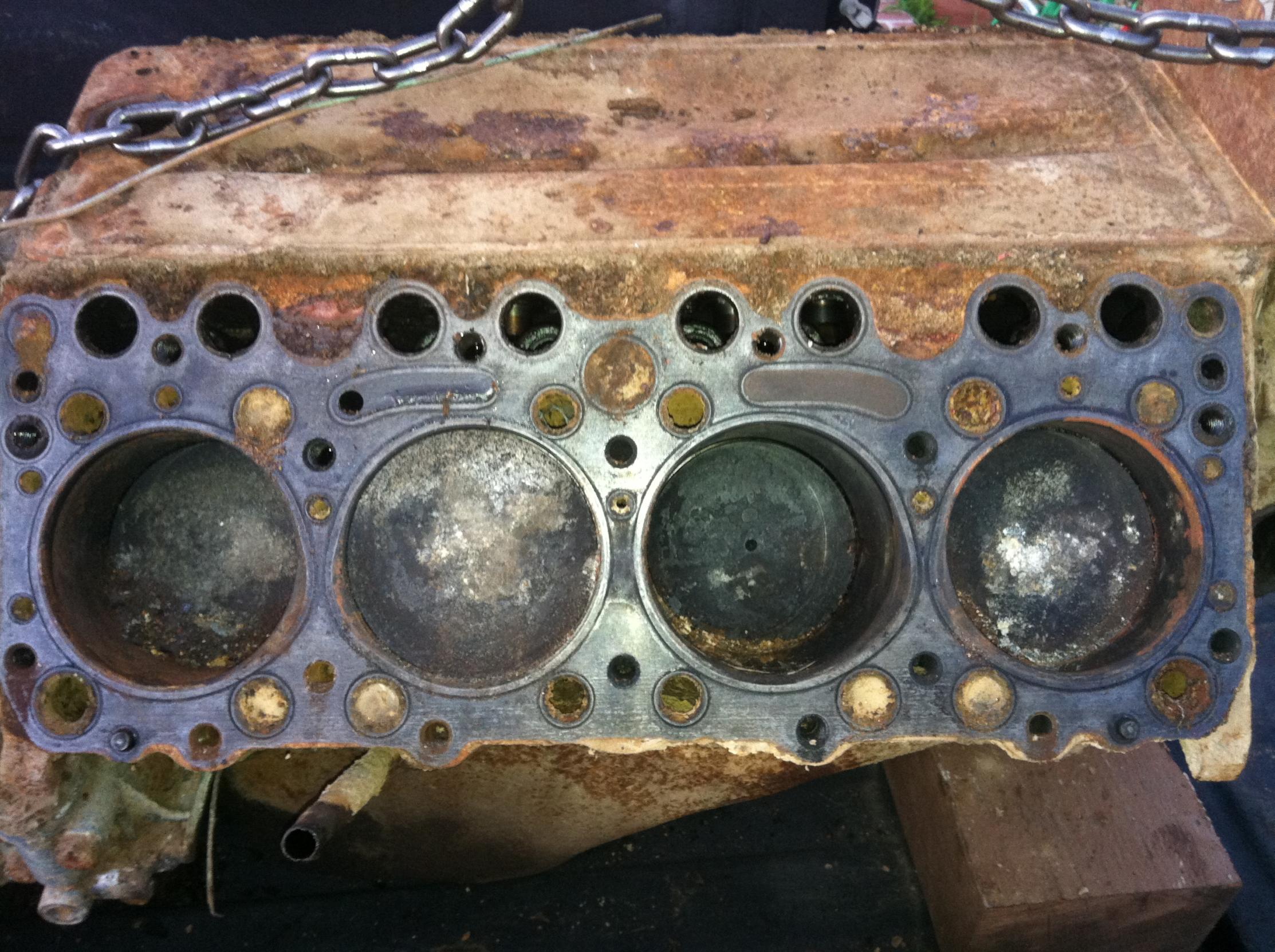

    Well... I'm not real enthusiastic right now. I just spent the whole day going to retrieve the 56 324 from another HAMB member down south. Paid him $300 bucks for the motor. Has been sitting under the hood of the original car for many years, with the air cleaner and everything intact. Thought it was a good bet that the block would be clean inside. Pulled the heads about an hour ago and nearly shit myself. No wonder it wasn't turning over. I was hoping that if the block turned out to be bad that at least I could salvage and sell the #10 heads and recoup my money. I'm doubting that now but would like opinions from those of you who've been around the block a few more times than me. I haven't mic'd the bores yet. They look worse than my other block. At this point, if it looks like they've never been cut, maybe they can go a full .125 over and be clean. I'm scared the heads might be bad too. Valves/combustion chambers look pretty rusty. I wonder if they can be decked slightly to clean up? Tomorrow I'll try to get it clean enough to turn over so that I can remove the slant-pan hydro that's still attached. BTW... Slant pan hydramatic vs. earlier hydramatic? Any appreciable benefit one vs. the other? I just hope to God that if this stuff is all junk that the guy is honest and refunds my money. I can't afford $300 bucks down the toilet not to mention five hours worth of gas in my truck...

    Unless I'm missing something... This looks like a typical core engine
    You've seen some of my tricked out powerplants....this is how they start out
    Tony

    well that makes me feel a lot better... I'll stay positive. Once I get the trans removed I'll tear it down and take everything to the machinist.
    fingers crossed.

    I agree. Don't worry, ...yet.
    My 56 block had broken a rod years ago, and left a divot in one bore on a 60,000 mile motor. I used a bore gauge to try to measure the depth of the divot; and it was about 13 thou, I thought. The now owner of it, sent it for machining, and it cleaned fine at .030 over.
    You probably will need to try to remove the rod and main caps to get the trans off with the crank still attached to the trans. Or try to free the pistons, but that looks iffy.

    If it's any condolence, I've busted apart a couple dozen early Olds engines over the years... and they all looked just like that, except for a couple old race engines that were garage-kept. These engines just need to be completely built from the ground up. You're dealing with junk that's over 50 years old now....
