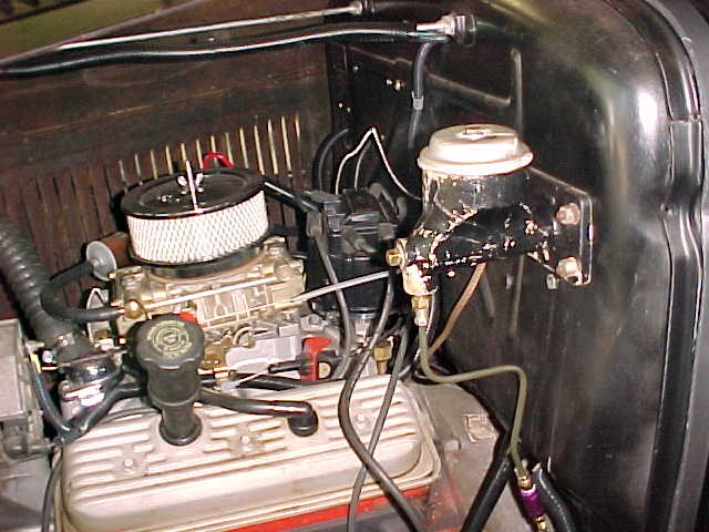

    Fenders
    All my rods (both of them !!) have used a single fruit jar MC. First was an earlry Mustang, the current one in the photo is even earlier a 1955 Desoto MC.
    Don't give me no shit.
