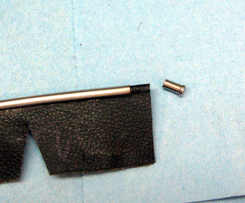

    Lowcoe suggested making some inserts to put in the raw ends of the stainless welting so I gave it a try.

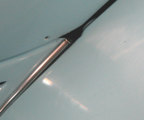

    Two of the problems we were having with the welting are shown here. The end was butt ugly and we could not get the welting to stay tucked in between the panels.
    I chucked 1/4"x 4" stainless bolt in the old lathe and cut some plugs to roughly the dimensions shown here. It is not to critical to get them dead on as we will be gluing them in the slot later anyway.
    I did a little file and sand paper work before buffing the ends of the plugs. This tap holder worked well for holding those little plugs for polishing.
    The welting slides inside the stainless so I pulled about a 1/2" out of the top of the stainless.
    Then I cut just the cord part of the welting off and then pulled the welting back into the stainless making a socket for the plug to git into.

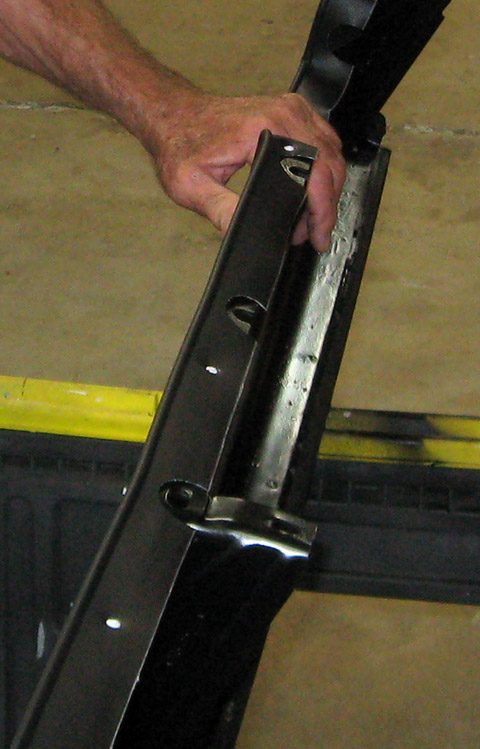

    To fix the problem of the welting popping out of it's slot between the fender and grill panels we added a piece of welting to each side of the welting tab. We glued theses pieces on but decided to staple the pieces together on the next set. This works much better. You can see the plug inserted into the end of the welting here.
    This is the result of Lowcoe's suggestion. I think it is great idea ! Thanks Lowcoe!

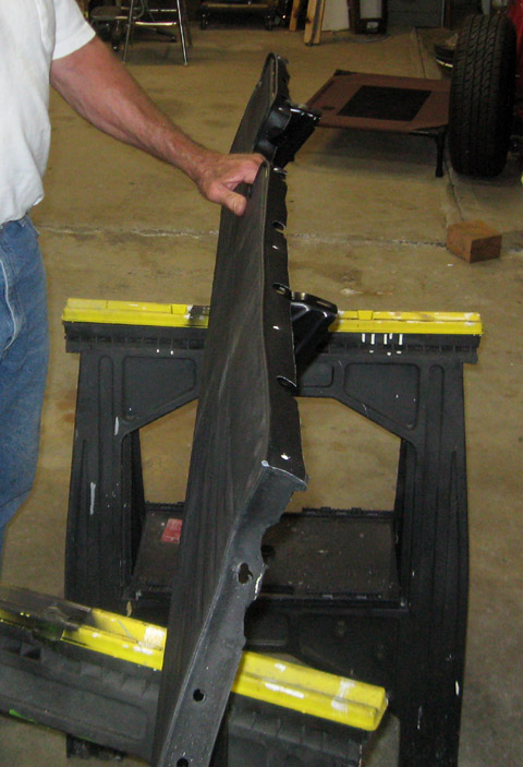

    We spent quite a few more hours fine tuning the fit of the hood and fenders before installing the bumper. Don in his usual we way mulled over the fit problem and decided we needed to spread the V shaped support bar we had modified earlier in the project to clear the crank pulley. We used the hydraulic press to bend that heavy 1/2" round stock I had welded in there. It took a couple of tries to get it adjusted just right. Now no shims are needed between the support bar and the inner fenders and every thing seems to fit well.

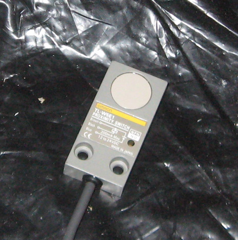

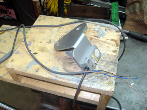

    Here is another project we did last week. I decided I wanted to have some sort of neutral safety switch on this car. After considering several options we decided to get the signal from the clutch pedal rather than the shift linkage.
    We decided to install a proximity switch. In other words the switch does not have to make contact with the pedal but the normally open switch closes when a ferrus metal object (the clutch pedal) passes within 5 MM of the switch.
    We found a OMRON TL-W5E1 NPN switch in the Mc Master Catalog for about $90.00 . Yes it is kind of expensive.......... I hope it works. We wired it into the relay that operates the stock 40 starter button.
    The switch
    The following is the spec sheet from the manufacturer.

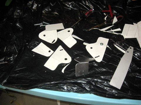

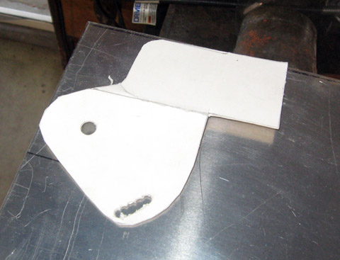

    As usual I started the project by making a cardboard pattern to try out my theories.
    A few hours and several cardboard patterns later the design was finalized.

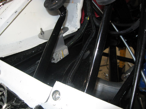

    The mounting braacket was made from 1/8" aluminum. I decided to paint the aluminum with silver caliper paint.

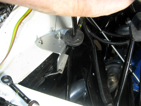

    Installed with the pedal in the up position.

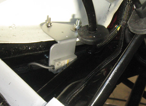

    Installed with the clutch pedal depressed. I bolted the bracket to the front body cowl bolt. The 10-24 bolt on the other end of the bracket allow for a small amount of adjustment for the proximity sensor.
    A quick test indicates the switch works. We will have to test it some more though once the car's rear axle is supported on jack stands and we can check test the clutch adjustment.
