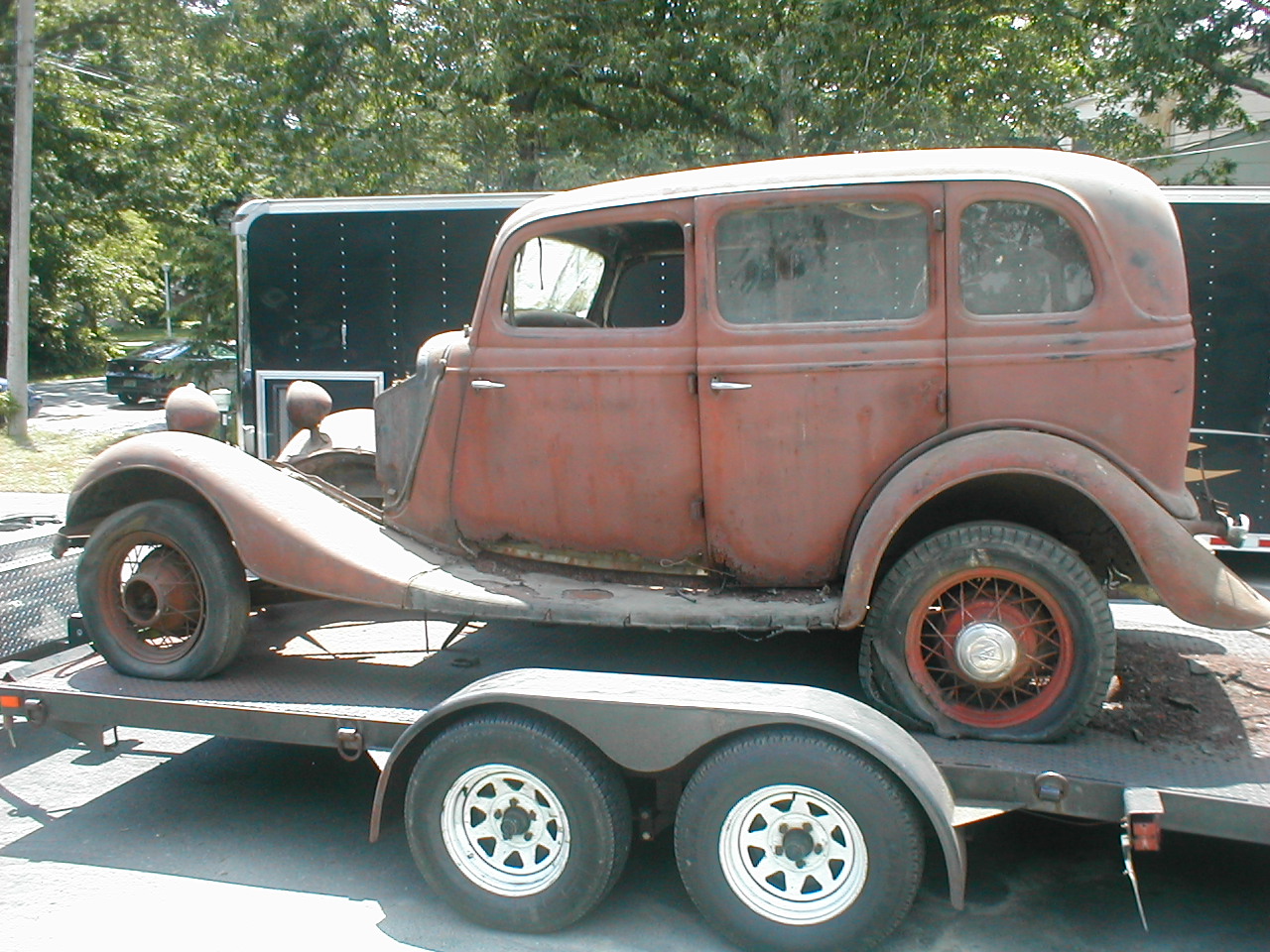

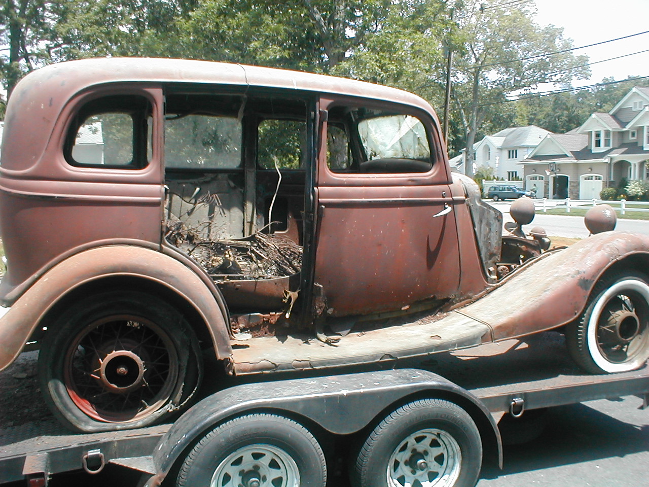

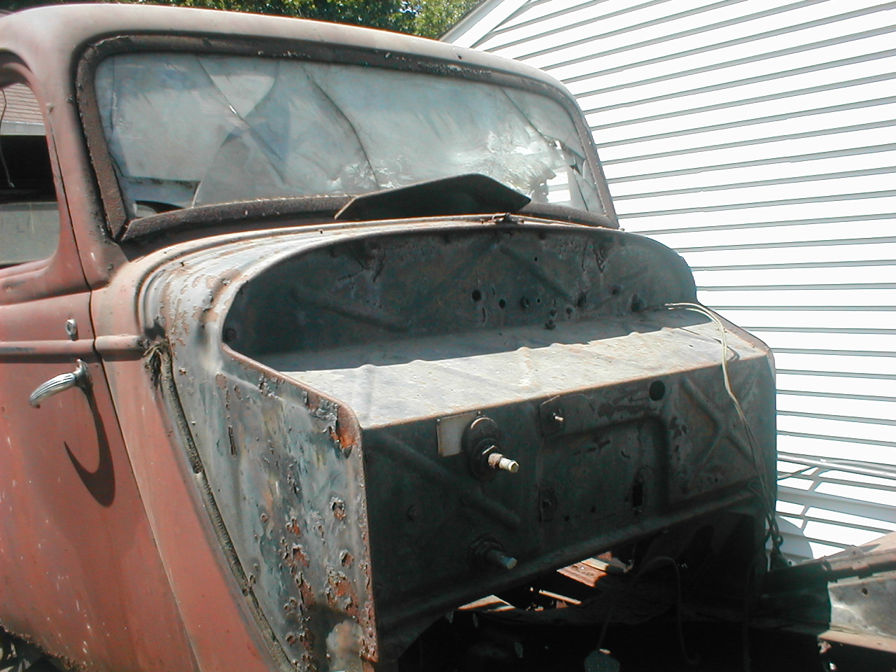

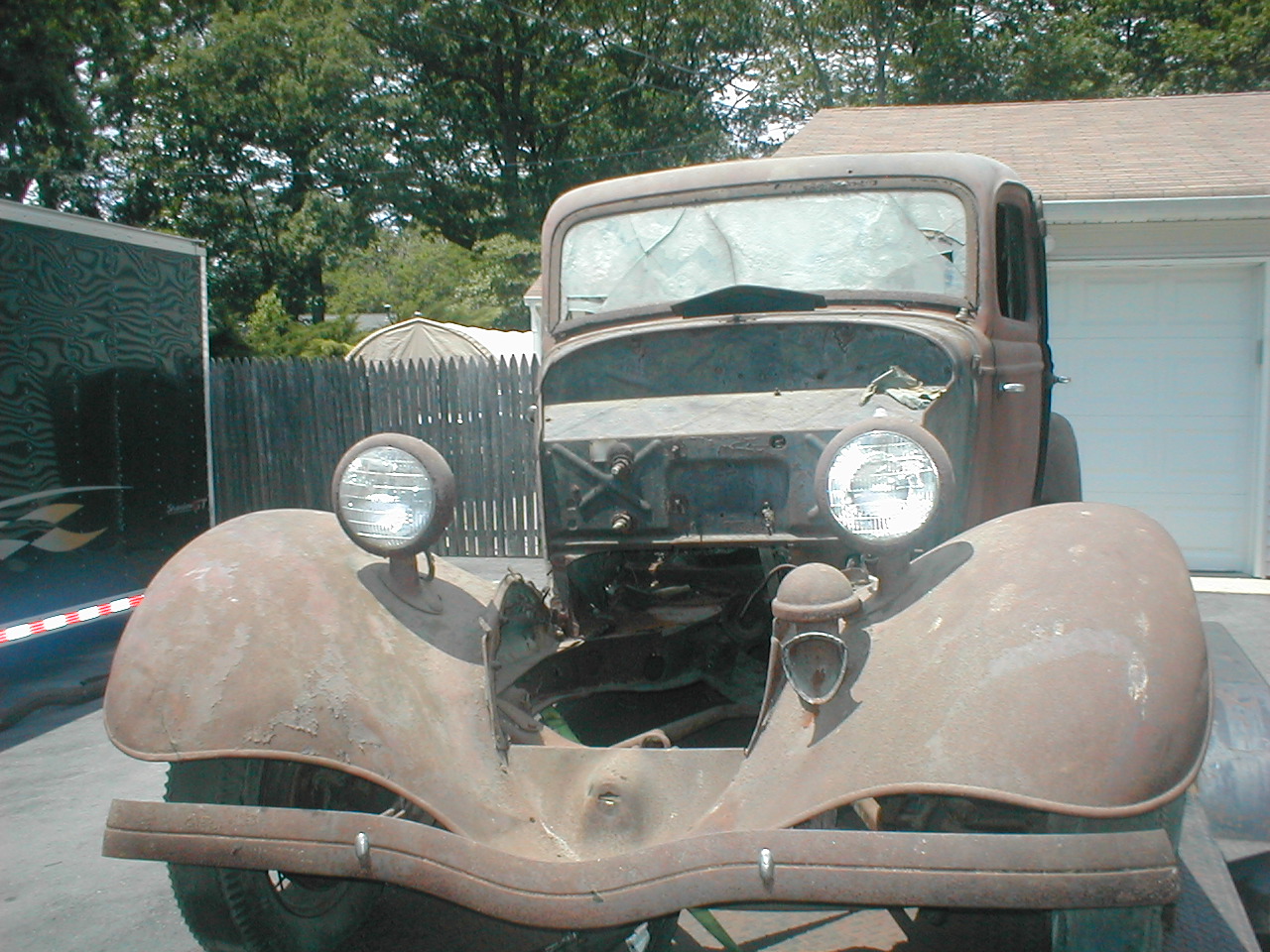

    Well, here's the pics I promised...Just got it home today..

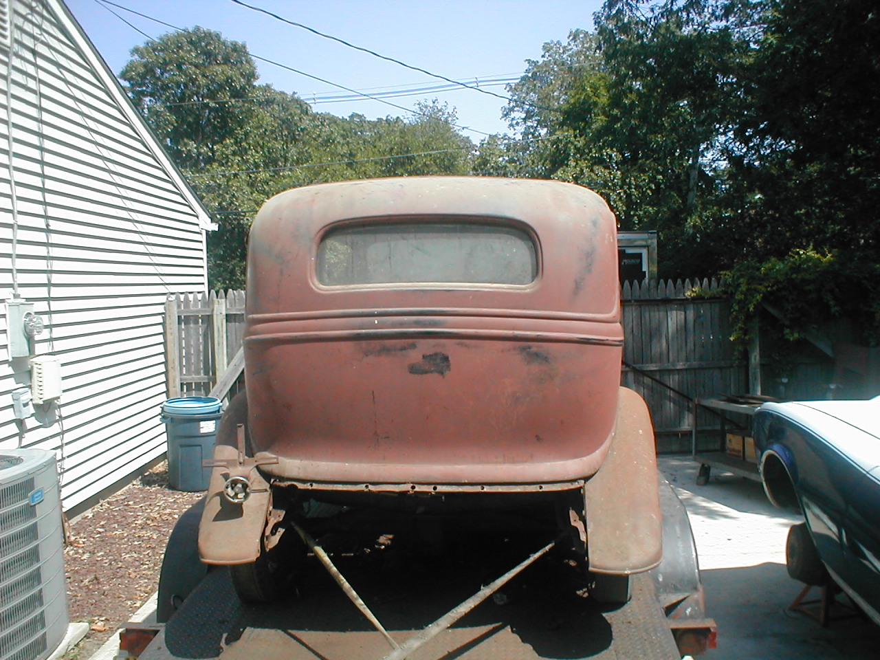

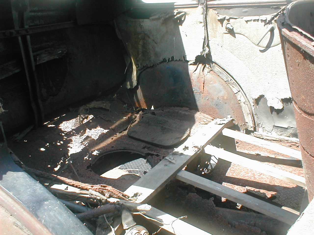

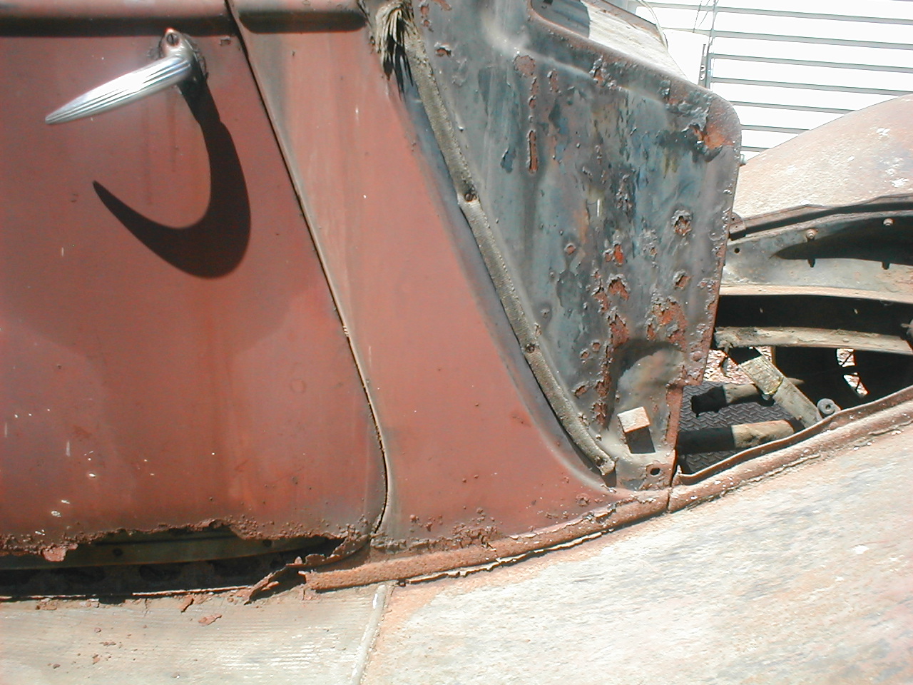

    a few more shots.

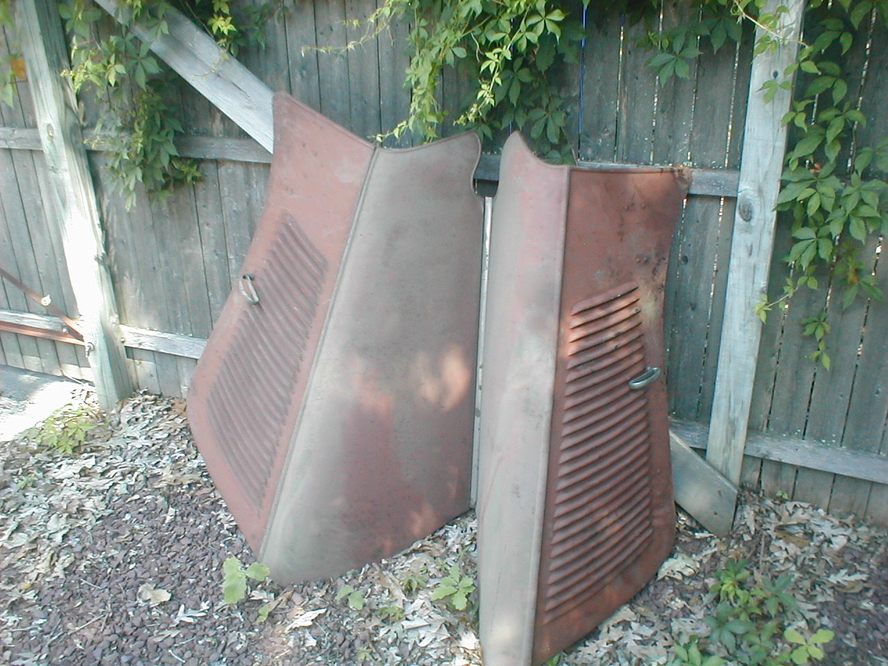

    Once I got all the junk cleaned out,it's not as bad as I first thought..Needs floors,subs and rockers but the rest ain't bad.. It didn't have the door or grille but the hood is really nice..The old timer took the steering column for another 33' Sedan he's working on..
    I'll get her off the trailer tomorrow and get a closer look at the frame..I think it has some heavy pitting where the boards were bolted to it,but overall I think it's useable..

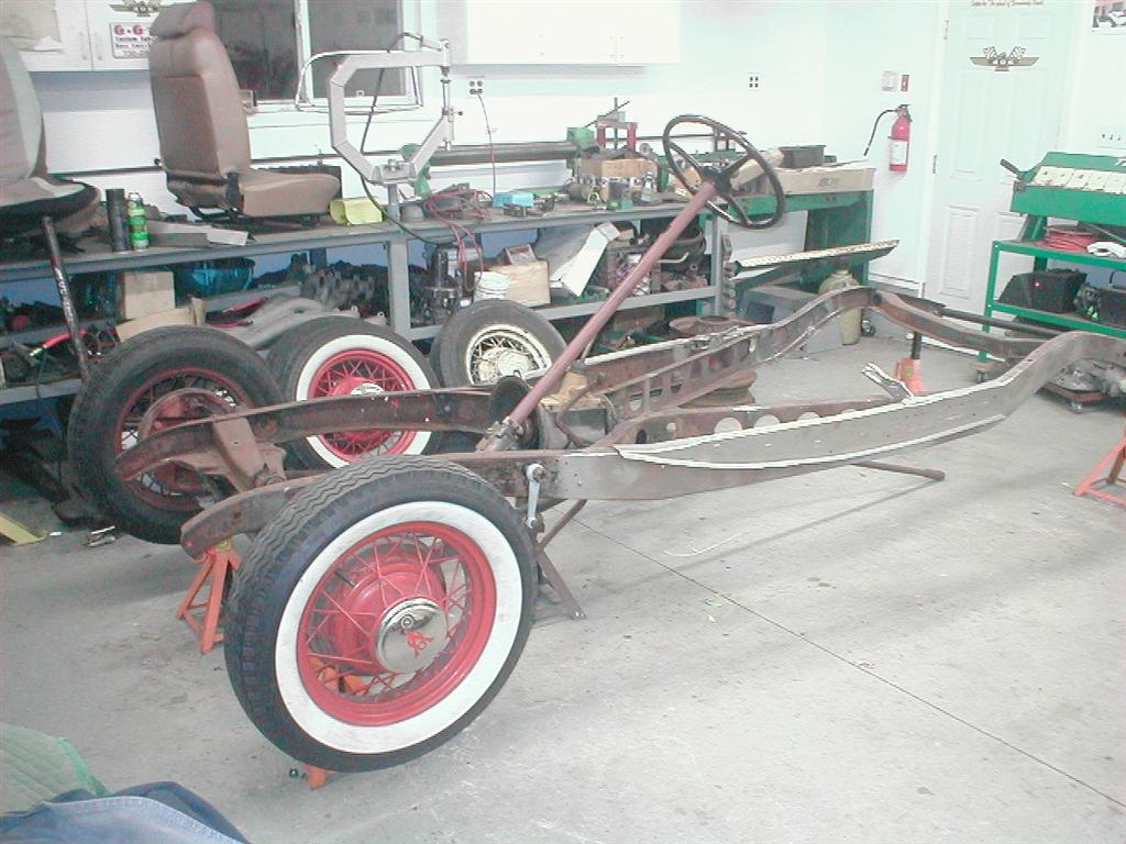

    Been working on the 33 in my spare time..I'm hoping to build a cool,chopped,Flatttie powered 5 window coupe(ala Thunderbirdesq's build)from this pile of rusty Ford tin..It'll be alot of work but I'm really looking forward to it!!.

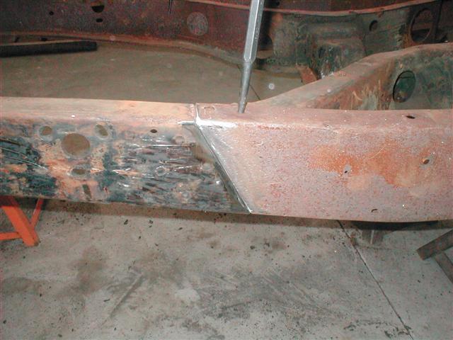

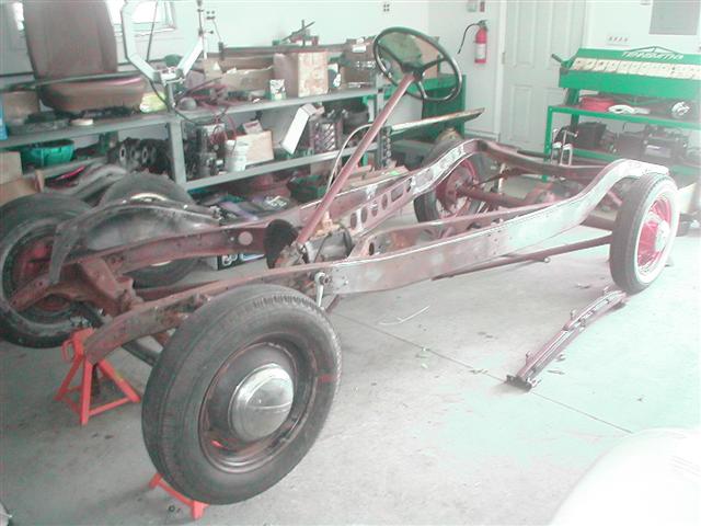

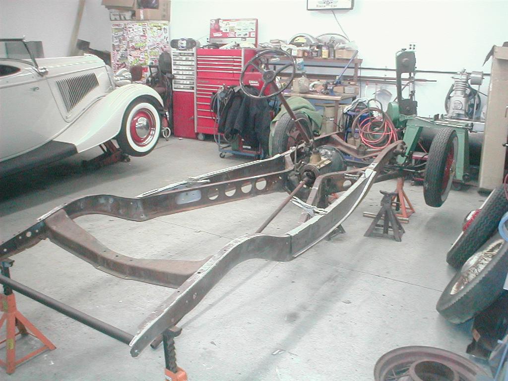

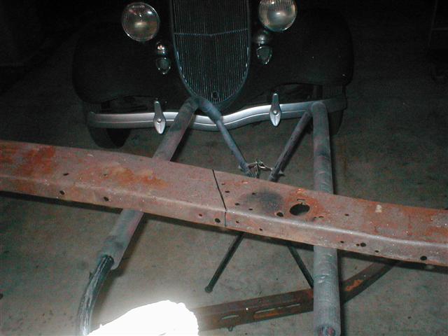

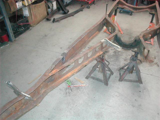

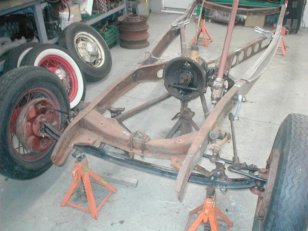

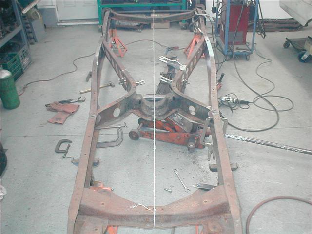

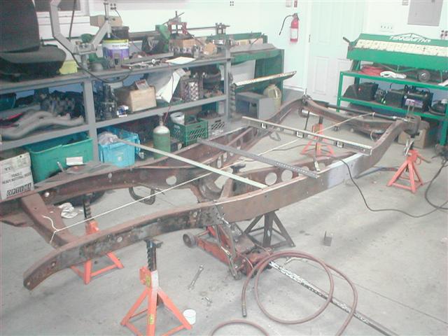

    Getting started I removed the 4 dr. body in sections due to the rusty floors/subrail..The frame was rotted out in the rear kickup area and siderails..A good friend of mine had another 33 frame that was wrecked in the front so I decided to take the best parts of each build a solid frame..I could have found another good frame but decided to try and save as much of the original car as possible..Not having a frame jig here,I built it on the shop floor..Using a Ford frame blueprint,levels and a tape measure I was able to get it pretty straight and true..

    A few mock up shots of the frame..I set the new subrails on the frame to checked the fit on the pieced together frame..

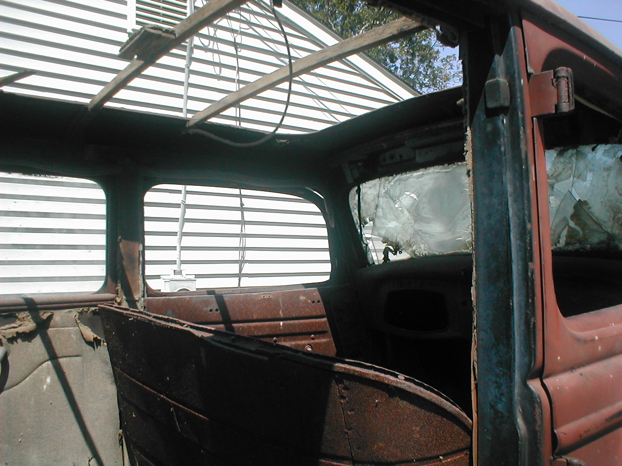

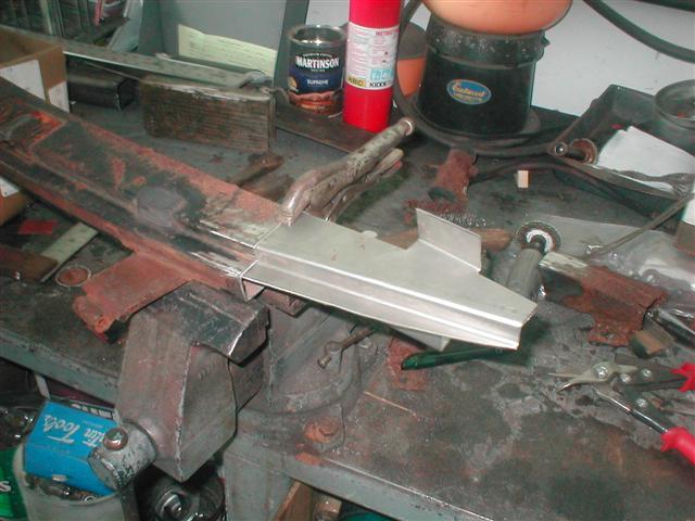

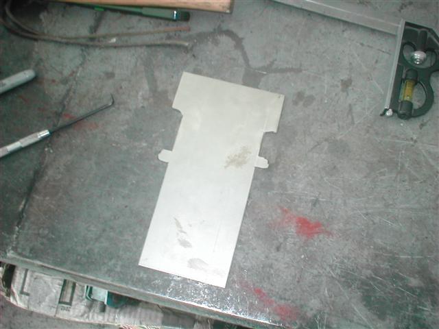

    Started repairing the B pillars and replacing the rotted out Cowl feet..You can see how the body was barely staying together with all the rot..I took a bunch of measurements and made a few templates for the lower B pillars..
