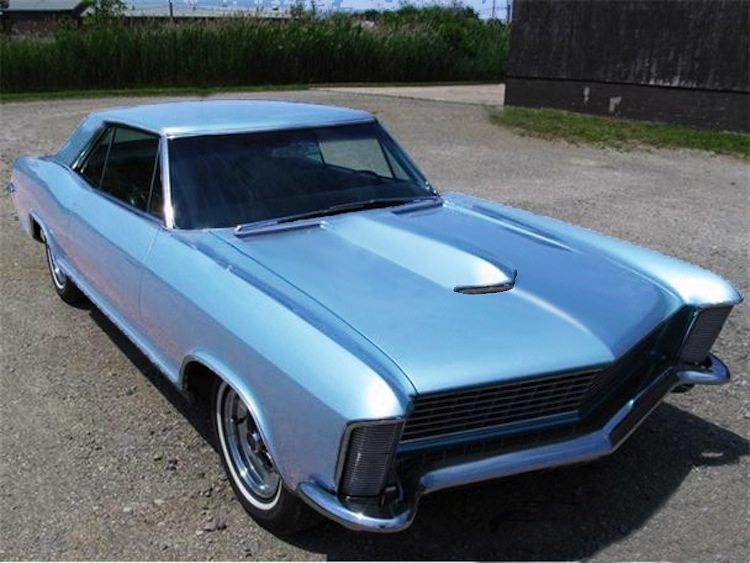

  22. I wonder... would the leading edge (I mean the top..) of another fender work as a hood "blister" or is it not wide enough?

    I like the blister as you've done it. In my minds eye, I saw a cowl inductin style bulge, that added about an inch and half from just ahead of where the stock character line begins in the hood, raising rather quickly to full height (which would be about the same height as the fender crowns), simply raising the stock center of the hood. I lack the photo shop skills to do this, but somebody can (nudge, wink). In fact though, after yesterdays slice and dice session in the shop, the engine is nestled down and inch and a half , back half an inch, which gives enough clearance, with the intakes decorative (funky) plastic cover off. Alternator will JUST clear. Both stock exhaust manifolds clearanced, the left side I had to cut the flange off and rotated it a few degrees, but that let the engine set right down where it should. I won't need a blister at all, only the ones on my fingers...
  28. flynbrian48
    Joined: Mar 10, 2008
    Posts: 8,238
    flynbrian48
    BTW, that's the color I envisioned on it as well. Nice!
