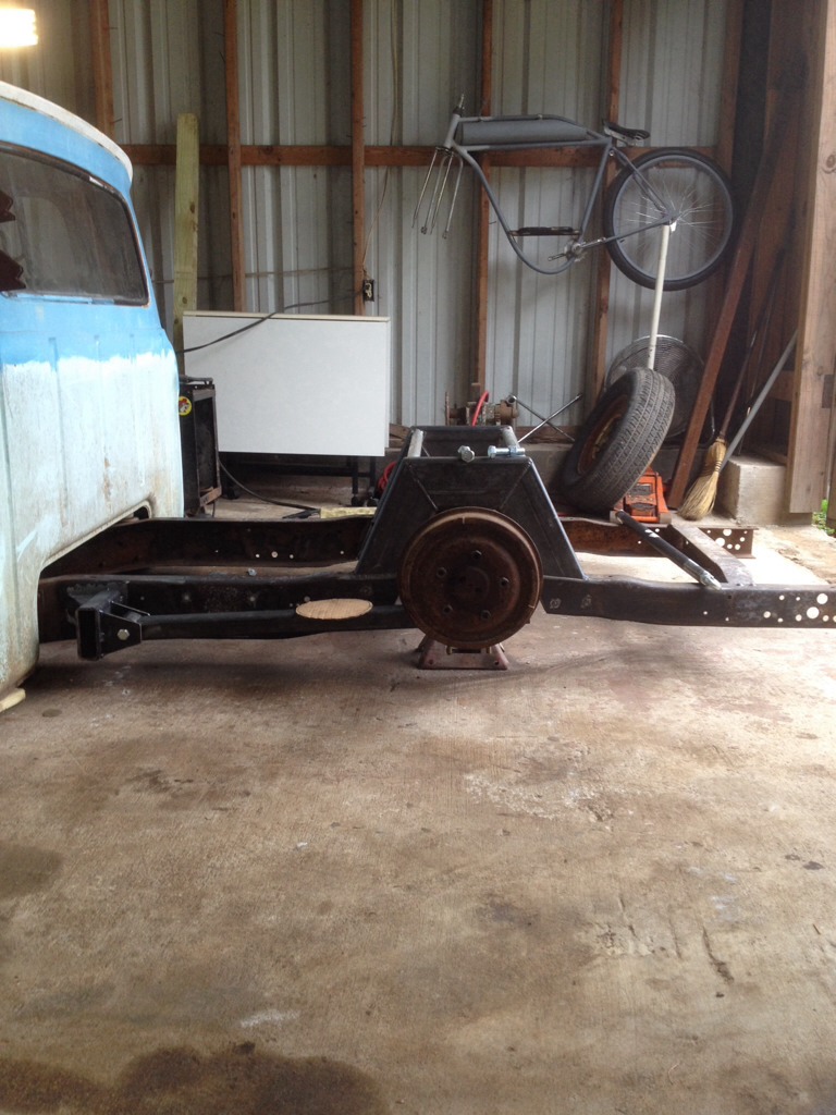

    Made up some step notches for the rear framerails. I used 2x5 1/4 wall
    ImageUploadedByH.A.M.B.1395859240.087727.jpg ImageUploadedByH.A.M.B.1395859266.364129.jpg

    Lower link bars and mounts. 2x2 1/4wall on the lower bars. It's coming along pretty good!

    Well, she's a roller! Got the column back in, wheels and tires on. I set the suspension up to be 3/4" from the ground when fully deflated. After I get back from roundup I'll throw the front sheet metal back on and push her outside for a better pic. Now I just need to find a fleetside bed.
