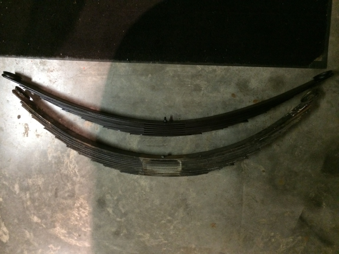

  5. I don't think that will achieve what you're trying to do lowering wise. That's the heavy duty spring that will have a firmer ride and better cornering. The longer bolt deal is about it without getting to some serious rear suspension replacement, ie. straight axle rear.

    here is the spring comparison, should make a difference! i ran out of time today to finish

    success ..... i finally got it back on the ground with the new gymkhana spring(7 stack) and the 1 1/2" lowering bolts, it is now where i wanted it , 3" lower than the day i bought it! now...to find that elusive chrome roll bar.

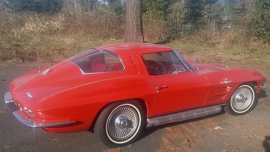

  17. 1963 Corvette split.jpg Belongs to a co-worker. Two owner, original paint, low mileage, 4 speed fueler. His grandpa bought it new. Has some pretty rare 2 bar knockoffs.

    Did that get the 36 gallon tank??
  19. Car looks fantastic! I worry about bumps tho'.. It looks tight around the rear wheel well now. Of course I'm sure you have nicer roads than we do. :D
    I was trying to count leaves and it looks to me like the pack you pulled has eleven? The standard pack should have had nine which may have contributed to the altitude.. Water under the bridge now that you have the heavy-duty set-up in there.
    Enjoy!

  20. Not a tanker.

    That's one GEM of a Vette. My late brother had a riverside red '64.

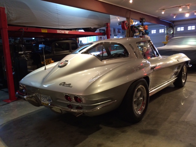

    got it outside finally (too much rain and freezing weather) , no rubbing issues and looks alot better. i am still looking for a roll bar! anyone have one for sale?

  26. Do you know the backspacing to the wheels? What tire size are you running? Love the look and stance

    there is about 1/4" clearance to the rear fenderwells!

    the backspace is 3 3/4" and the tires are 215 70x15
  29. 15x6 or 15x7?
    Just trying to figure out what i need/want for mine.
    Got a nice magnesium 15x6, 2 1/2" backspacing torque thrust that i want to mock up and see how it fits...but gotta wait for the snow to melt to get the car home to check, damn winter is killing me!

    15x7 d spokes
    that magnesium 15x6 might have clearance issues.....careful with your tire size. i have a pair if you need two more.
